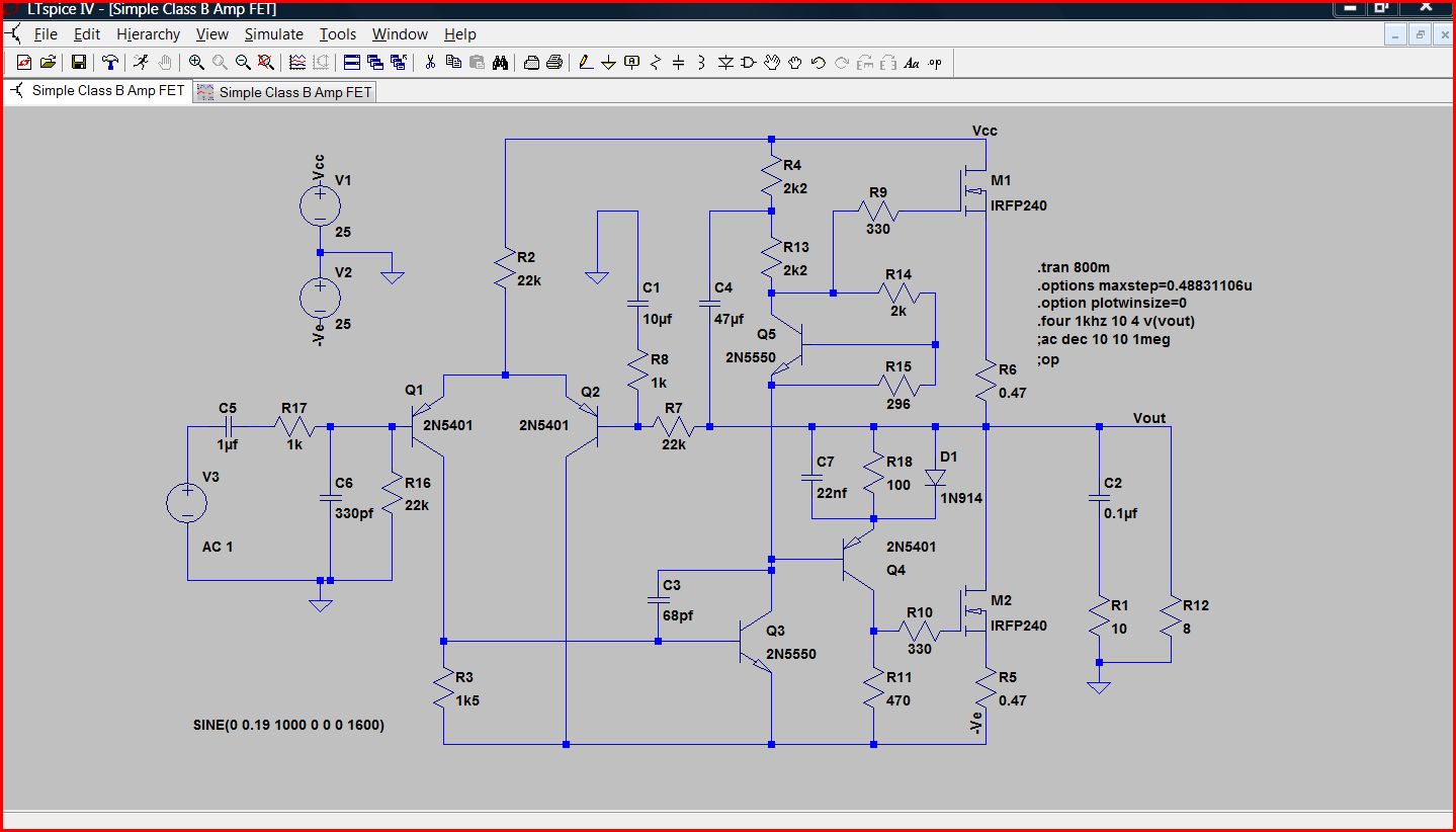

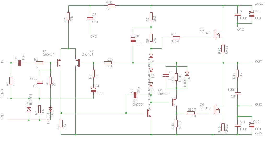

I have just looked over your quasi circuit. I would foster your thoughts on this. Quasis are asymmetrical output stages, with two n devices in totem across the rails and they create a lot of H2 and H4. A lot of people actually love quasis.......
You have the emitter of Q4 on the output rail. You might put a 4004, a 22nF filmcap and a 100R resistor, all in parallel with each other, in between Q4 emitter and the output rail. This makes it very easy to set the bias current in the output stage and softens the switching transistors between the output devices under load.

Thanks for dropping in Hugh. I've seen this resistor in this configuration in Quasi's NMOS project and wondered about its function; however, his design doesn't have the diode or bypass cap.
I'll include these in the redraw I'm about to post shortly.

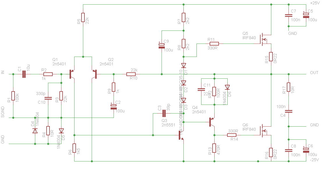

Latest redraw incorporating Mooly's revised R values for the tail resistor and feedback network, tail resistor and output gate stoppers, as well as Hugh's suggested changes.
I've also tidied up the front end, band-passing the signal (added 330p ceramic), adding a 100k resistor to prevent any big bang in the speaker if the input is accidentally connected while powered on, and adding inverse parallel diodes around the ground lift to pass fault current.

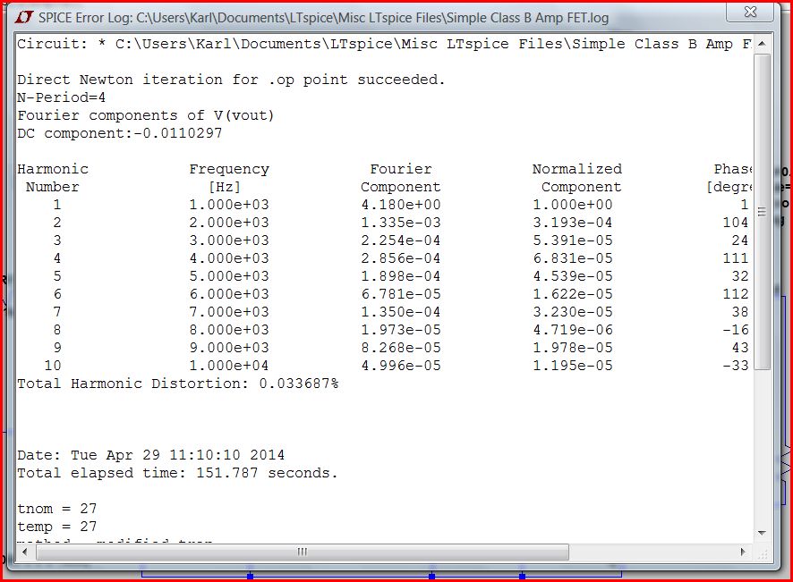

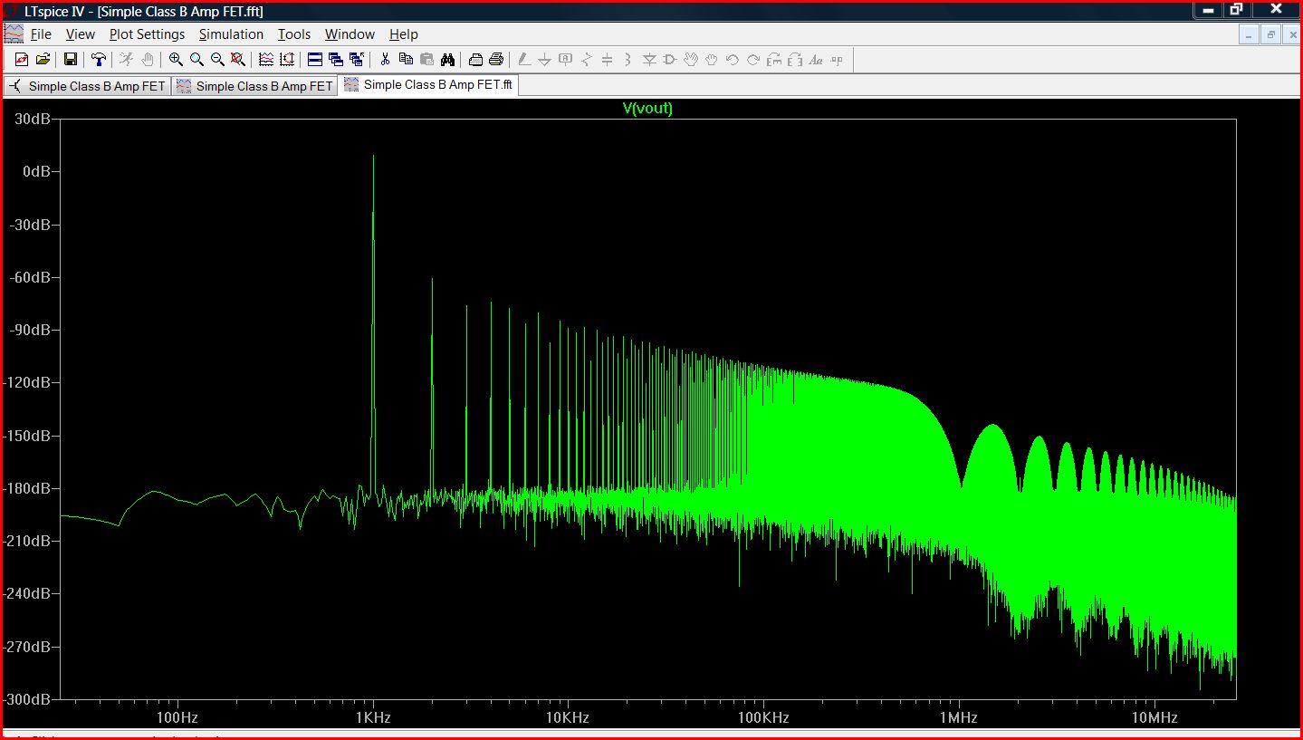

The Baxandall diode is more applicable to bjt output stages where there is significant driver current flow. I put the latest version into simulation, I'll post the result in a minute.
That filter won't materially affect the simulation because the rails are "perfect". Adding the filter will make the 22k appear as a 23k DC wise but still as a 22k for AC signals.
Mooly, I've never used Spice, so I don't know how to interpret the result. Is it good or bad?
Erm 😀 I would say however it appears and whatever anyone says... its no real guide to how it will sound 🙂
The result shows a spray of harmonics, but the 2nd harmonic at 2kHz is dominant, and many believe that contributes to a musical sounding amp. It could well sound very good indeed.

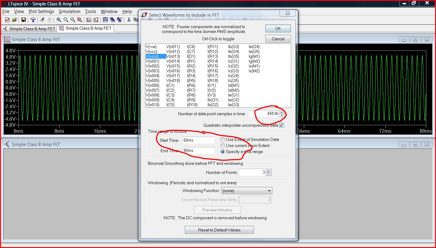

If you want to install Spice and run the file I'll give you some pointers on how to do that... and then you can experiment with it.
No pressure 😀

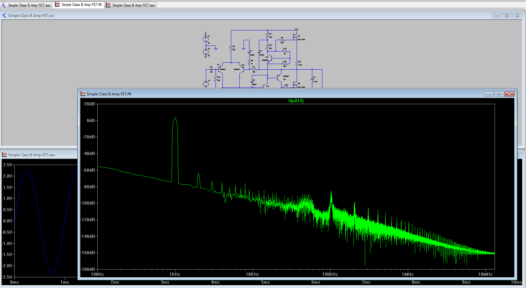

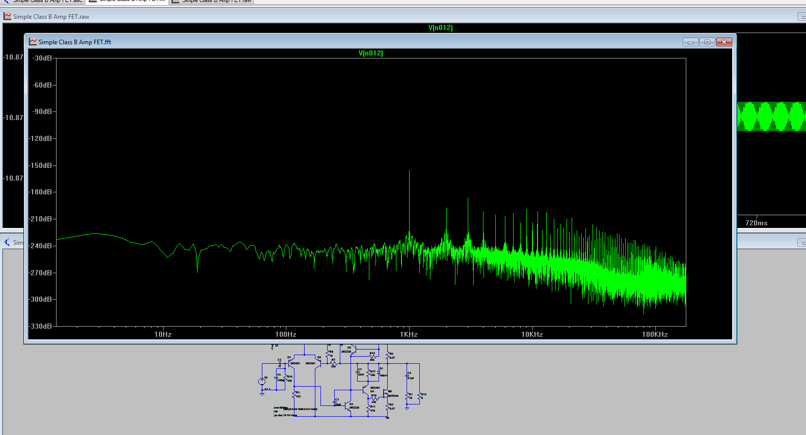

That's it. The slope on the FFT is caused by the larger caps, so to eliminate that effect you can make those caps absolutely massive such as 800,000uf each. Thats the input cap, the bootstrap and feedback caps. Also run the sim for longer such as 800ms rather than say 8ms. When you run the FFT choose to do the sample on the last part of the run like this.
Your welcome, and I'm certainly no expert on simulation, but I've picked a bit up over the last couple of years and figured some stuff out. Still a lot to learn though.

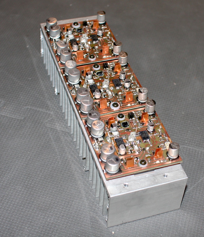

I will likely follow in Gareth's footsteps and lay this out using a combination of SMT and TH devices.

However, I used them on a pcb I made in the kitchen sink and it was quite a challenge to solder them without a proper silk screen etc. In the end I got somebody more expert than I to solder these tiny parts for me. I decided that I'd never be able to repair the boards if one of these tiny devices was damaged. So I decided never to use them again.
I had the same good advice from Hugh and he's right. It's best not to use them.
