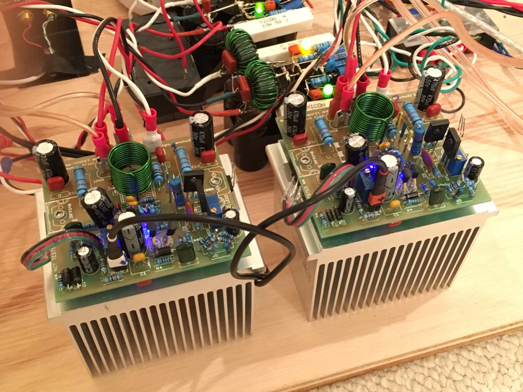

Referring to Hugh's recommendation to change R6 from 10K/1W to a 15K/1W resistor. I have available some 15K/0.5W metal film resistors or some 22K/1W CMF type resistors. Are either of these workable in the R6 position and is one better than the other?

Installed R6 15k ohm and changed the trimmer pot to 500R. The best I could do is around 225mV for the offset. Offset was jumping around like an Aussie jack rabbit ;). Trimmer did not really do much.
I am not happy with the flying leads and the way I have soldered up the boards with some components, so I am going to take a break, enjoy my holiday in Mexico, and then come back and rebuild ( ie: simplify ) portions of the board.
This amp is too good to walk away from, so thanks for all the help, and I will get back at the project in May 2023. Have a great new year and best wishes to all.

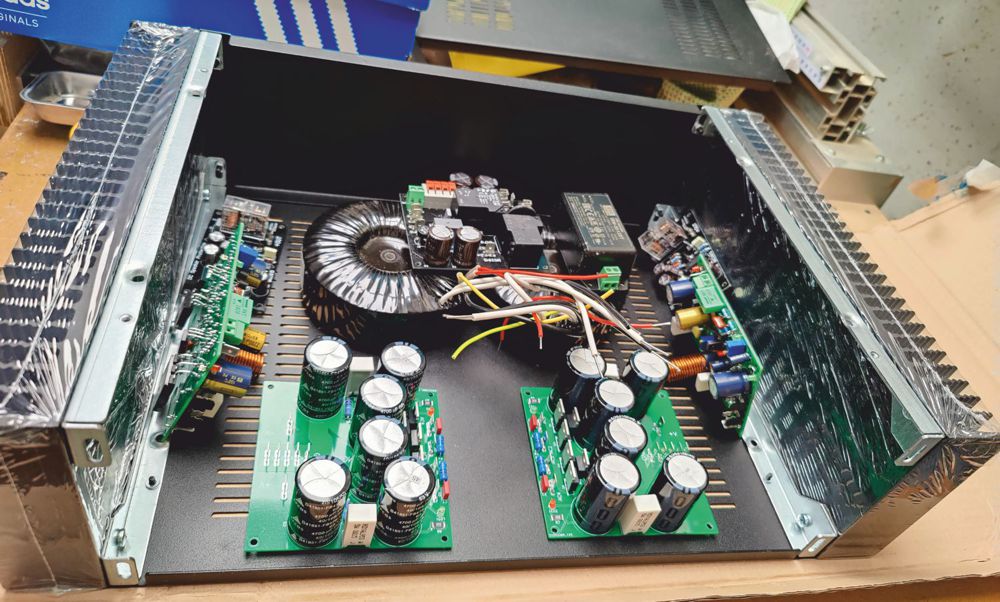

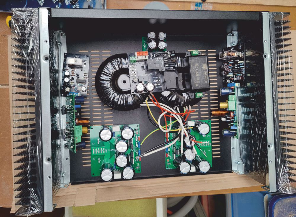

du lack of time i am changing one more time my plans. I give up with the full DIY mono chassis. Instead of i order a HIFI2000 3U Dissipant case. They have 2 300x120x40mm heatsink with 10mm base. I havec order the 4mm front plate. I will made a custom DIY Front (veneered plywood). I don't change the dual mono configuration. I will just apply layout and wiring skills from Bonsai.
Need yet some drilling and tapping ....
I read whole tread and came on a mistake on my board : in feedback circuit i have 1k8/68 resistors that give me 27db gain .... i will change the 68r with a 82r.
