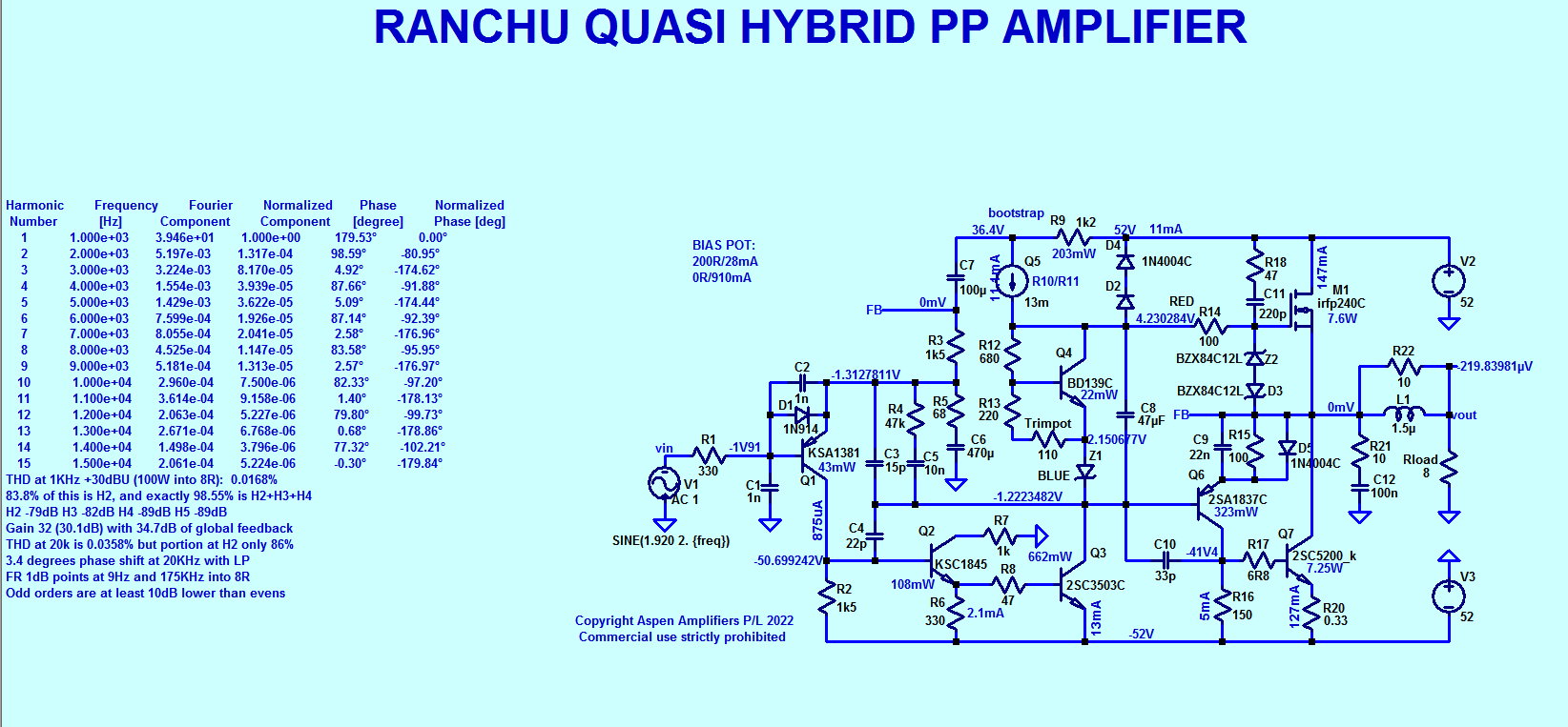

Your requested Lazarus returns!` It will do 100W into 8R and almost double into 4R, but watch out, the weak link is the C5200 quasi and should be doubled for a four ohm load, and a FQA40N25 higher rated nmos for M1 for lower impedance loads.

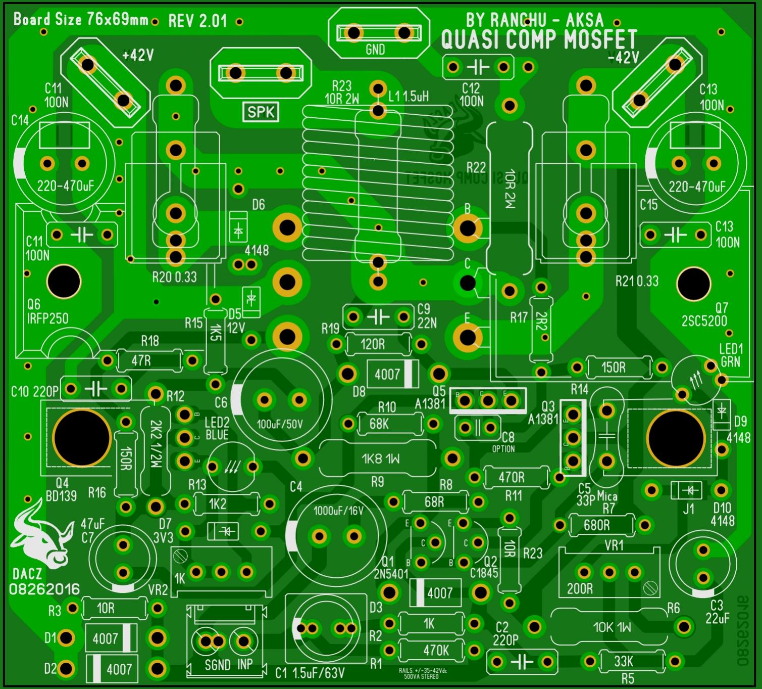

Very kind @zman01 , but probably not cost effective for you to post to me. What layout did you use?
motokok,
IIRC the build that I did used the Dacz layout.
It is quite cheap to get some PCBs made and shipped using the gerbers posted in the thread.
Usually postage is the part that costs the most, but can be very cheap if you are prepared to wait for slow-mail.
There are a few PCB versions to choose from:
Post 2157
Post 2154

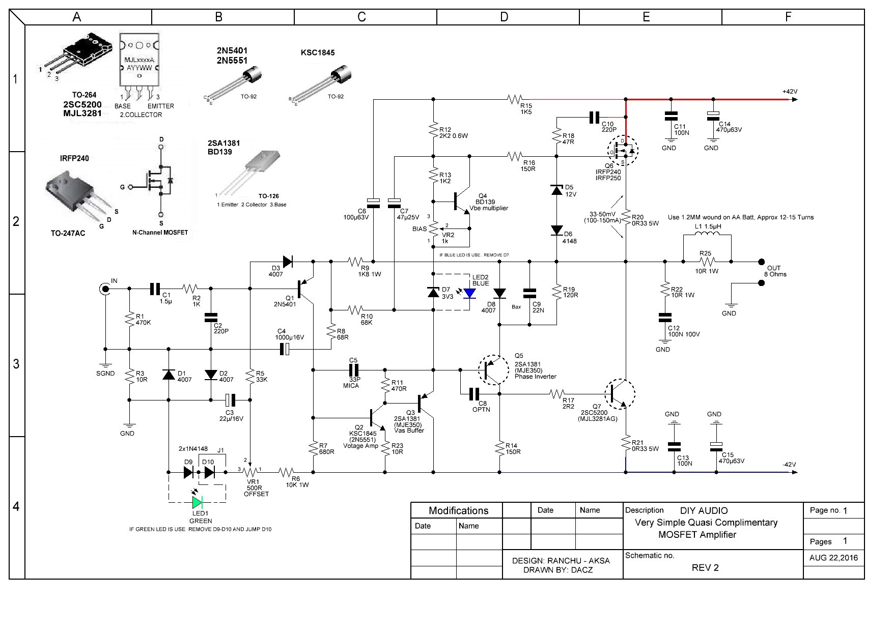

Hi
I want to build this amp in the near future...
i did ordered the Dacz VSQA pcb. it should be this documents, right?
are here changes to do?
Q1 without reading 139 pages, is there a final BOM?
Q2 N ch Mosfet FQA044N10-133 okay i guess? BJT will be a 2CS5200 Toshiba
Q3 Which green LED are preferred?
thanks in advance
kr
chris

Good to see the interest around this amp.
chermann,
Here is what I found from my notes from a few years back - the numbers at the end of the each line is the part # from Element14 (Farnell in UK and Newark in the USA) - you will need to check and see if this component list is ok, as I don't remember if I went with this list or made changes to it when ordering:
(the quantities are for a single channel - for a stereo build you will need to order 2x)

Q1: 1 x 2N5401: 1862542
Q2: 1 x KSC1845: 2453946
Q3, Q5: 2 x KSA1381ESTU: 2453937
Q4: 1 x BD139: 1015770
Q6: 1 x IRFP250: 8649278
Q7: 1 x 2SC5200 / NJW0281G: 2101384
LED: 1 x Blue LED, KINGBRIGHT L-964QBDL-D: 2373467
LED: 1 x Green LED, KINGBRIGHT: 2335730
VR1: 1 x Trim pot 200 Ohm: 9608575
VR2: 1 x Trim pot 1K Ohm: 1141401

If you read/search through the thread, you will find answers to all (or most at least) questions regarding components etc...
A few years back, I build a few examples, and tested and compared with different mosfet and BJT outputs. It didn't actually make a big difference as I recall, at least not regarding THD and harmonic profile. The results are somewhere in here
