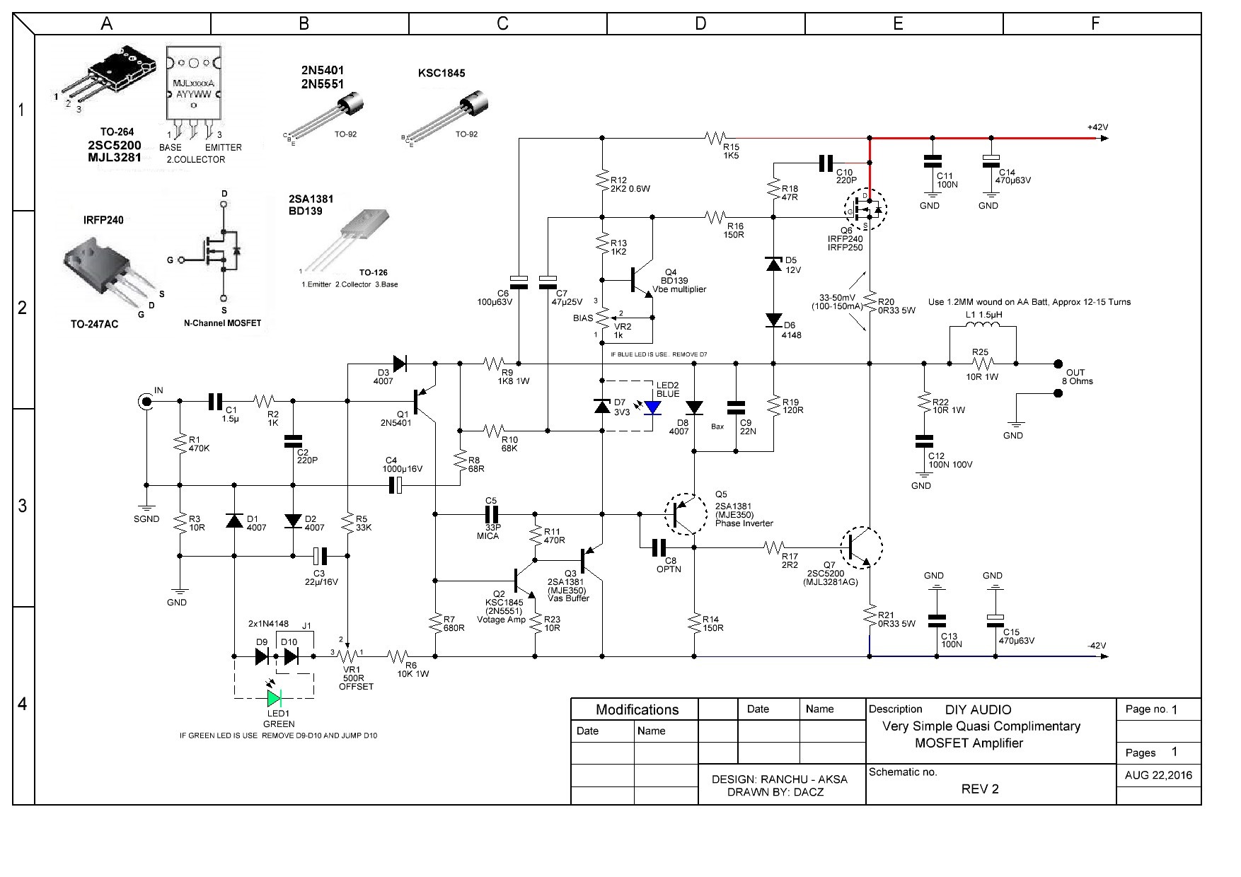

1. Hugh, according to the Dacz schematic that is posted in #2663. It quotes: " If green led is used, remove D9-D10 and jump D10".
2. Hugh, you are recommending using a blue led in place of one of the diodes D9 or D10.
Which of the above is better option as I have used a 200R pot as VR1 referenced on pcb, and, not the 500R pot that is referenced on the schematic.
I assume that we are trying to lower the voltage dropped by combinations of leds and diodes. Is my thinking correct, maybe I have it backwards ?

Hi Myles, Thimios,
We can use Myles' schematic from DACZ posted in 2016, but referred on page 133 of this thread.
We focus on D9 and D10, the two IN4148 diodes which comprise part of the voltage reference for the offset system.
If you have +2V offset at the output, then we need to add 2V NEGATIVE to the bias resistor, R5.
D9 and D10 pass about 4mA, and drop around 1.4V. We need to increase this drop to 1.4+2=3.4V.
Easiest way to do this is remove BOTH the diodes, which drop 1.4V, and replace with an LED which drops close to 3.4V.
The optimal LED is a blue, as they drop about 3.3V, close enough for government work here!
OR, you could drop ONE of the diodes, and replace with a green LED which drops 1.95V, so this will add 1.25V, not quite enough.
We have to get to 3.4V, and the best is a blue LED.
R5 is the bias resistor of the base of T1, and if you change it you change the input impedance of the amp which could be problematic for the source. Best to leave it at 33k, which sets the Zin of around 25k, easy to drive.
Hugh

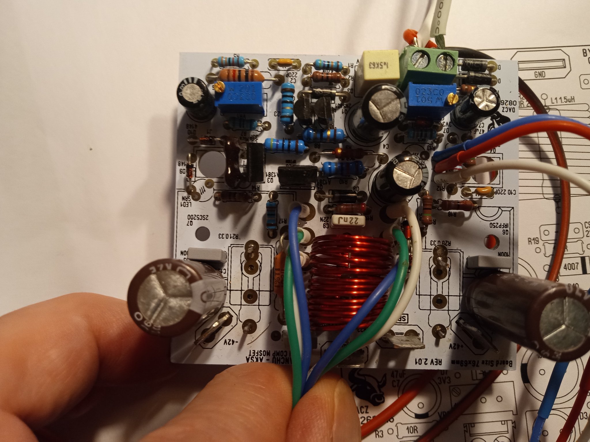

OK, I desoldered D9 and D10. I soldered in the blue led. I checked the blue led in the circuit with DMM and it lights up. Applied the power thru variac and DBTester with no sparks or fire. All transistors are warm and heatsink is warm.
One problem: blue led does not light up. Do I need to insert a jumper at D10 as per the Dacz schematic?.

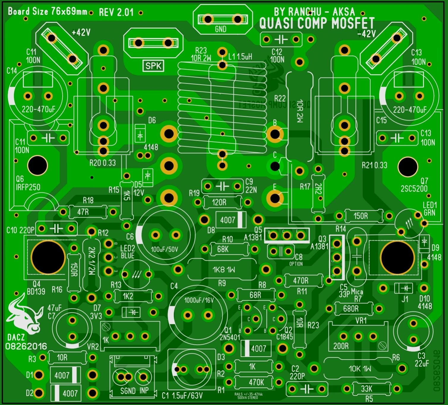

Yes, Myles, if you can't straddle the blue LED from anode D9 to cathode D10, jumper D10 so you only use only D9 spot to insert the LED.

Thanks Hugh, I inserted the blue led where it was shown on the pcb (actual spot for green led) and removed both D9 and D10. I will insert a jumper wire for D10. Will report back and will also check C3.
So, I straddled the led from anode D9 to cathode D10, cleaned up the pcb and powered up. The led lit up and the DC was all mV. I could only adjust to an average value of 150mV +/- 15 mV with the 200R trimmer. Not sure why the offset voltage is jumping around so much?
Also, I checked C3, it is 22uF and is installed correctly.
Do I need a different trimmer? or, is there more tricks to try. Help is always appreciated
Hi Myles
I would replace R6 10k for a 15k
Then replace the trimmer with 500R version.
I was not aware you using a 200R trim pot.
This will reduce LED current from 4ma to 2.7ma and reduce its drop from 3.3V to 3.1V.
This should fix the offset issue.
Hugh
