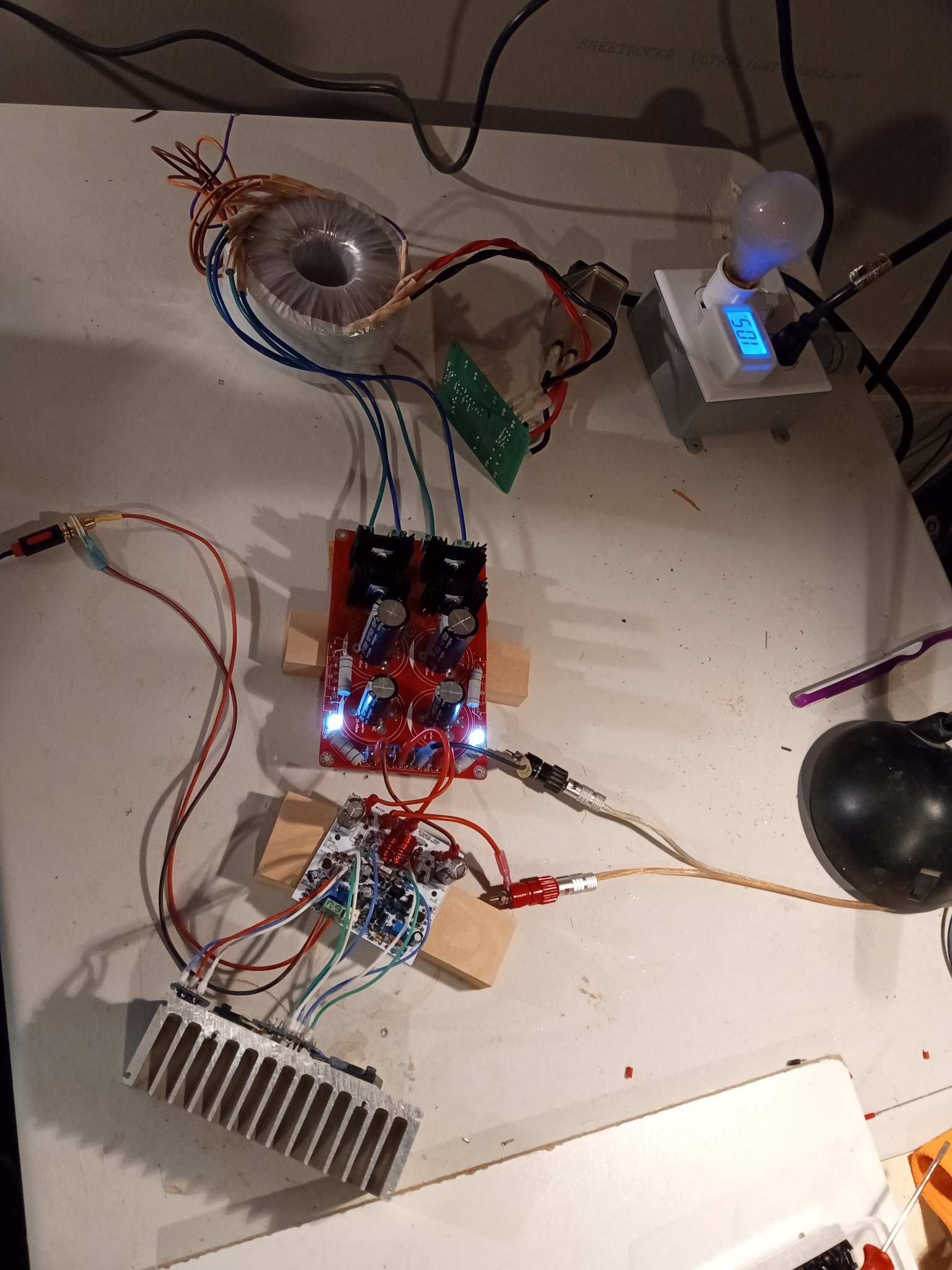

My VSQA amp lives. I have finished my proof of concept, and applied power to one channel from mains>>variac>>dim buld tester>>IEC inlet>>soft start>>transformer>>CRC psu>>amp. No smoke and no noise. I have only listened for a short time with computer / amazon music playing, but what I heard was very pleasing. I will wait until I have the other channel built, and then will bias them both, and think about a nice chassis for this amp. I am happy and fulfilled.
Thank you Hugh, Christian, DacZ, and all whom I have received guidance from. Once I finish the second channel, I am moving on to some pre amp construction and I would like to start xrk971's floor standing TL - 10F/R225 project. This will be slow work as we have our winter vacation in Mexico. So much, so little time :cheers: Here is a pic
