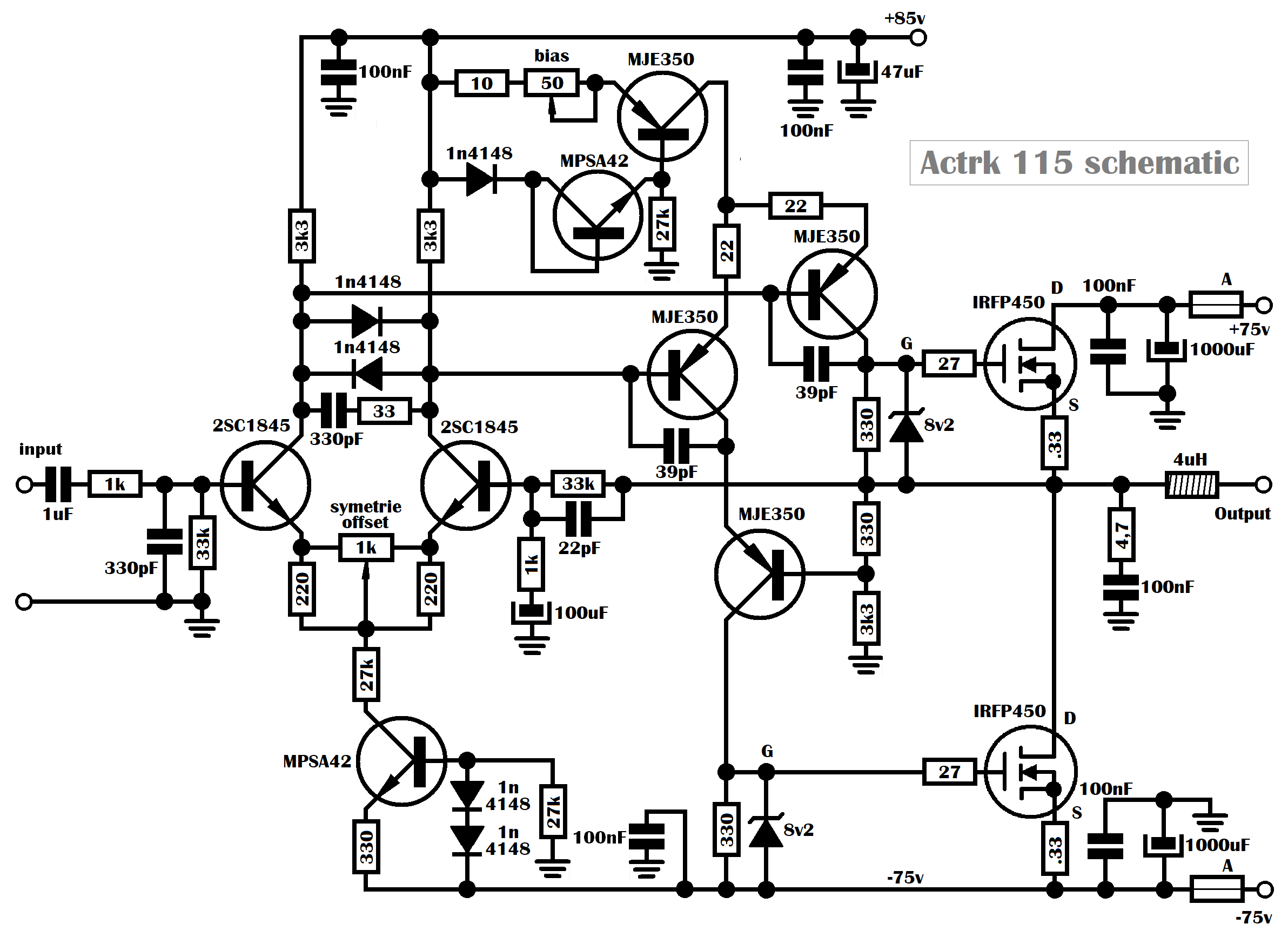

Hi, how about this ACRTK MK2
Revised Update 2018 ACRTK MK2
Differential Input NE5532
Replace discrete Front End with High Speed LM318 op IC
Crowbar DC protection
Over current Detection

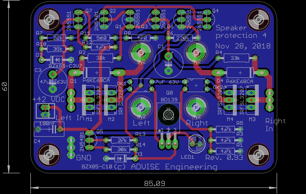

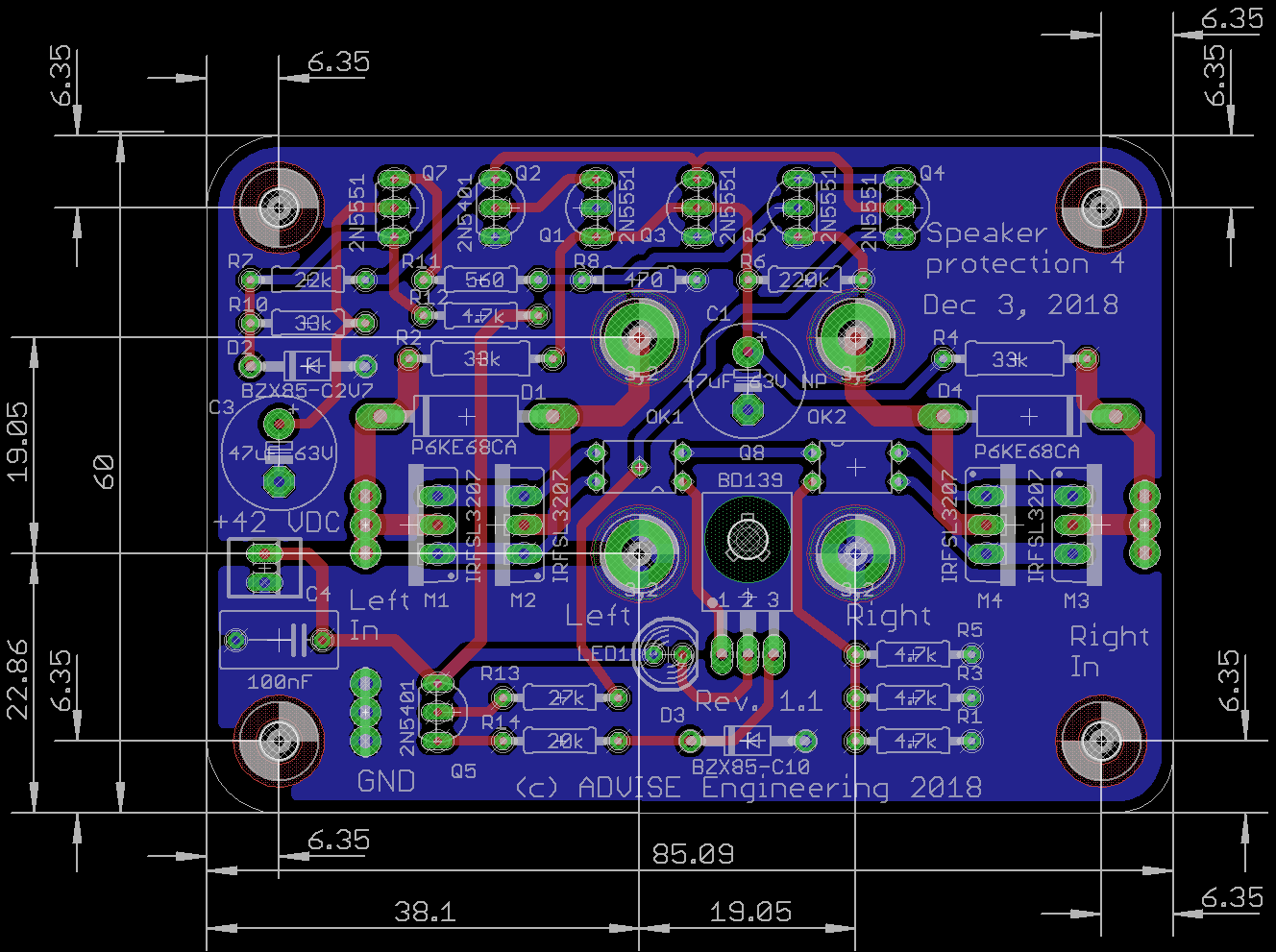

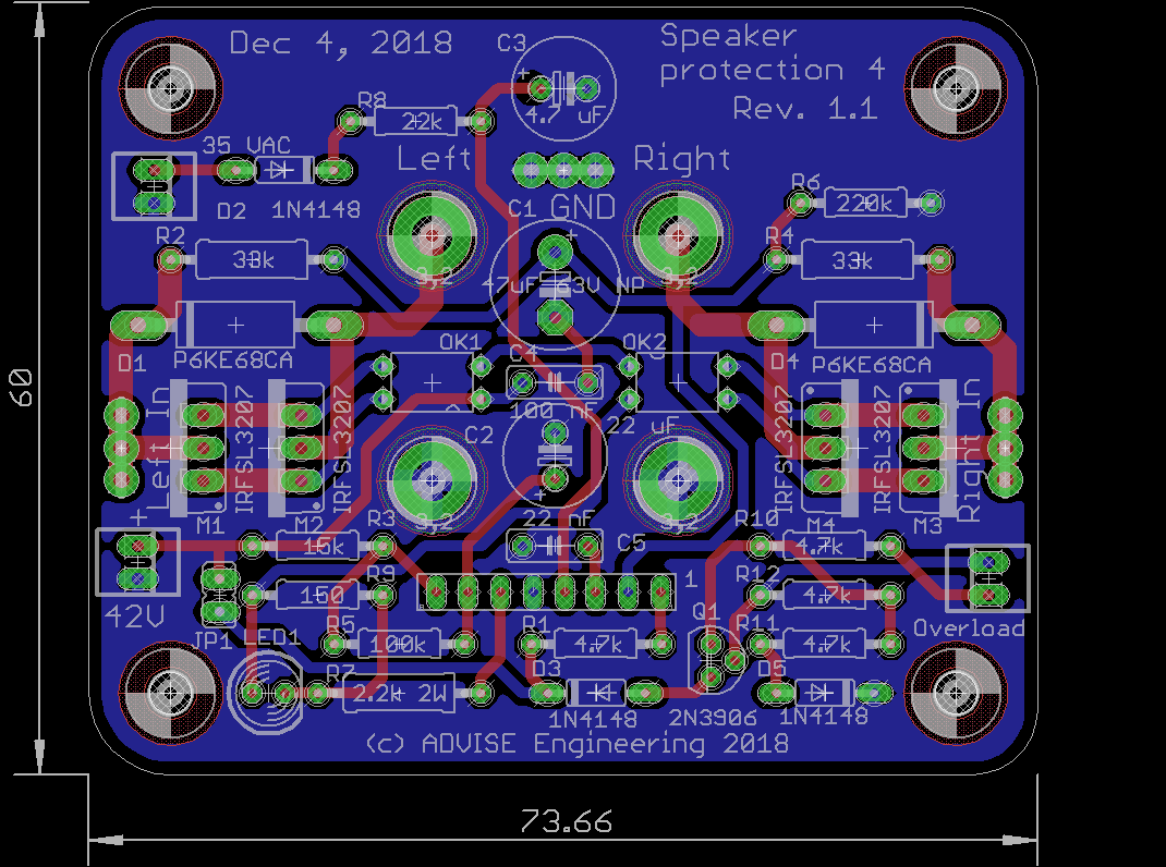

That is the final version of the DC protection module PCB designed with Project16 schema and optimized with his recommendations Cheers
Marc
Dear bandol83,
Kindly post the schematic along side the PCB. Then it will be more useful !
--gannaji
Cheers
Marc
Hi Marc, thank you for your work . Waiting for your review.
Boyet
Hi gannaj,
I didn't post the schematic for this design because it is not mine
Sorry,
Marc
If the design is posted on diyaudio, then you can definitely repost it. Else please give reference.

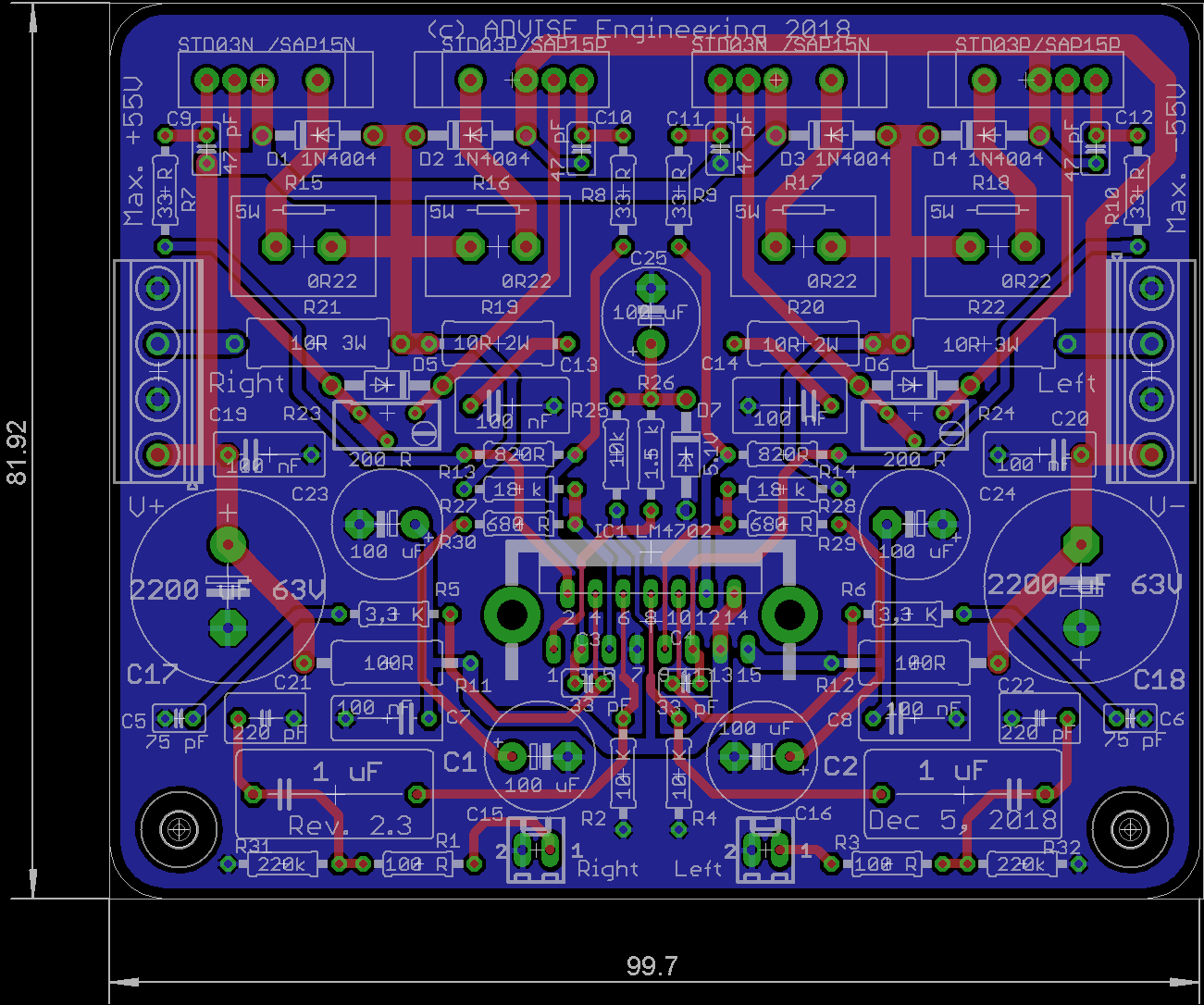

Hello,
I am impatient to finish my Quasi MOSFET amplifier therefor after having made some minor cosmetic modifications, I will send today the Gerber files to the PCB manufacturer
Since I have also some UPC1237 in stock and since the price of the PCB is less than the cost of the shipment, I have also made a small PCB to use these devices
Having few LM4702 and Sanken Darlington I have also designed an other PCB to use them...

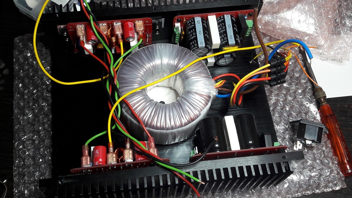

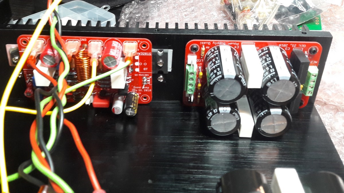

Thank you Hugh,
In fact this is the nice work of my friend Philippe that is living not too far from Bandol and who is good for mechanic and wiring while I am more involved on the design and build of the PCB, therefor this is a good combination
I have added some new pictures, now only the DC Speaker protection module and the volume knob are missing
And by the way, I have made a stupid mistake on the previous DC Speaker protection PCB, hopefully I could stop the production at PCBWay when Project16 told me that I have used a wrong library for the optocoupleur
I have enclosed the correct version which has been produced in the meantime and is now on the way to France, I hope to have finished the Quasi before Christmas
This will be a very compact amplifier, the chassis is nice but very small !

Hello Hugh,
After checking the speaker output to be sure that there was no significant DC voltage, I connected the speaker without the protection module (until I receive and build the module) to test the amplifier in the box...
Inside it is very full and the toroidal transformer is very close to all PCB, only few mm between them, but that doesn't seem to create problem. There is a very small noise from the transformer, probably a vibration noise but that should be disappear when I will close the box ?
I have a bigger problem with the volume control pot, when it is at the minimum or at the maximum there is absolutely no noise or hum, but when I increase the volume there is a significant hum which will disappear only when I reach the maximum
Have you an idea about the cause of this problem ? Tomorrow I will try with an external preamplifier and the volume of the Quasi at the maximum to see if the noise is still there or not...
