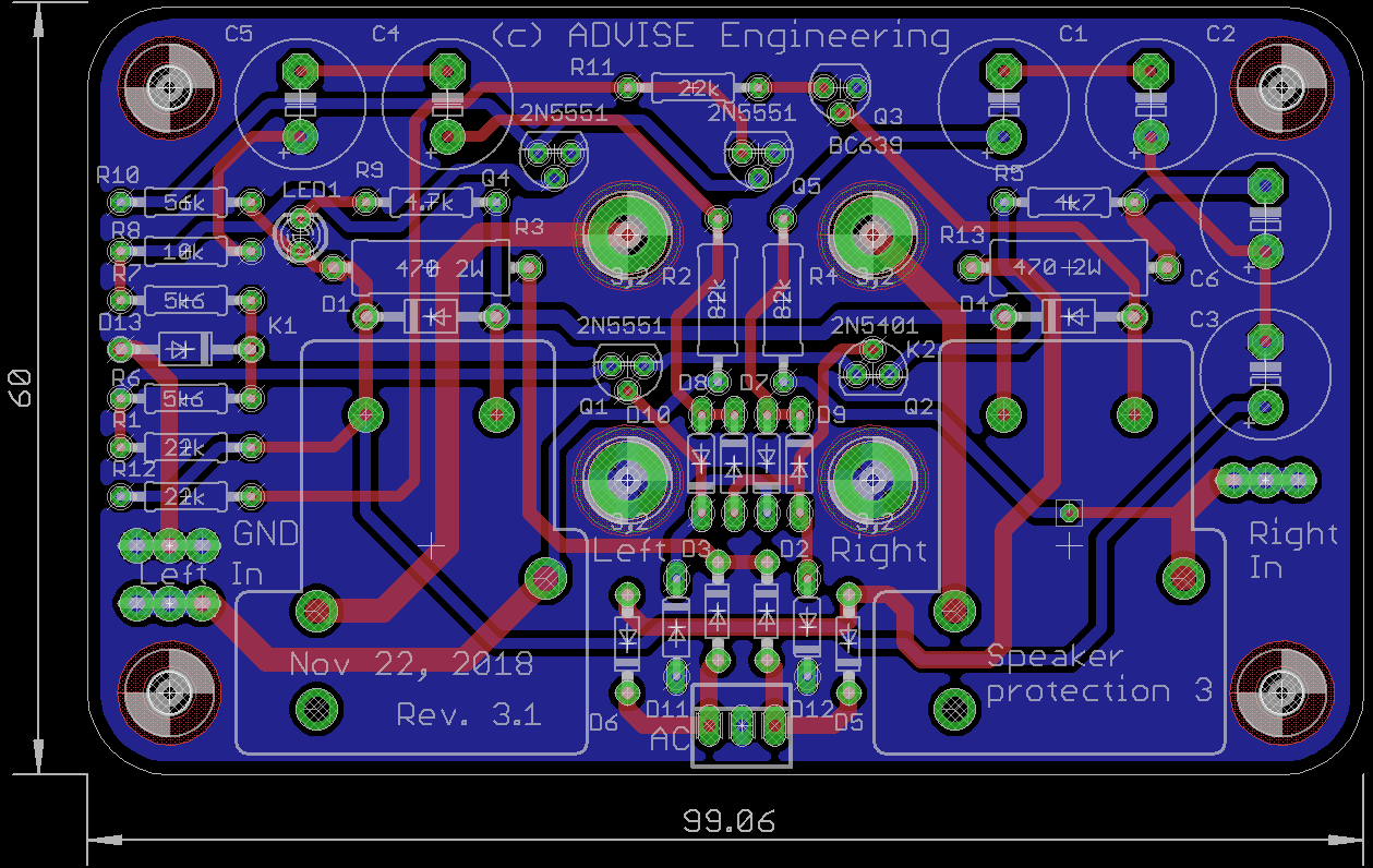

Hi Project16,
Is your project similar to the one of J. Hofland published on post 333 here : Speaker Turn On Delay and DC Protector Board Set (V3) ?
I see that he is using op amp instead of transistors, I think he cannot use high voltage and that is the reason for 5 V regulators. I would prefer to use the amplifier power lines +/- 40 to 50 V DC for the protection circuit with 2N5551 and 2N5401 transistors...
Why you didn't use SMD MOSFET since you already use SMD TLP3906 !
Cheers, :cheers:
Marc

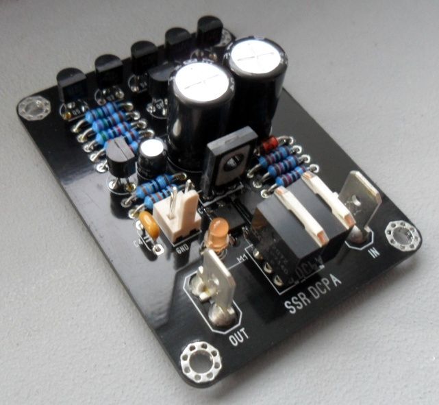

Hello Marc
I did not use SMD components because I took over the drawing of my first version which was relay but a SMD version is quite possible and I confirm that it uses the power supply lines of the amplifier, for the TLP3906 only from the SMD and some possible in DIP version too expensive.
The diagram of the post 333 is interesting but in my humble opinion with a voltage and intensity as low on the optocoupler mosfets can not drive in an optimal way, more references chosen are not the best on their RDSON.

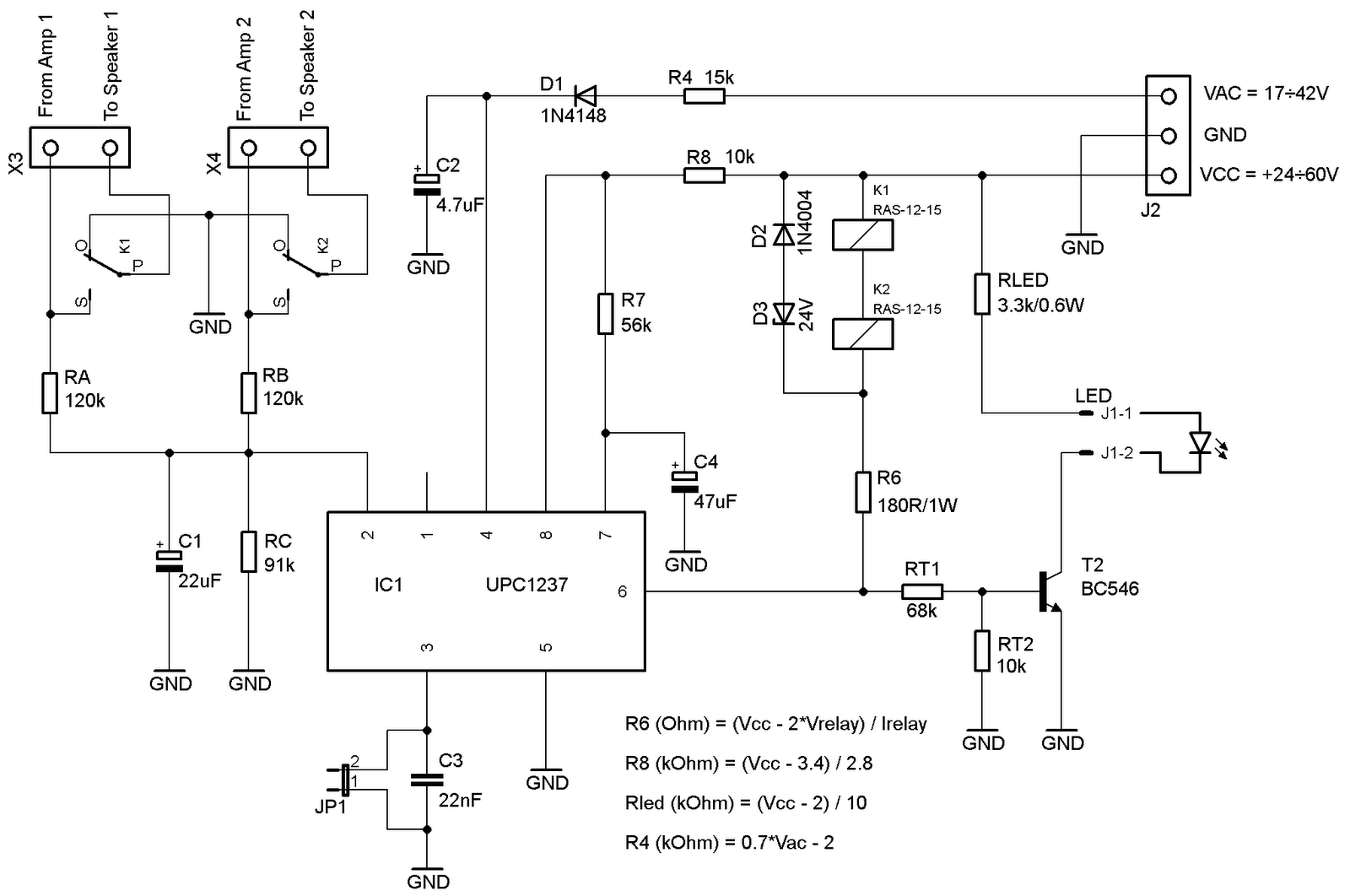

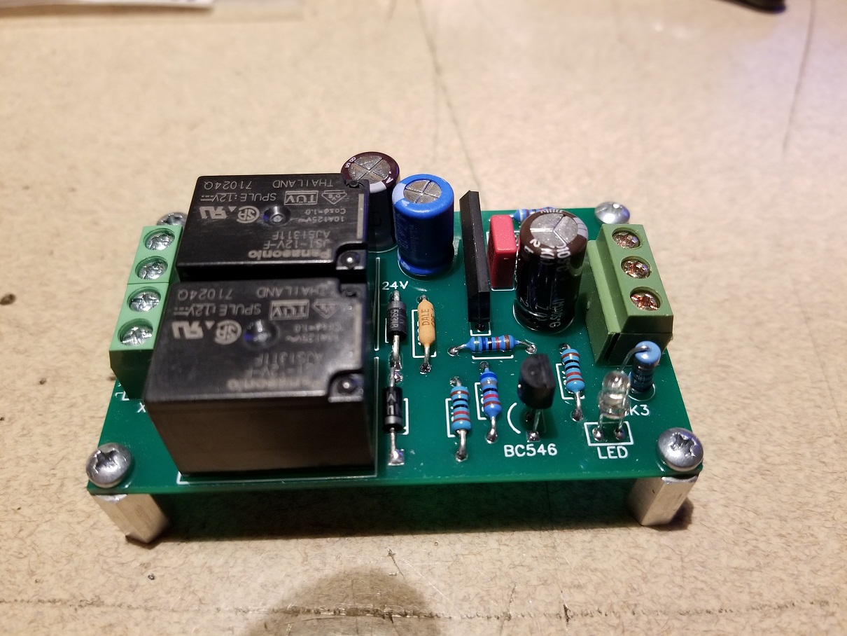

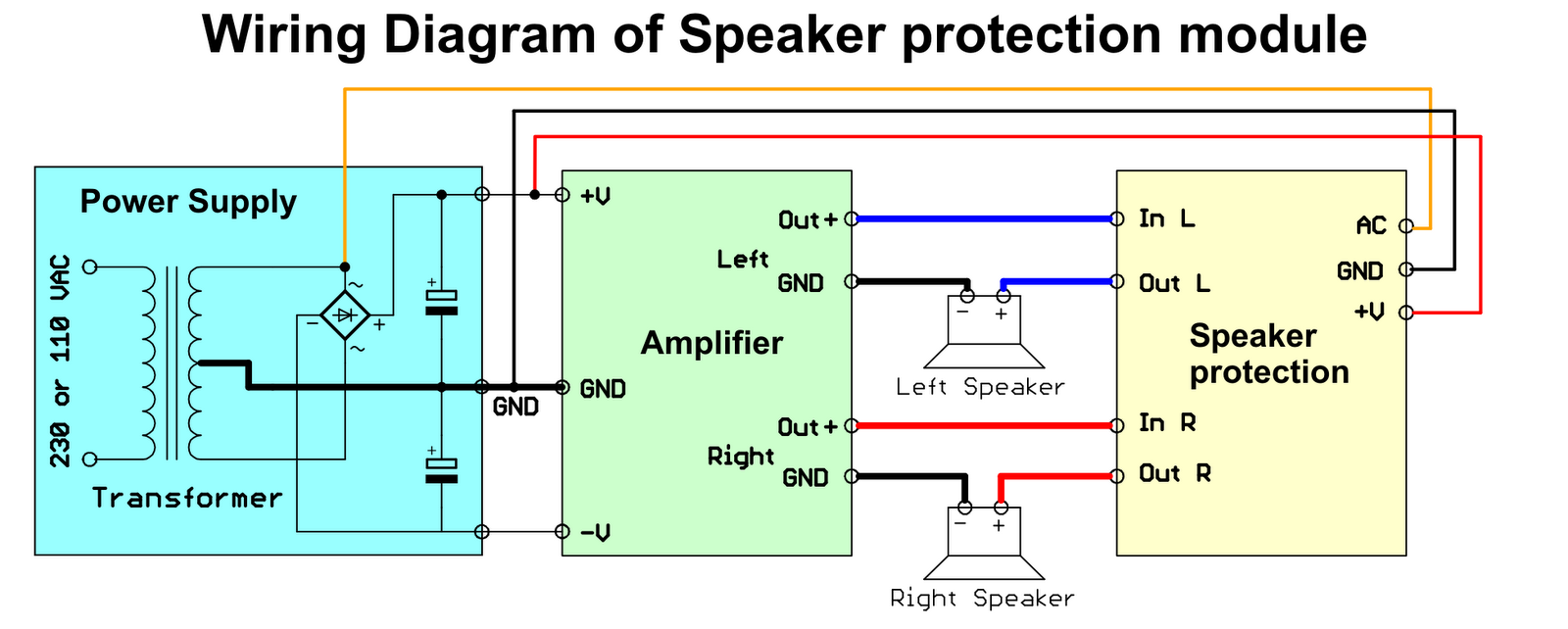

Just to throw this out there, I use a protection board I found at DiyFan.com. It's based around the uPC1237 IC. It seems to work pretty well. Attached are the schematic and hook-up files and a picture of the one I just built. I have a few extra boards if you want one. Let me know.
P.S. Moderators, I posted this in another thread by mistake. Hope that's ok. If not, the other post can be deleted.

Hi Ripcord,
Thank you for your feedback and your nice offer :)
I have also tested several UPC1237 protection modules, but the results were not very consistant ! I have just bought another one because it is using bigger relay : Assembled Speaker Protection Board 30A for Audio Amplifier Amp Omron Relay Delay | eBay
Most of these DC protections use a 10 A relay which is enough for up to 50 W amplifiers, but a 30 A relay is more secure for 100 W and more amplifiers because relays are specified for AC control, however DC switching is more critical since there is no return to 0 Volt and there could be some arcing between the contacts :mad:
May be the best solution is to use MOSFET like the design of 21st century protection ( How to build a 21st century protection board ) or LKA SSR Amplifier Protection, post 639 here : Output Relays and post 23 here : SSR for speaker protection?
Project16 also made a Solid State Relay protection and give me some useful informations to design my protection module :)

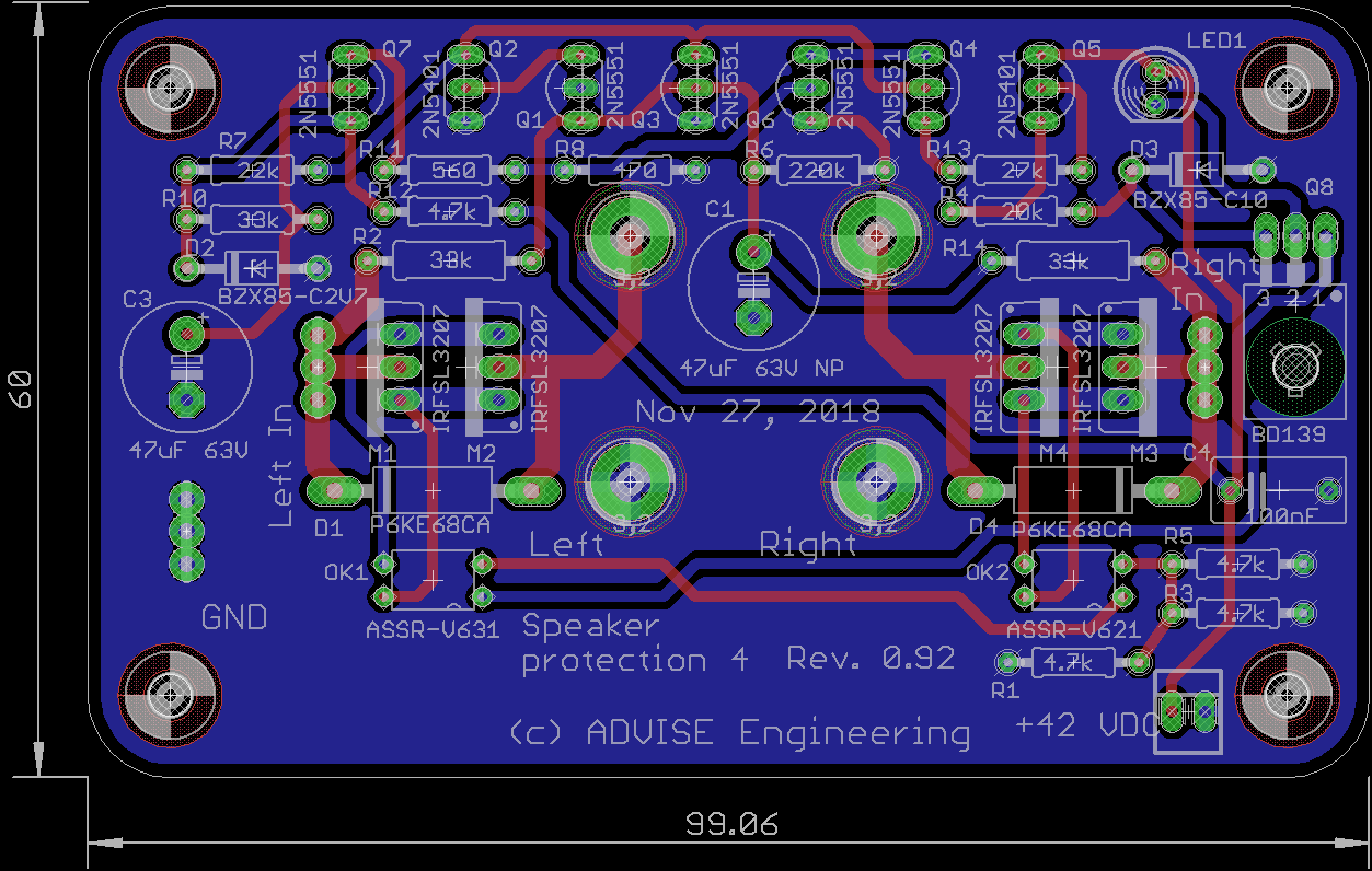

Hi Thimios, thoglette, Ranchu32, NMOS,
I agree with Thimios that the 21st Century Protection board is the most complete solution but it is far too complicated for a small amplifier :(
I fully agree also with you about relay problems with high DC current and this is the reason which convinced me to forget the relay solution. In addition, Project16 was very nice to give me enough information about his circuit to make my own protection module PCB on my specific form factor :)
I made this PCB with the same size of the Quasi amplifier and the Quasi CRC power supply, but it is a stereo module that will be fixed on the rear panel directly on the speaker connectors (remember that I am using a very compact enclosure and I am limited to 60 mm height) !
Now, if I don't have any error, I will have to wait for the PCB before to finish completely this nice small amplifier :D
Thanks for all your good suggestions,
Marc

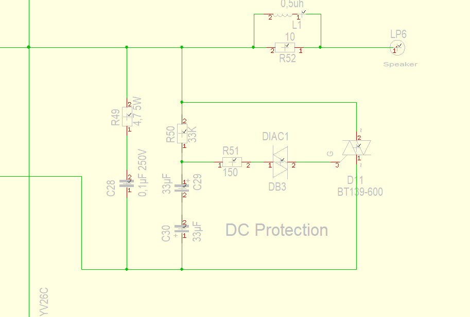

DC Protection
1 circuit . 30V DC trigger Triac and protect speaker if amplifier device fails
2. Circuit 8V DC trigger Triac and protect speaker if amplifier device fails
If you have rail > 30V you can take circuit 1
because SBS 2n4992 for circuit 2 not easy to get
need order by mouser , farnell ...
circuit 1 devices easy to get
Normally amps have Rails > 30V no need circuit 2
THIS CIRCUITs works in any amplifier from 1W - 5000W
Its from PA, never I have lost speaker against DC since using crowbar
