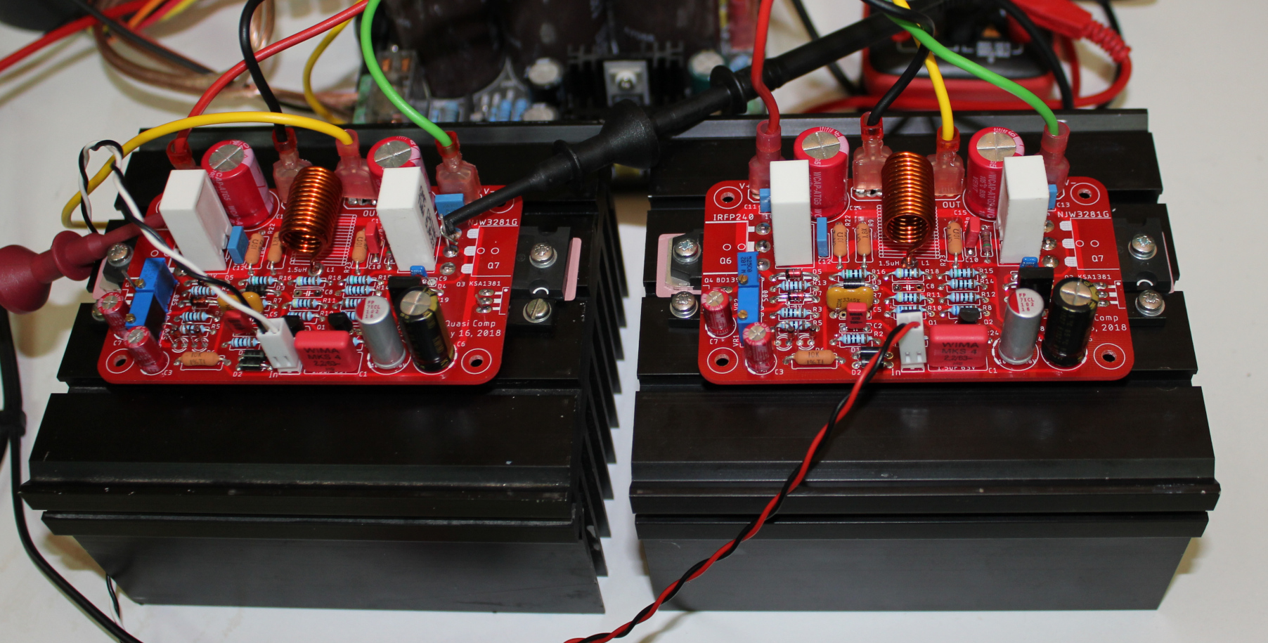

I add some pictures of the amplifier in test and how it will fit in a very slim enclosure .. and you will understand why I redesigned the PCB 😀
Well done on getting your layout to work Marc! Looks great.
I'm still trying to work out how to squeeze my Phunk layout boards into the bigger brother of the case you have, so good job getting yours to fit in that small case!

Another Quasi is singing...

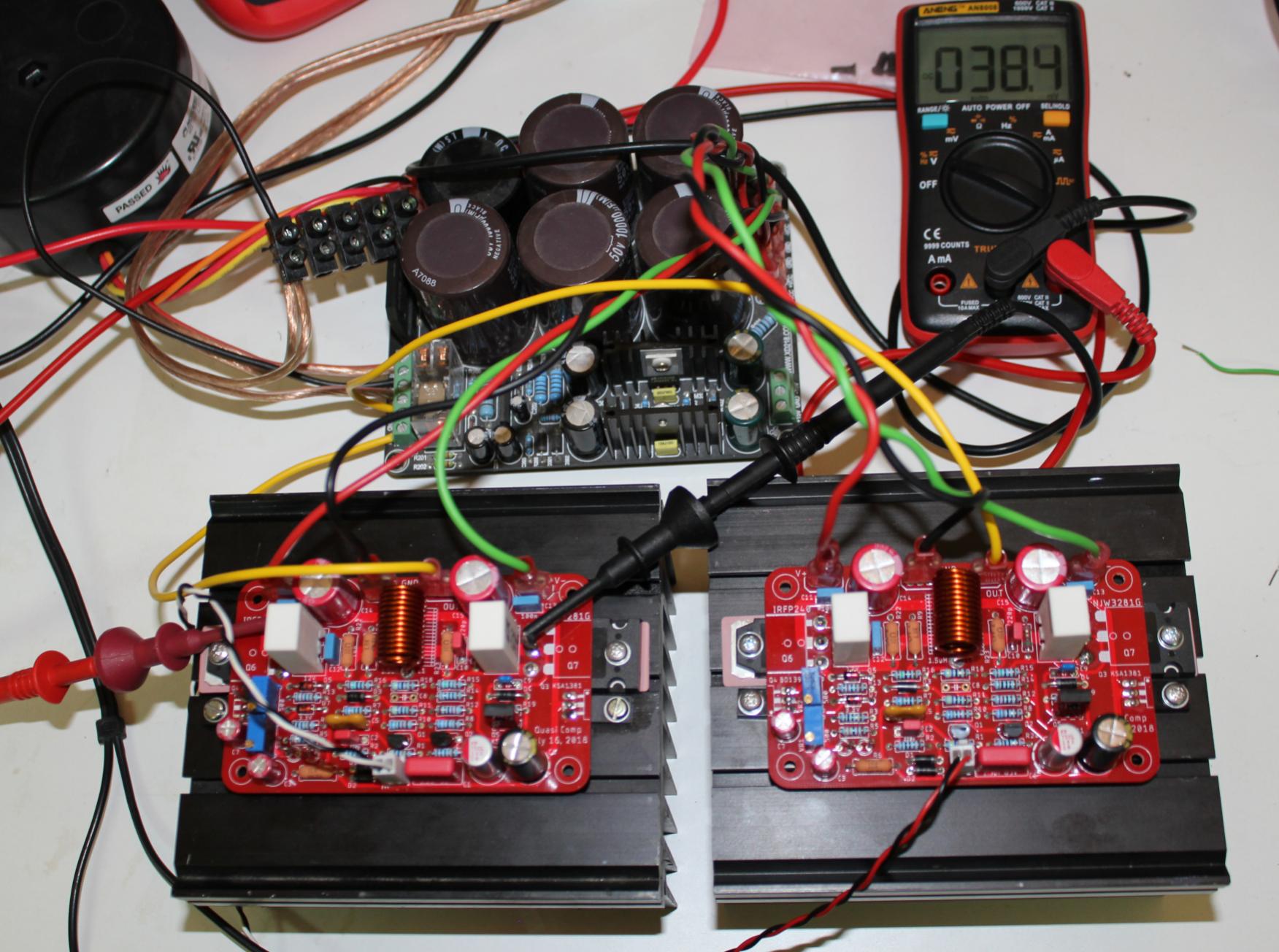

Hi Hugh and others who helped me to build the Quasi, I am pleased to tell you that the second channel worked immediately, it is so easy when you don't put the wrong transistor
I have only listen them on small selves speakers but I can say that the quality is very good 🙂 It is amazing for such a small amplifier, it is not exactly like a tube amplifier but for the price it is a winner ! I may try some time a combination of tube for voltage amplifier and transistors for the output stage to get rid of the heavy and expensive output transformer 😀
In a previous post I asked what was the purpose of the bax circuit because I have found that I put a 22 pF instead of a 22 nF 😡 It was OK but I change it anyway... I also found that 500 ohms was OK for the bias trimmer because I didn't have 1k trimmer and I measured on the first channel about 270 ohms for 100 mA bias.
I will come back later when I will have listened the Quasi on better speaker and when I will have finished the assembly in the chassis...

That PCB is superb
That PCB is very good. The output devices are well away from any electrolytic caps and if they get hot the PCB won't be baked so much.

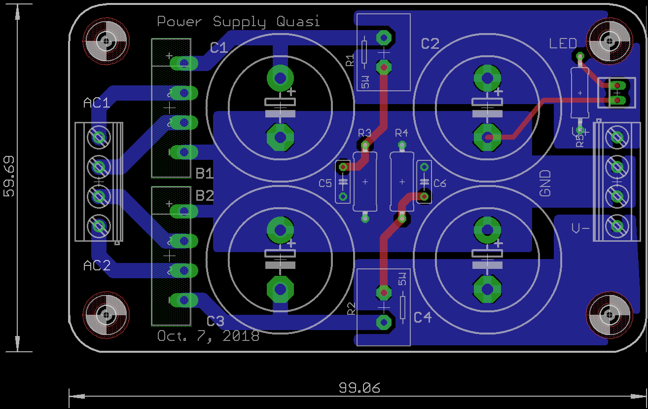

I like the format so much that I have made a very compact power supply C-R-C board for the quasi with the same dimension and they can be fixed on the heatsink too.

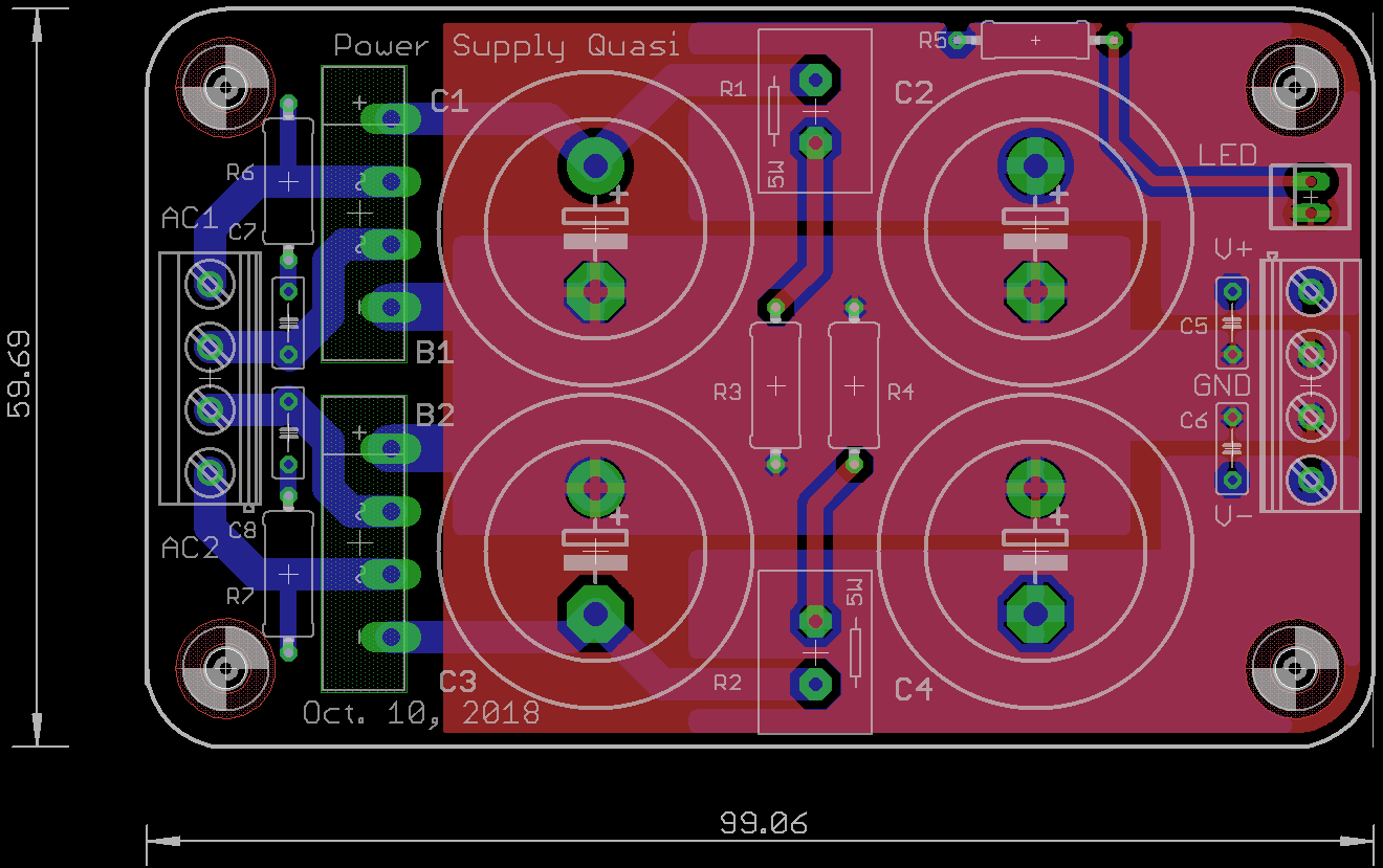

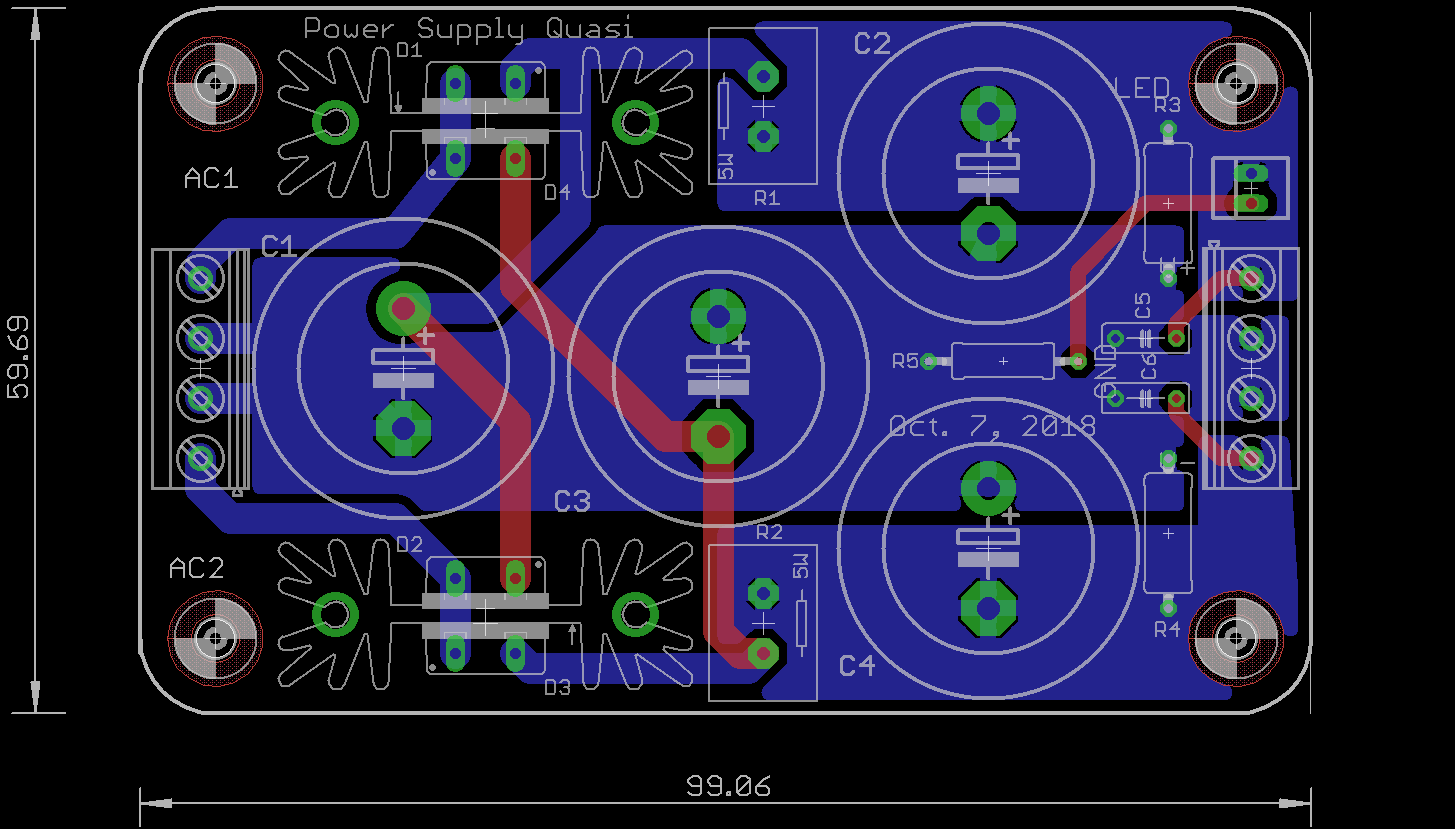

Hello,
New version for the CRC power supply because of connectors availability 😡
I have made two different rectifier schemes, don't know which one is the best ? Only one bridge with good diodes or two bridges with standard rectifiers ?
I am not in hurry since I will go to Phoenix AZ in 10 days and I will not get the PCB before my trip 😀

Nice work there Bandol! PSU design looks nice and compact too. You might consider adding an R between the negative terminals of the two C’s as there can be more noise attenuation of the negative output of each bridge rectifier.
Missing copper balancing on bottom side (etching process).
Would add more copper pouring.
Info button on Outline (using Eagle); edit value to 99 or 100mm...
2 cents.

Hello Marc,
nicely done. just one suggestion. make the diode output go to smoothening caps and then connect the cap to the resistor. i.e. DC supply must be taken from cap terminals.
4th paragraph from last.

Also you could consider adding transformer snubbers.
RingNot: power supply for chip amps. Bare PCBs and/or assembled+tested units
Go for 1st option of design, dual bridges alway lower noise.

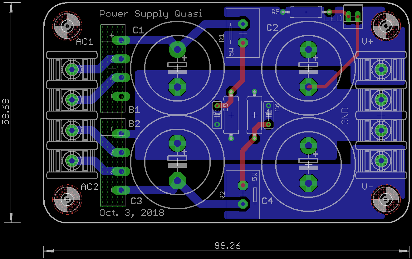

Hello Prasi, JPS and XRK,
Thanks for your feedback, I have added the snubber on the dual rectifier version which seem to be better. I have not understood the other comments regarding copper balancing, may be my english is not good enough ? And I don't understand why there should be a resistor to the between the two capacitors GND ?
Here is the modified layout with the snubber...

Salut Marc, etching process will remove a lot of copper on bottom side. It‘s bad then you could use it for copper plane (from top) paralleling: more copper better conductivity.

Hello bandol
You should double all the tracks of the rectifier bridges (one above and one below) to R1 and R2.

Bonjour Cognac,
Do you know how to do it with Eagle when a track is already made on one side ?

I do not know Eagle but I think that a simple copy-and-paste of a track side below can be put side by side, very easy with Sprint Layout.

Use line command (symbol: a slanted line) and start placing a line (of appropriate width) from the center of first pad to center of next pad. The active layer should be opposite to the one already placed.
