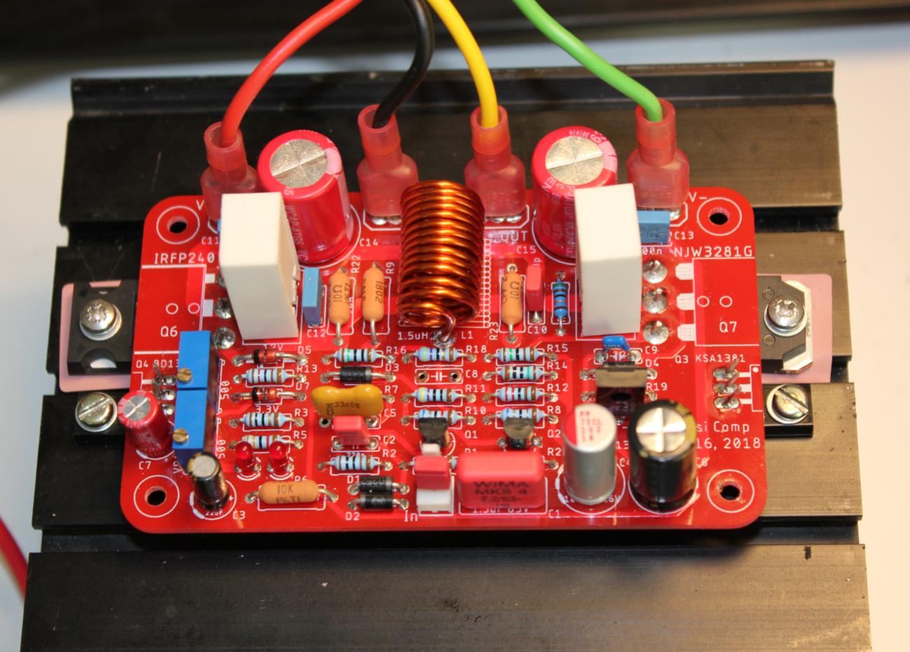

Hi Hugh,
I will buy some KSC1845 ( only 6.80 € for 100 at MOUSER ) therefor I will not need to twist the legs in the future 🙂
I have replaced the two red led with 2N4148 as you suggested and I have been able to trim the offset down to few mV 😎
Now the Quasi is playing since one hour on a cheap loudspeaker without box. i fixed the bias at 50 mV = 150 mA and the heatsink is only a little warm at 44°C. Before to connect it on better equipment, I will build a small protection module for which I have received the PCB yesterday (see picture).
I cannot comment yet in detail about the sound because I did not use a preamplifier and with the input directly connected to a CD player, the output power is not very high, even if I have increased the power supply to +/- 41 VDC, but it look very promising...

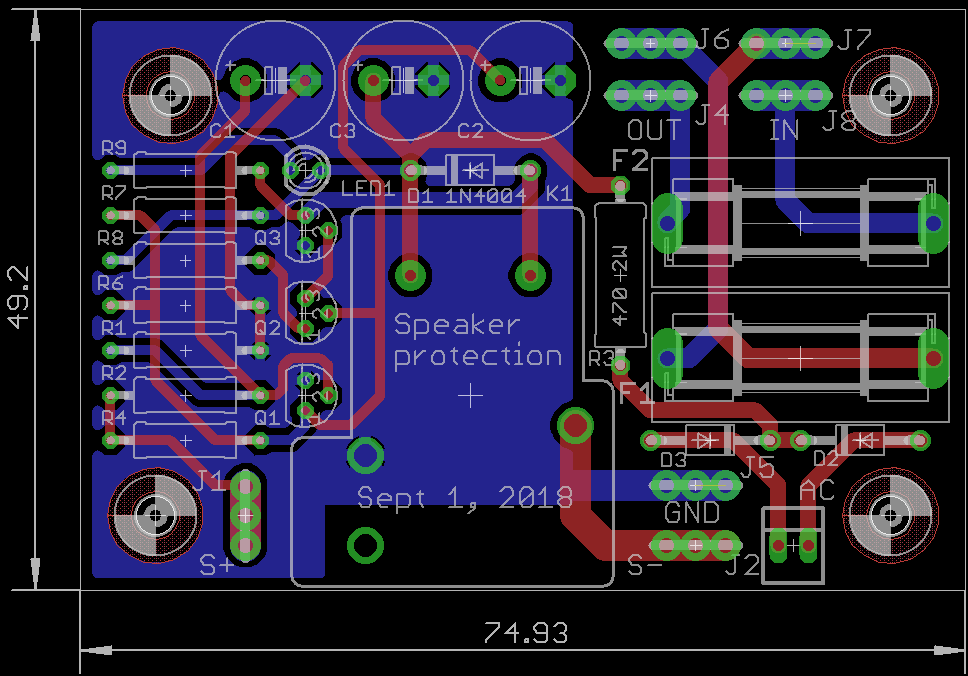

Hi chat72, Hi avtech23,
Yes, I can publish the Gerber files, but I prefer to finish the test and give a correct description of the part used before to make it public to let the user's to build it without the small modifications I had to make 😕
This was a project made by Ranchu, Hugh and many other participate, Prasi send me his file to save design time in making the PCB and even improved it, it is really a job of several people 😀
As you understand I prefered to make a PCB which will fit in an existing box than to make a box around a PCB because I am not very good in mechanic
Best regards,
Marc
Best regards,
Marc

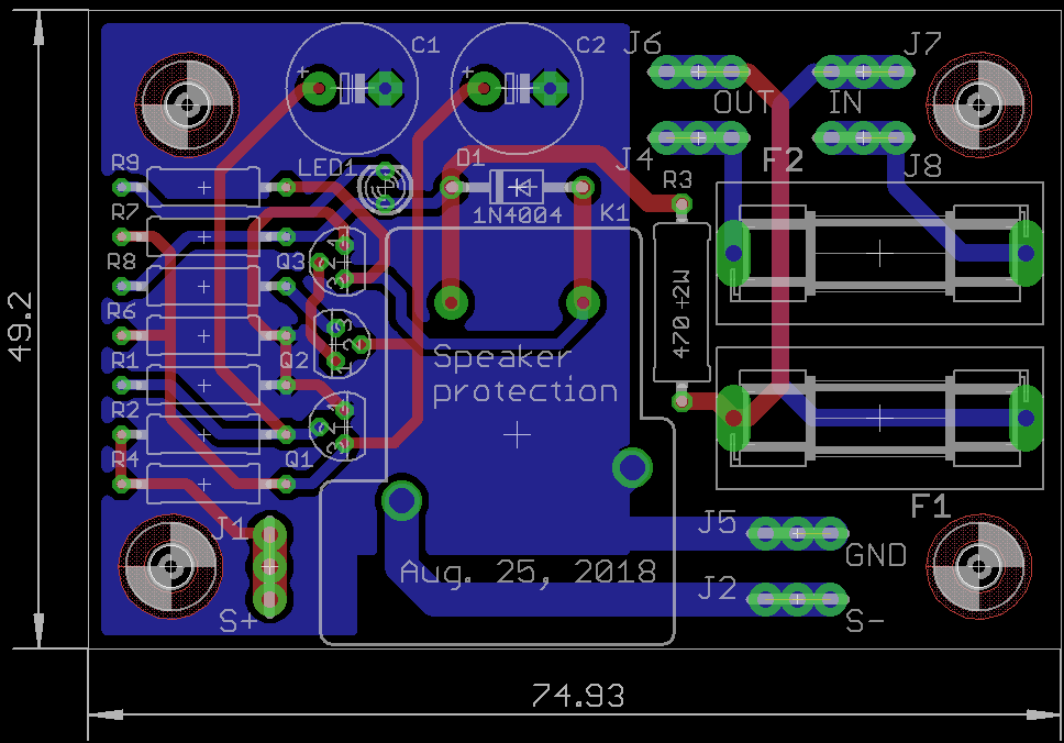

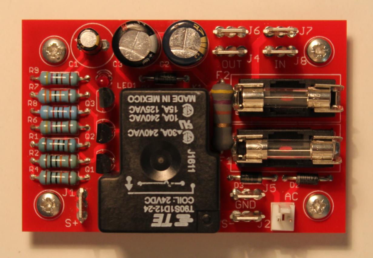

Marc, did you test the dc protection circuit ? if so on what voltage does it operate, positive and negative ?
Hi Jan,
No, I didn't test it yet, but after your question, I have seen that I posted an obsolete schema and layout, I have added the AC voltage input to include the power on delay and to power it from AC instead of the +42 VDC of the Quasi, here is the final version of the protection module 🙂
Prasi made also a PCB that can be fixed directly on the panel mount speaker binding post ( My MOSFET amplifier designed for music. ) see post 744.
This is a very classical schema, I didn't invent it, in fact I use it since about 10 years in the MyRef LM3886 excellent amplifier designed By Mauro Penesa, and it has always worked very well therefor there should be no problem 🙂
The voltage can be adapted with R3 and you need 24 VDC for the relay !
Rgds,
Marc
Rgds,
Marc
