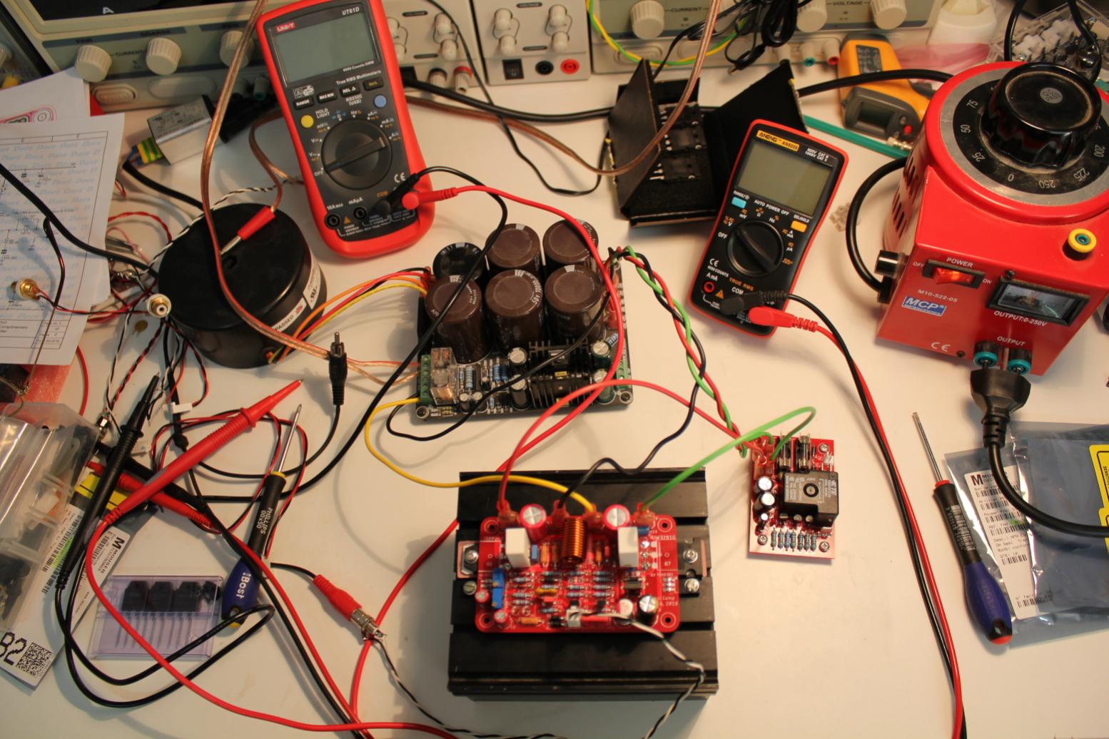

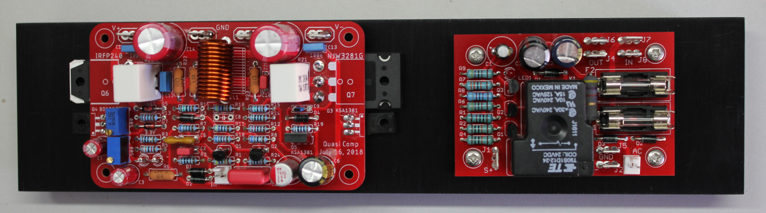

Hi Hugh, Bangla, Vrystaat,
Thanks for your help, the second channel is working loud 😀
I think the mistake on the first channel with the 2N5551 mounted instead of the KSC1845 destroyed the KSA1381 and that was the reason why I could not play it loud 😡
Now it worked flawlessly immediately when connected, I was able to adjust the DC offset and the bias without problem and it is not very warm with a power supply of +/- 41 VDC and a bias of 100 mA 🙂
What I have changed :
1) the 2N5551 replaced by the KSC1845 of course, my biggest error
2) the two red LED replaced by two 1N4148
3) the 1.5k R9 by a 1.8k
4) the 150R R14 and the 120R R19 replaced by two 100R as suggested by Hugh
5) the IRFP240 by the FQA40N25 (a big package !)
6) the 2SC5200 by the MJL3281AG
7) the 500R VR2 by a 1k
8) the 22uF C3 by a 47 uF
As several said already the quality of the sound is very good, for the time being I am only listening in my lab with only one small speaker, but it is very promising, not completely like a tube amplifier but with some nice similarities 🙂
I add some pictures of the amplifier in test and how it will fit in a very slim enclosure Aliexpress.com: Acheter Boitier en aluminium 2107 k Complet En Aluminium Amplificateur cas/Mini AMP Cas/Preampli Boite/PSU Boitier 212 * 70*257mm de psu enclosure fiable fournisseurs sur HIFI amplifier spare parts center Store and you will understand why I redesigned the PCB 😀
Best regards,
Marc

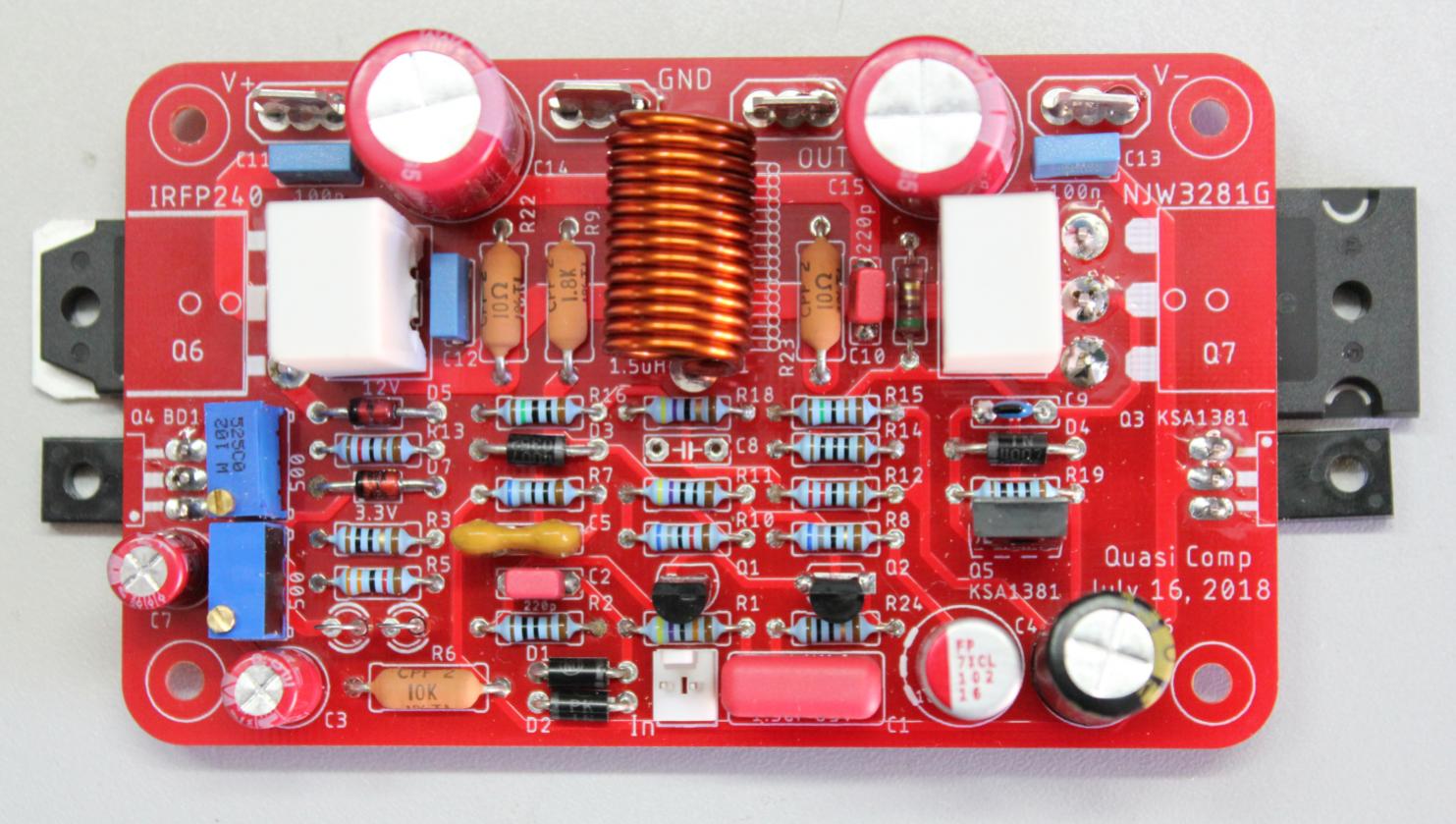

Bonjour,
Thanks for your nice words 🙂
As promised, since the "low profile Quasi PCB" is now singing, I put the Gerber files for those who could be interested by this slim PCB. There were already 4 or 5 versions of the very successful amplifier made by Ranchu, Hugh and many others who tested it and liked it, so I am the "Number 6" like in "The Prisoner" The Prisoner - Wikipedia 😀
I also give my thanks to Prasi who kindly send me his schematic file to save some time and checked my PCB, and thanks to Philippe who made the nice coil of the Quasi 2 😀
I will add a corrected schema and BOM with the last components value in an other post but you can already found the Gerber files here...
By the way, when I wrote the part list, I found that I make an other mistake with C9, I put a 22 pF instead of a 22 nF 😡 It was working fine even with this error, please can I ask what is the purpose of this Bax capacitor ?
Au revoir,
Marc

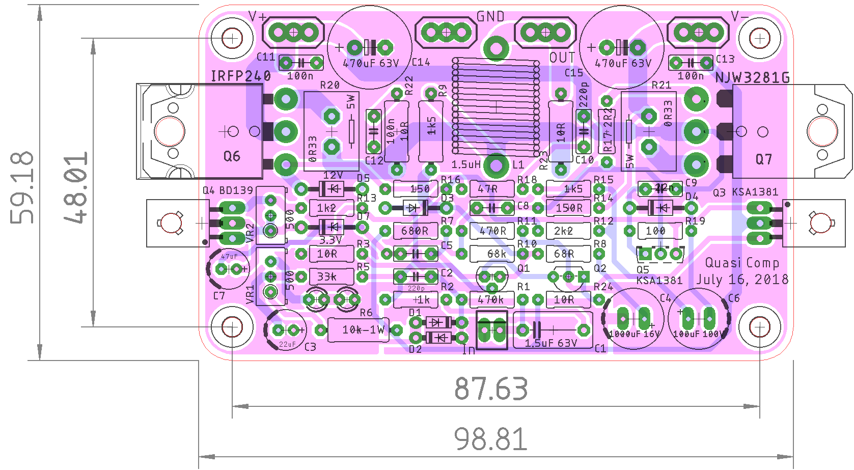

The schema and the BOM 🙂
Be careful some value indicated on the silkscreen aren't the same than those on the schema or the BOM which are the good one (at least for me). Most are not critical however except for the 1N4148 which replace the red LED.
I have also added the PCB with components picture...
I hope I didn't forget anything.
Bon week-end,
Marc

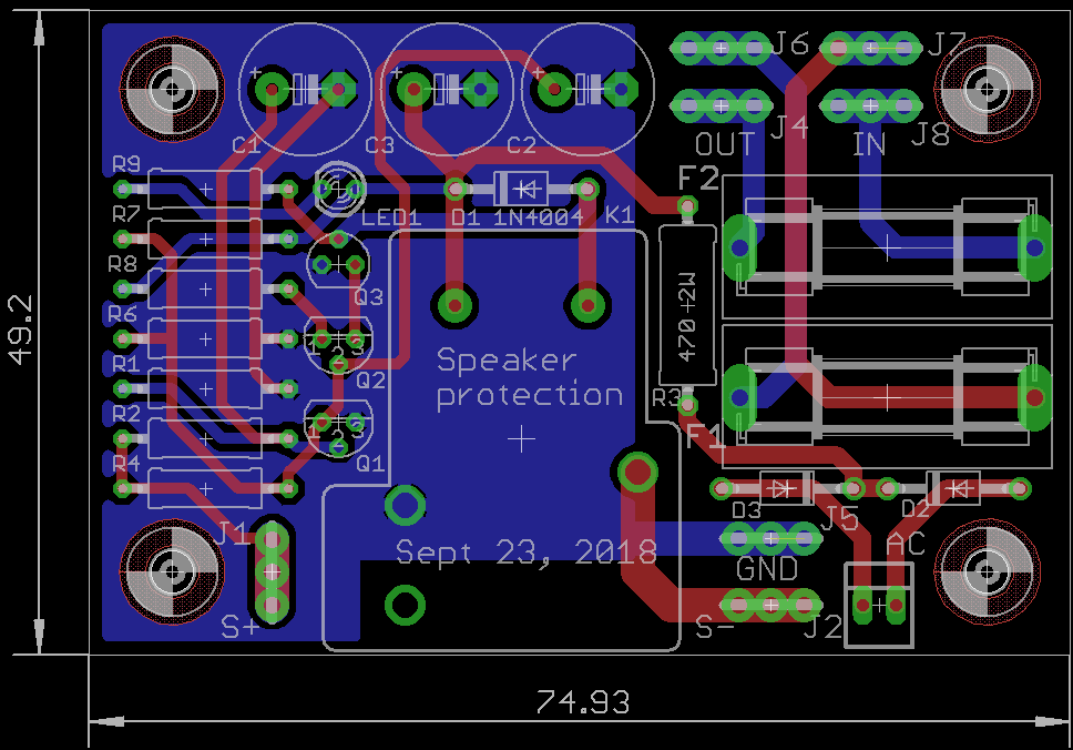

Hello Prasi,
I have tested the protection module, and guess what ? I have again a transistor with the wrong pinout
This make me crazy, it is not a Japanese transistor name, it it the BC639, but it has the Japanese pinout ECB https://www.onsemi.com/pub/Collateral/BC635-D.PDF instead of the European one for BCxxx EBC 😡 That never happen to me with tubes 😀
After I cross the legs again it worked, but I think I have to change one resistor value because the relay open only if 7 VDC is present, I think it is too much ?
The power on delay is OK, about 2 seconds 🙂 Attached is the modified PCB...
Best regards,
Marc
- Very simple quasi complimentary MOSFET amplifier
