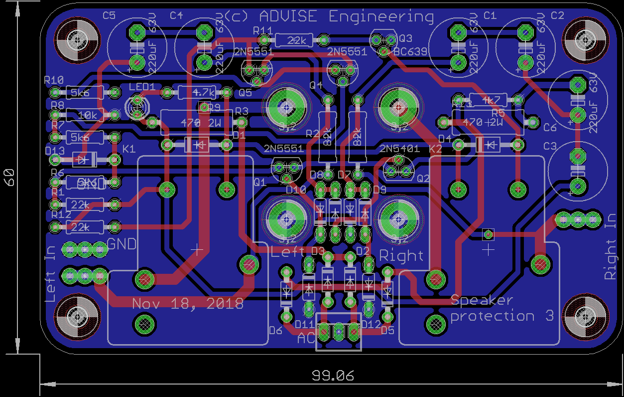

Thanks for your help, I think I find a way but I get clearance error where I add a track on the top layer :confused:
Is it OK anyway ?

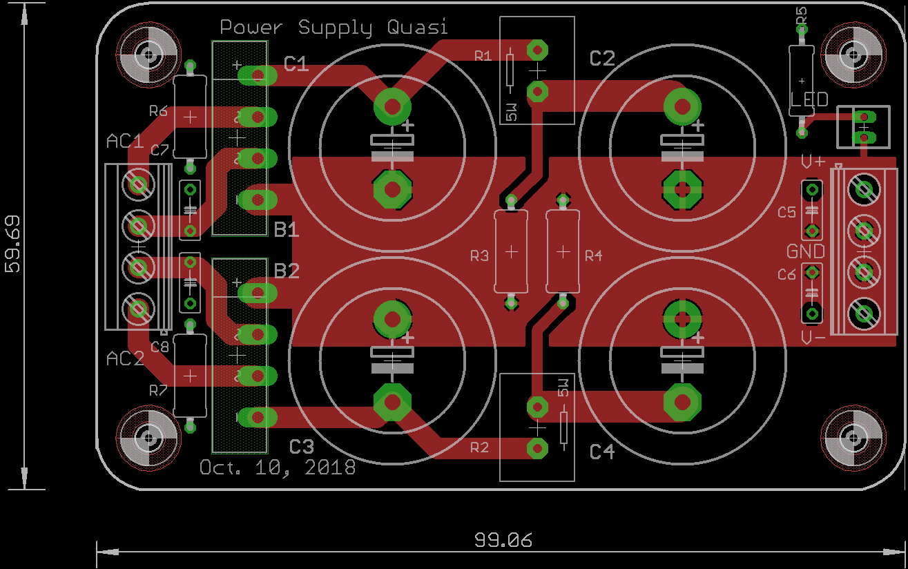

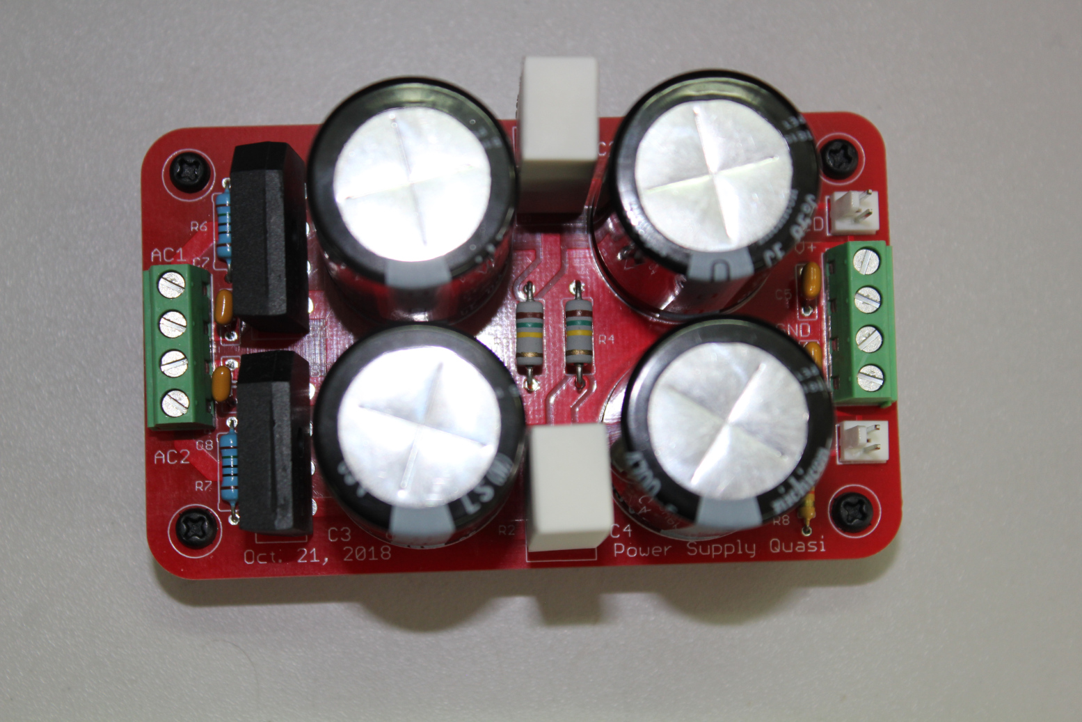

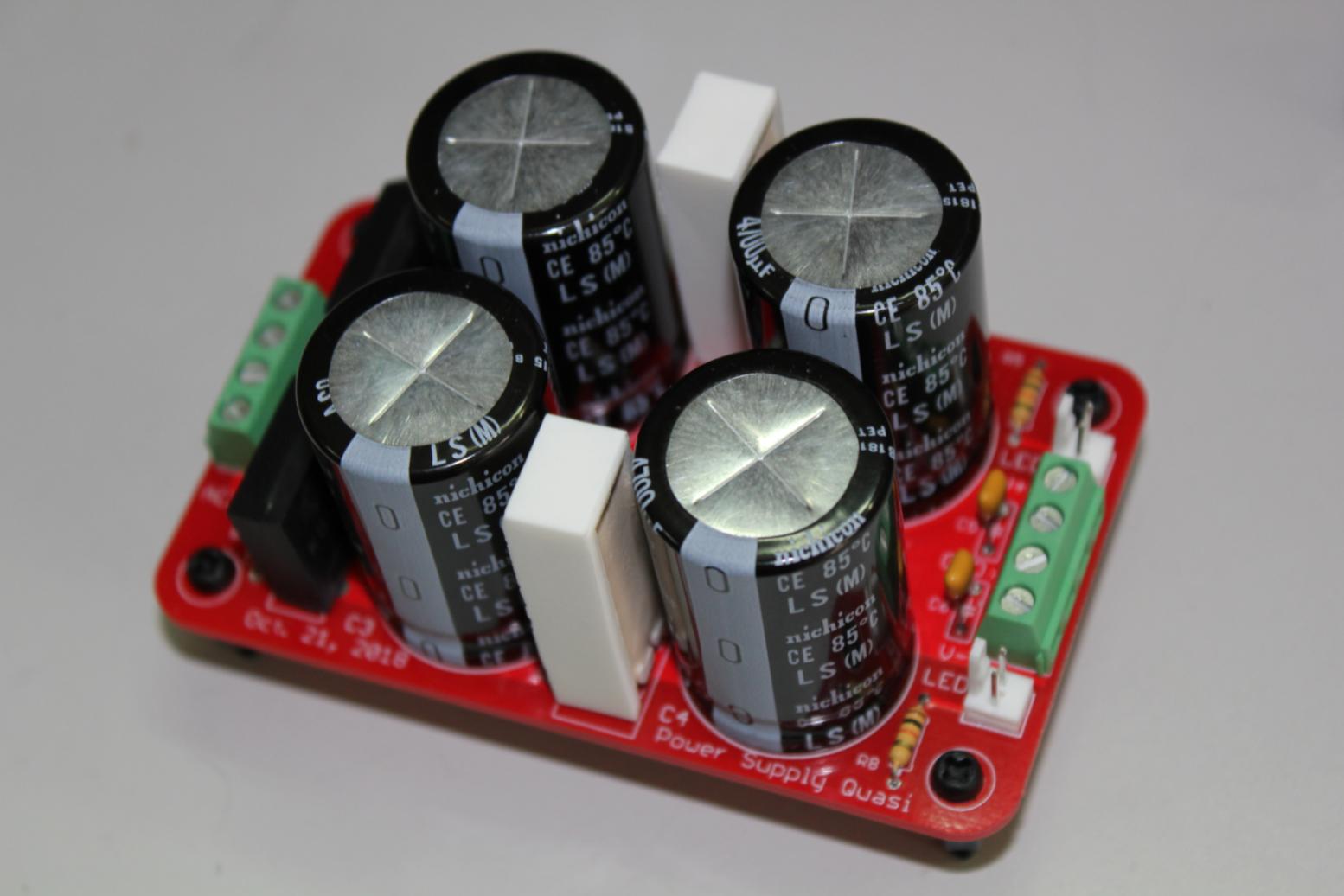

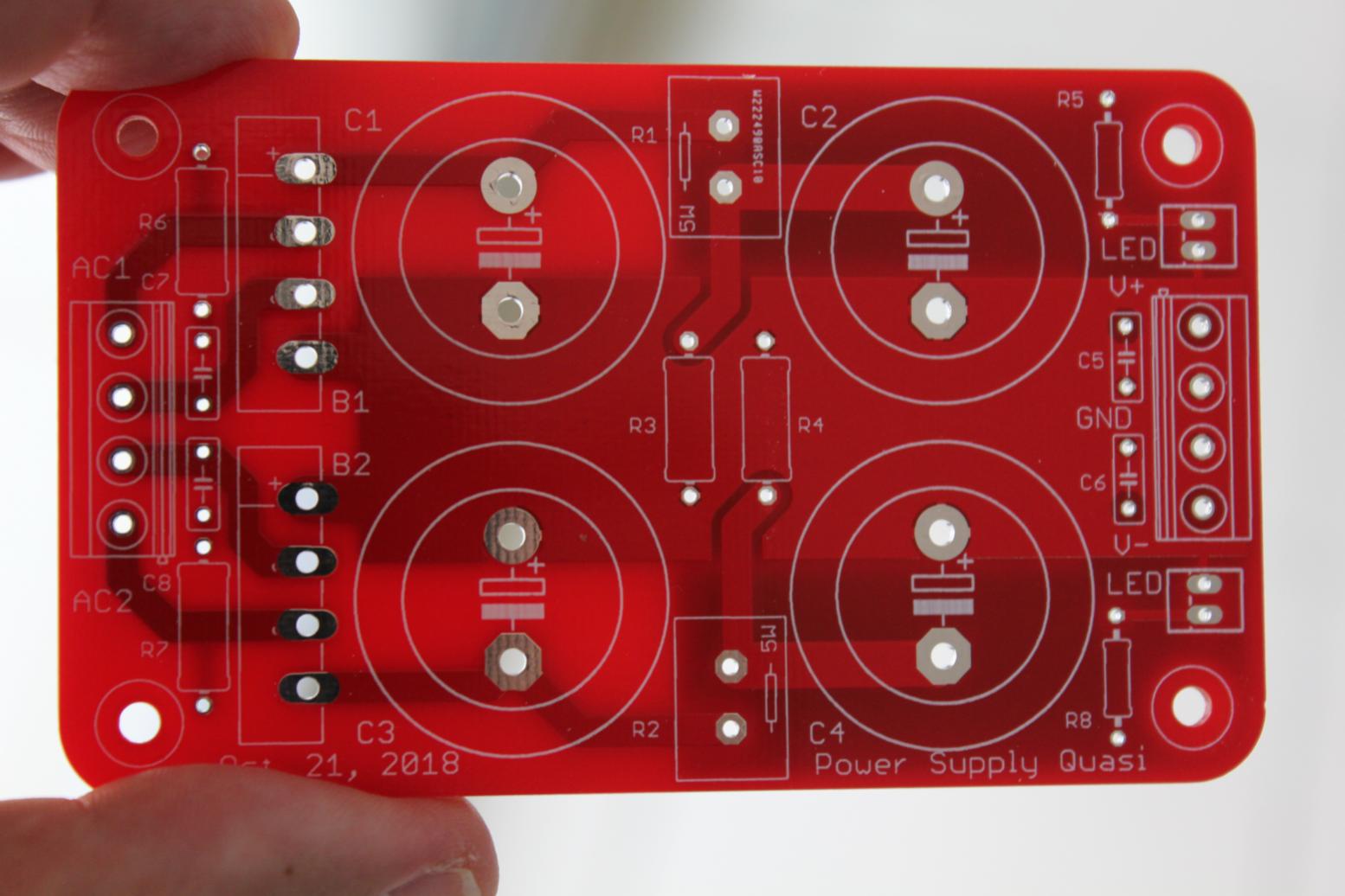

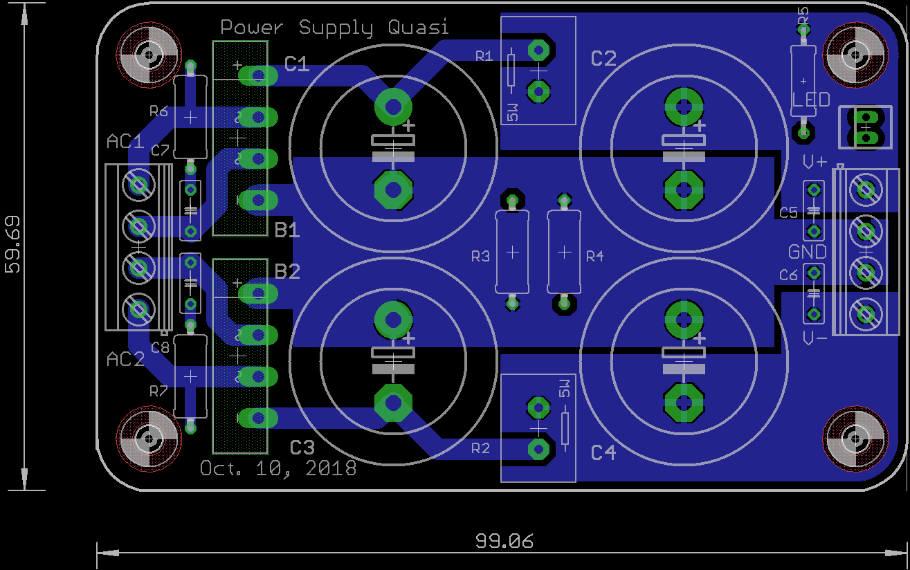

I have received and build the PCB for the Quasi Power Supply (see pictures), now I have still to redesign the speaker protection to finish this small amplifier.
Marc

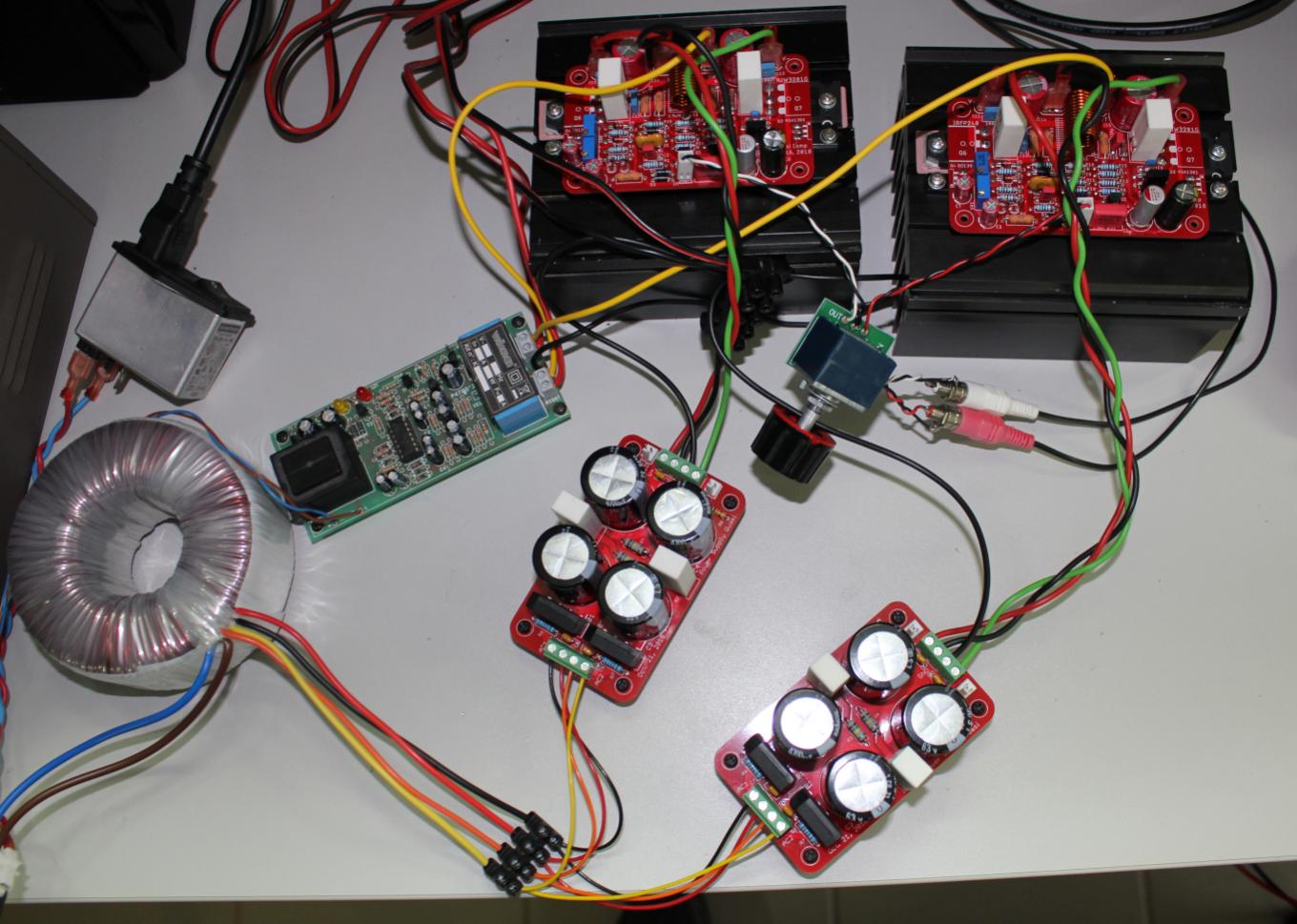

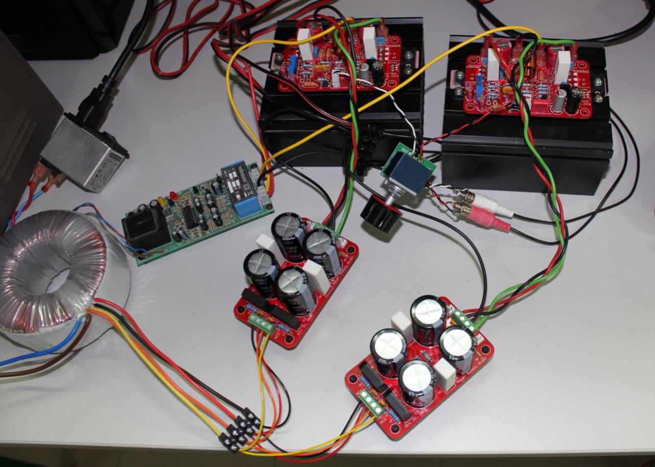

Now the Quasi is playing with the two small CRC Power Supply modules and its new 30 Volt 300 VA transformer, I have 42 VDC on both outputs because the line voltage is a little more than 240 V !
Now I am using a Velleman speaker protection https://www.velleman.eu/downloads/0/illustrated/illustrated_assembly_manual_k4700.pdf until I finished my own design, the first one was not good enough for negative DC :mad:

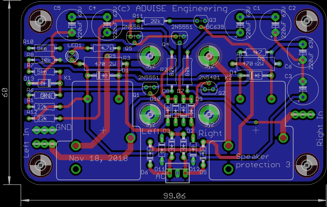

I made a single protection module for both channels that will be fixed on the rear panel directly with the speaker connectors and will not include DC fuses, see PCB layout
After that I will put it in a very small enclosure https://fr.aliexpress.com/store/pro...?spm=a2g0w.12010612.8148356.19.5f702f5bCEQd5V The amplifier modules and the CRC Power modules will be fixed on the two side heatsinks and the transformer on the middle of the bottom plate :)

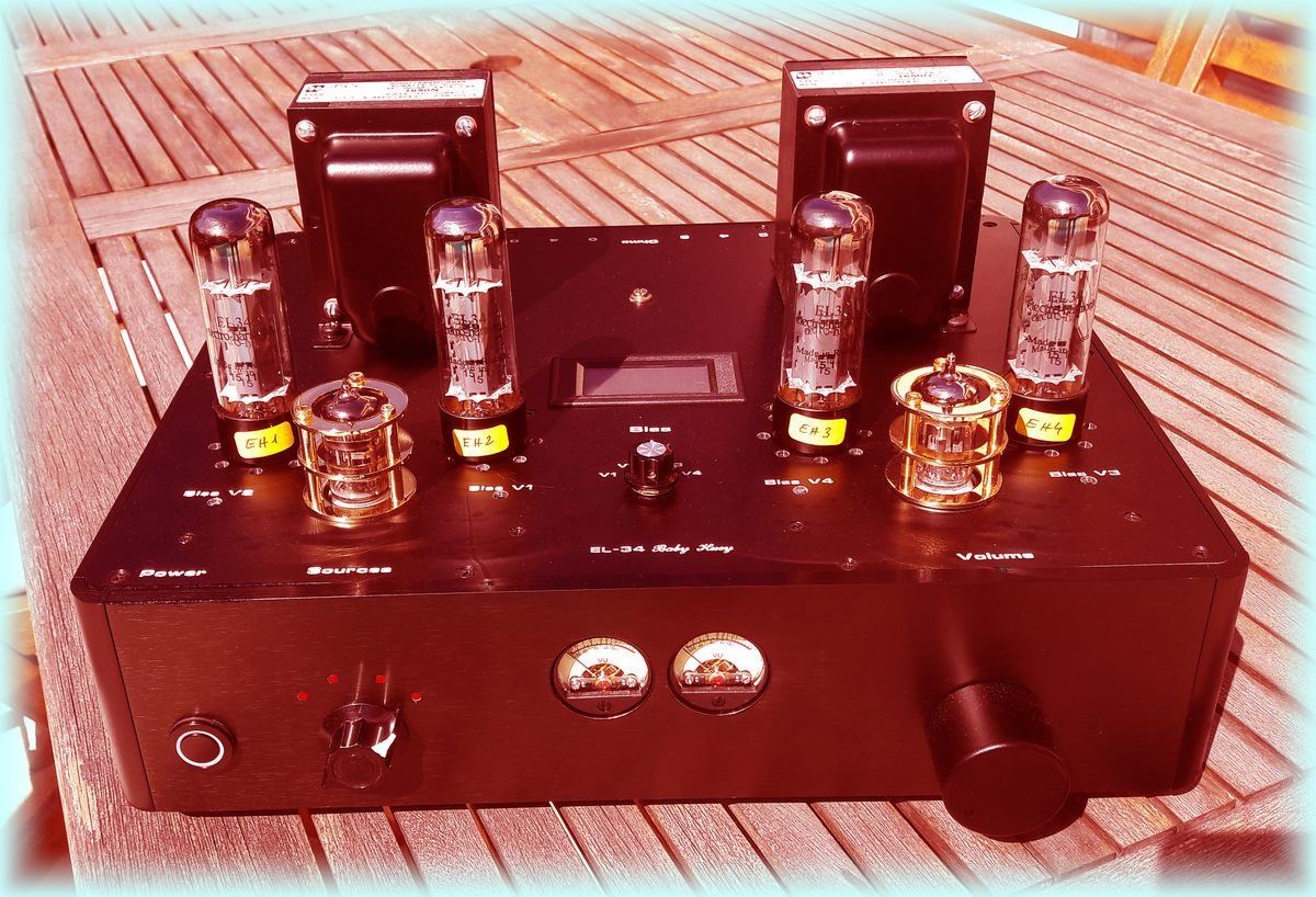

I have build the EL34 Baby Huey, see picture ( EL34 Baby Huey Amplifier ) that I like a lot because its particular feedback give a clear and solid sound without the softness some time associated with tube amplifier and I found the Quasi very similar in result for a much lower cost (mainly because it does not require expensive output transformers).

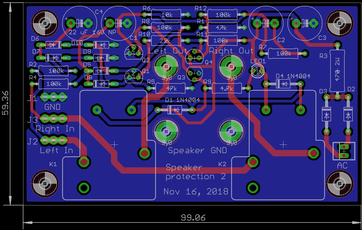

Hi manniraj,
Thanks for your kind word, I have made this PCB exactly, as you said, to install it on the side heatsink, that is why I keep the height of only 60 mm like the amplifier module :)
I an currently designing a DC protection module for the speakers since I was not satisfied with the first one described on post 2300 :mad: I have made a first improvement on post 2325 to have a better protection on the negative side by adding a PNP transistor based on the suggestion of Jac ( lehmanhill ) here : My_Ref Fremen Edition - Build thread and tutorial
But after some tests on my first modified module, I was still not fully satisfied :cuss: and I decided to test an other design based on Elliott Sound Product Project 33 : Loudspeaker Protection and Muting It is still a work in progress but I show it here to have your possible suggestions or recommendation while I will finish it...

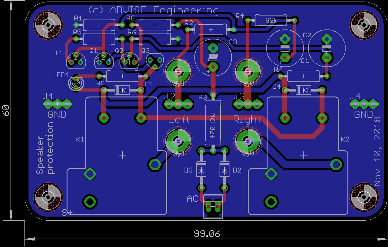

OK, this is the third version of a possible Speaker DC protection :)
It is based on Douglas Self book (5th ed page 465) and also used in the 21st Century protection board DC detection stage ( How to build a 21st century protection board )...
Now I have to decide which one will give best result to protect my speaker ?
I would like to know what others builders are using since there is not a lot of discussion about this subject ?
Rgds,
Marc

Hello Marc,
You could have a look at UPC1237 chip also, now C1237HA.
It can have over current protection and quick shut off, apart from initial start delay and dc protect.
As a last resort, to protect expensive speakers, you can take a look at crow bar protect circuit.
Apex has one such design.
Studio Reference Amplifier
regards
