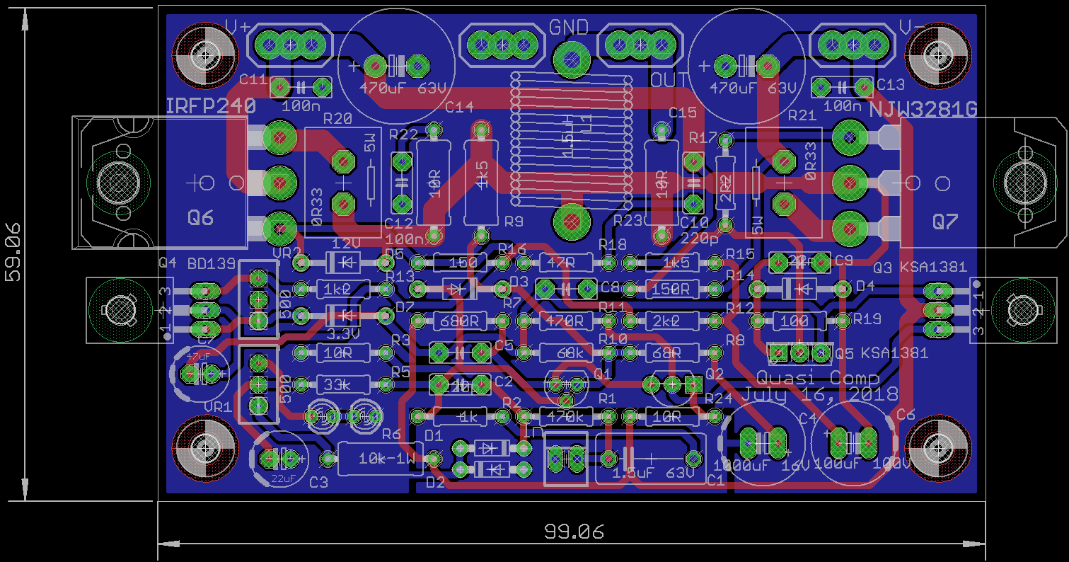

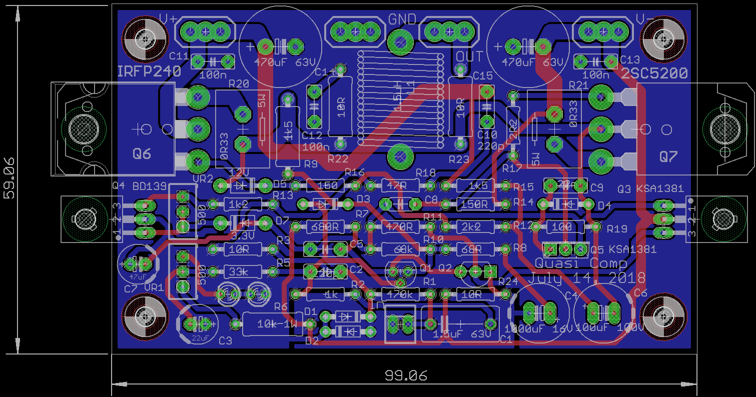

I have increased the size of the capacitors to 13 mm but I have to move a lot of things, however I have found that the 1 W resistor were far too big therefor I could reduce them 🙂 During the modification I also modified some value based on the schematic drawn by DACZ (I hope that they are the last ones ?) and I found that the capacitor C7 had a wrong connection because the previous version didn't use a Zener diode ! By the way I have seen that it is possible to replace the Zener diode by a blue LED ? From my experience in tubes amplifier, it seems that LED are less noisier than Zener because they are used in the direct way and not reversed... What do you suggest ?
I have attached the schematic and the PCB for your comments.
Best regards,
Marc
7K2 in R13??
Hi EmeryBB, Hi Schillg11,
Thank you for finding the typing error on R13, the correct value is 1k2 on DACZ schematic 🙂
I have also reduced the size to 99 mm, but the mounting holes will be very close to the PCB edges 😱
Finally I have made some cosmetic changes on the PCB to optimize some tracks and make the serigraph more readable... I hope this version will be OK to produce the boards ?
Best regards,
Marc

This is probably the last version before I send it to the PCB manufacturer, I have checked twice and make some tracks shorter, I hope I didn't forget anything, if you find some errors please tell me 🙂
I have a 300 VA transformer with 2 x 35 V AC output : http://www.farnell.com/datasheets/2...16.403529732.1531758856-1429063303.1527947097
This will give about 45 to 47 V DC after rectifier and 2 x 10'000 uF capacitors, do you think it will not be too much with a NJW3281G bipolar and a IRFP240 MOSFET and that I can use it for a stereo amplifier ?
Marc

The voltage will be 49V to 52V DC after rectifier.
This NJW3281 & IRFP240 can work with no problem up to 85V

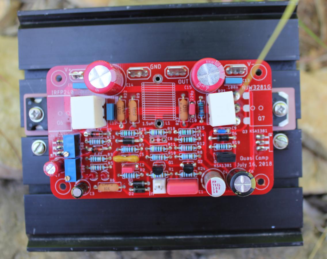

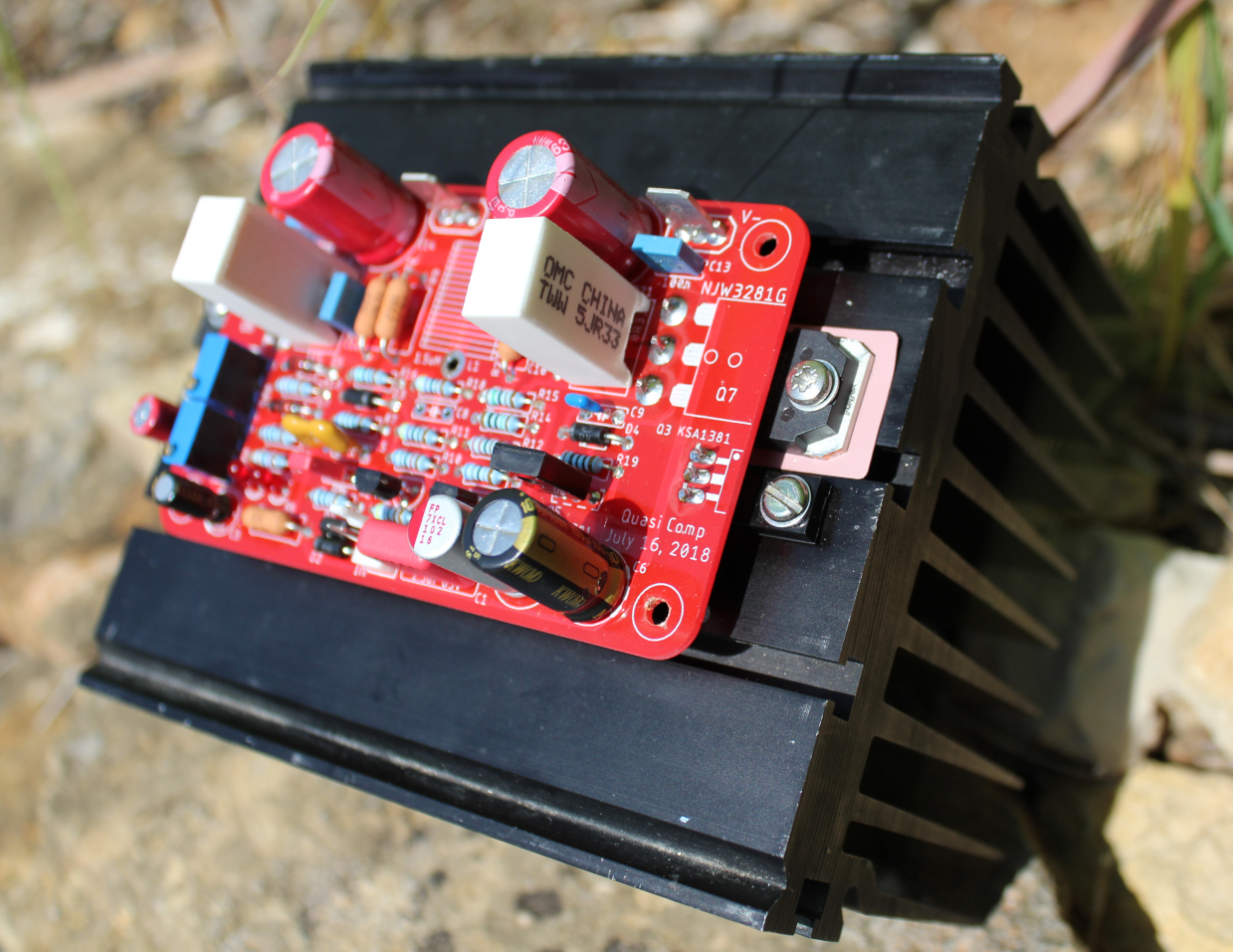

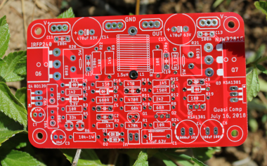

I have received the PCB, very good quality as usual with PCBWay 🙂
I still need to find some big wire to make the output coil before to start the test 😱
Marc
