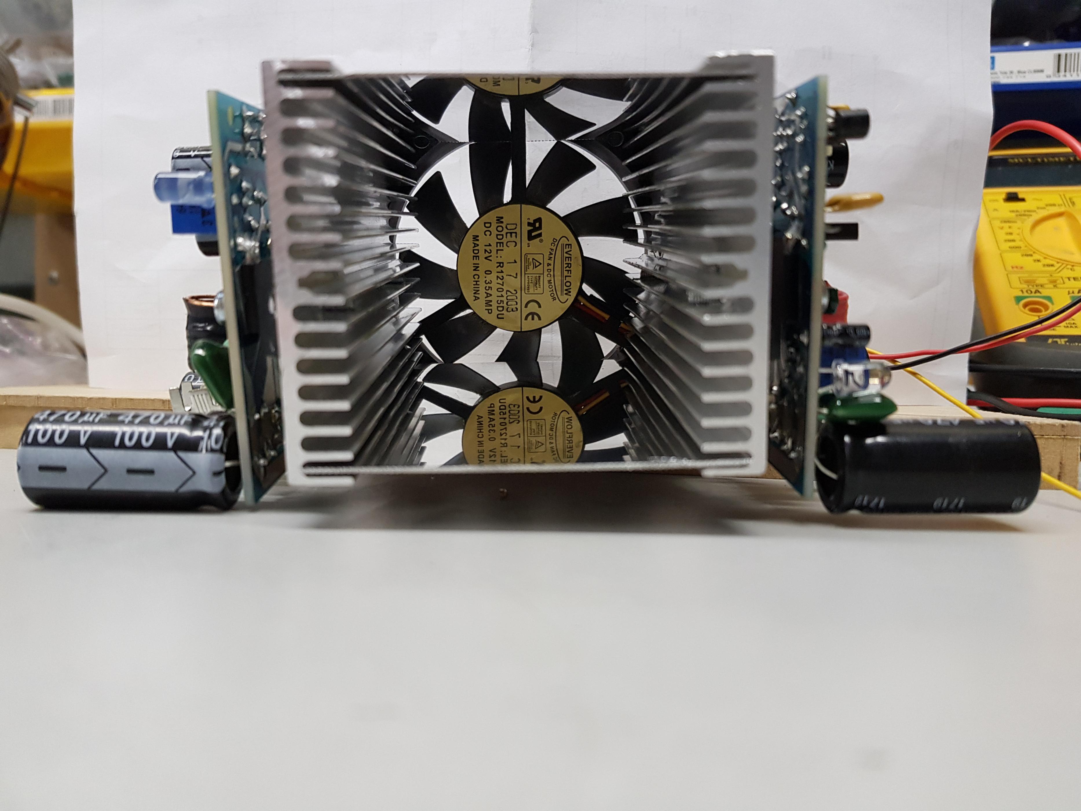

Nice tunnel cooler. Check out some large 120mm PWM fans and PWM controllers. Set to 10% and they are dead quiet. Built in temp sensor to speed up motor and also audible alarm.

They look pretty good. I'm looking at using the smaller fan for this build at about 50% voltage just because the chassis I intend to use isn't much higher than the fan. I'll probably get some for another build in a bigger enclosure though.

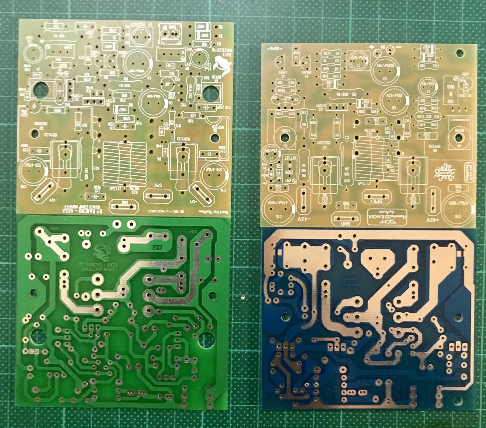

Ive got mail, yay. Feeling very grateful to Ermine22 and Avtech23 for there generosity tonight. I asked if anybody had a spare board a week ago and tonight I open the letterbox and bam! There’s two waiting for me. My plan is to build both, do a side by side comparison and then give an amplifier away as a present to a friend.
I’ve ordered two set of fets and transistors and will order the rest of the missing pieces this weekend.
Big shout out to Hugh for helping me along with this. I’ve been slowly reading through this thread and have to say that there is an amazing amount of knowledge and experience that has been shared here. I’m learning so much and haven’t even started the build.

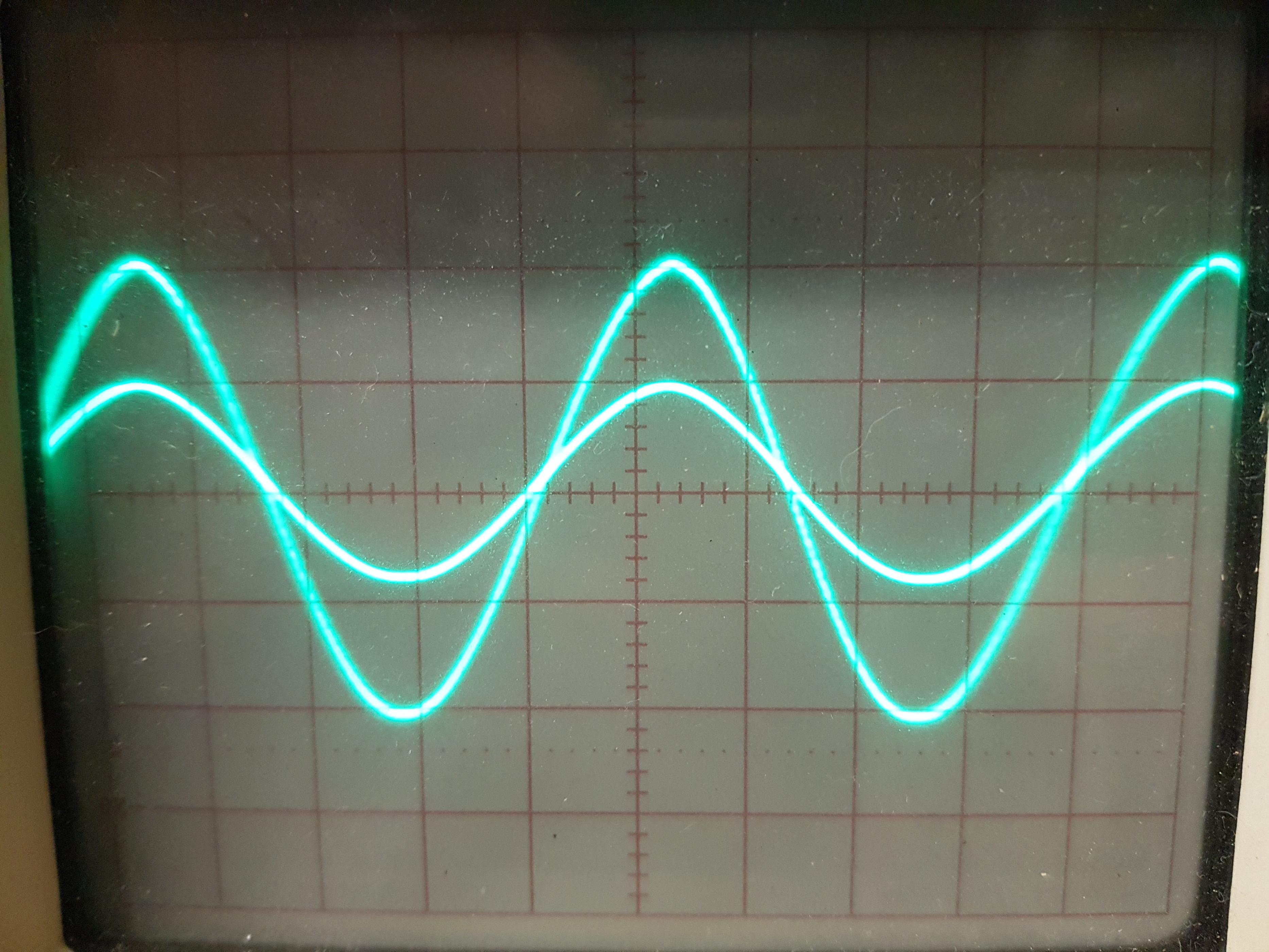

I replaced the FET on board 2 today and all seems well.
I think I identified the problem... one of the test leads in the set I got had been factory assembled red-black 😱😡 I'm guessing that lead perhaps shorted the output.
Anyway, board fired up with +/-36VDC and 1KHz sine wave looks pretty good! There is some noise on the output waveform, looks like switching noise from the SMPS.
I realised I only have 4 Ohm test speakers, so apart from a brief no-input check on the noise floor, I've yet to hear if the switching noise is audible.
The output devices put out quite a lot of heat when the current is flowing! Definitely need some good heatsinking and cooling when they get boxed up!
