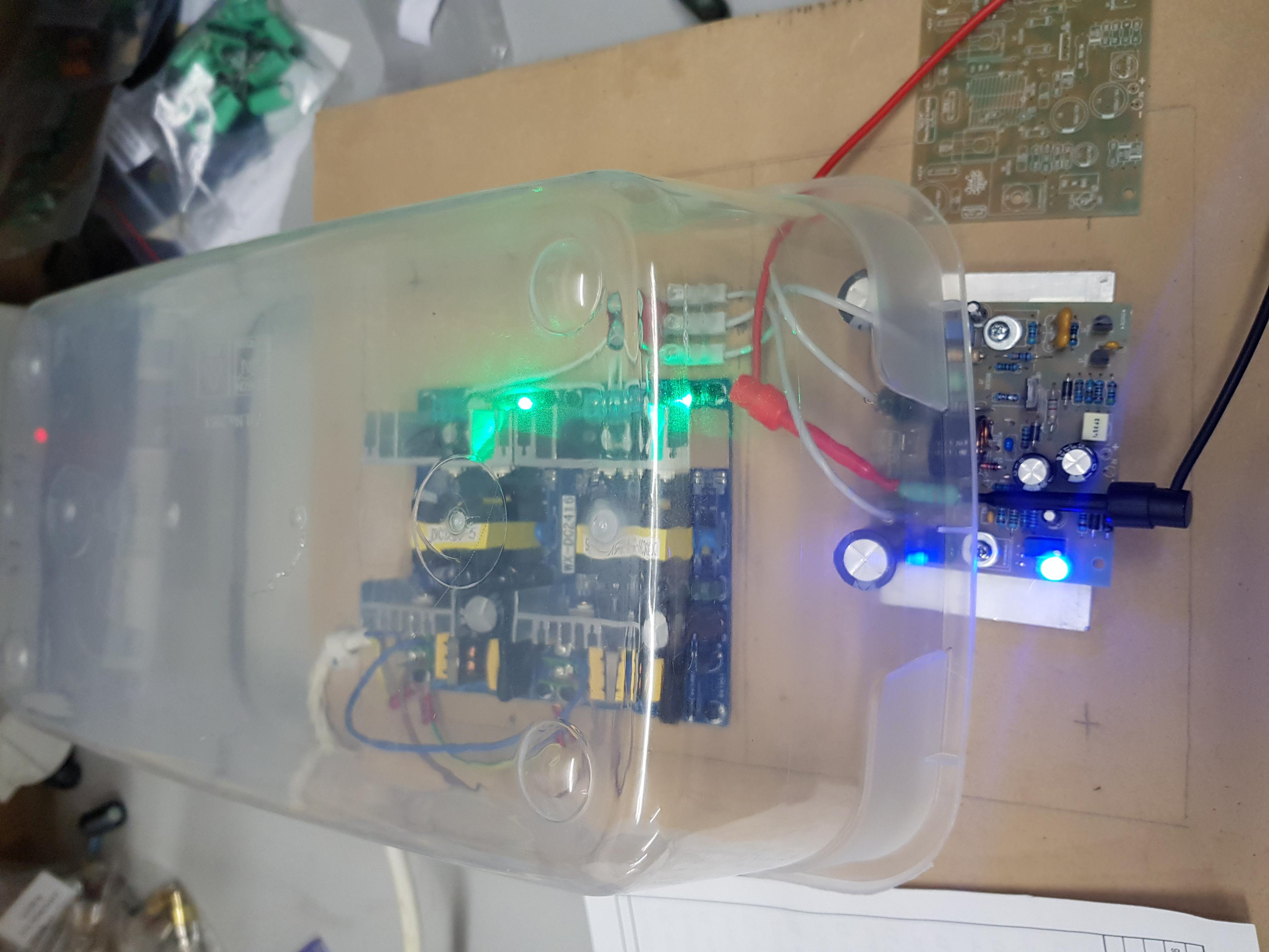

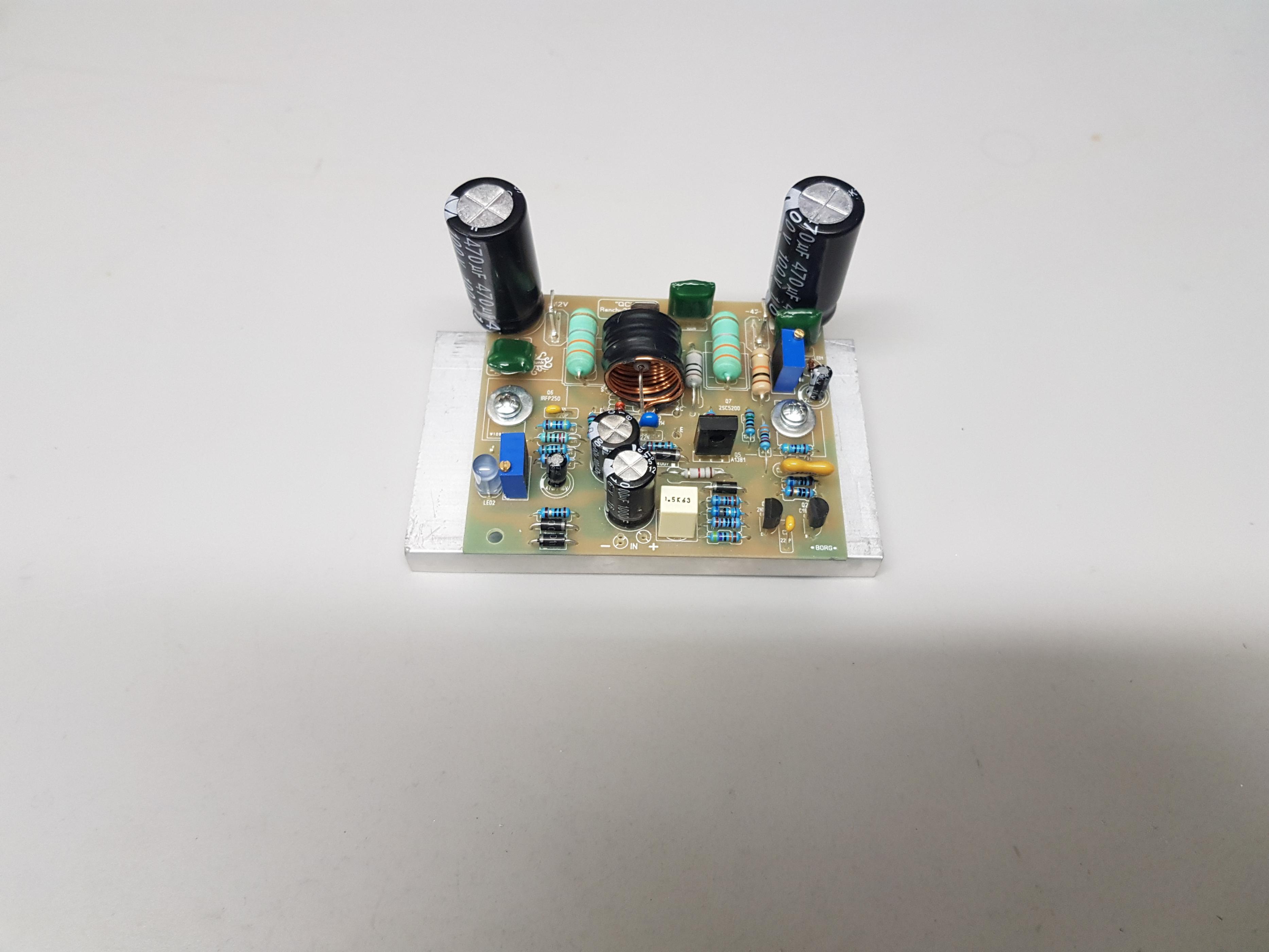

I've tonight tested the first two completed Phunk (Borg style) boards as far as pre-input testing.
No smoke and both boards bias nicely. The offset was tames from 450mV+ by changing D9 & D10 to the green diode and jumper configuration. DC offset now starts at about 70mV and drops to +/- 18mV (just drifts around).
When I switch off though, I notice a DC spike of 2.4DC at the speaker output. This is tested no input or output loads connected.
Would that be from the inductor? Is that going to be damaging for a speaker?
No the 2.4v thump is normal
Glad to hear that!
This build has been pretty enjoyable (big thanks to all those that put their time and energy into bringing this to the community)!
I'm looking forward to getting through the final stages of testing, assembling and actually listening to the boards 🙂
All that's left now is to chuck a sine wave through and see how it behaves and then hook up the workshop speakers for testing.
I'm currently using a dual 36V SMPS setup for testing - hopefully these aren't too noisy!
