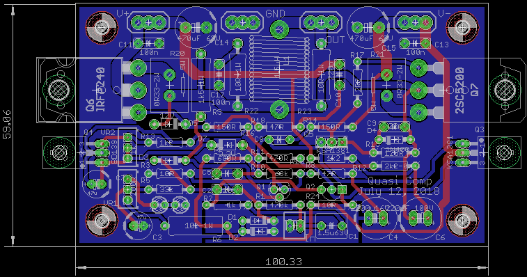

I started from a schematic kindly send by Prasi and I decided to make a new PCB. Why another one ? There is already so many nice PCB on this tread ! Well, my target for a semiconductor amplifier was to make it as slim as possible, let say at least less than 80 mm high, therefor I wanted to have a PCB of less than 60 mm high ! In addition I did not want to have the power transistors under the PCB to have a better access to them and to make assembly easier.
I am planning to use a box with heatsink on the sides like this one : Mini Dissipante 2U 250mm frontale 10mm ARGENTO coperchi in alluminio 2mm e retro 3mm and to use a 300 VA transformer with two 35 V AC 4.3 A outputs, I will also use Prasi CRC power supply board.
Please tell me if you think that this is possible and that a new Quasi could be on the way ?

Hello Marc,
Very nice, slim PCB and can be fitted in a 2U chassis easily.
Please check if you have 470u 63V caps available in the size that can be fitted on the PCB.
yes, the CRC would help SQ to your liking I am sure, or you could jumper the R of CRC.
unloaded psu volts may exceed 50V with your transformer, so you can adjust cap voltage ratings.
my 2c.
I am sure AKSA/Ranchu32 will guide you with much better and important suggestions, as they did when I designed mine.
regards
Prasi

is it possible to shrink down the length to a values below 100mm and are the Gerbers then available after testing good
BR
Günni

Hi Prasi,
Nichicon LXZ470/63 has a pin spacing of 5mm, 105°C, and a diameter of 12,5 mm. Maybe this could fit (also Panasonic FC 390/63, which i use often).
Günni
Hi Prasi,
You are right, I didn't see that the electrolytic were 10.5 mm diameter instead of 12.5 😡
I made the change with diameter 13 mm and 5.08 lead space capacitor but I had to move a lot of things because I didn't want to increase the board size... I will post the new version later because I have to go now...

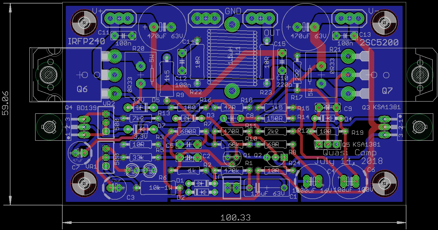

I have increased the size of the capacitors to 13 mm but I have to move a lot of things, however I have found that the 1 W resistor were far too big therefor I could reduce them 🙂 During the modification I also modified some value based on the schematic drawn by DACZ (I hope that they are the last ones ?) and I found that the capacitor C7 had a wrong connection because the previous version didn't use a Zener diode ! By the way I have seen that it is possible to replace the Zener diode by a blue LED ? From my experience in tubes amplifier, it seems that LED are less noisier than Zener because they are used in the direct way and not reversed... What do you suggest ?
I have attached the schematic and the PCB for your comments.

.. it does not use a combination of MOSFET and Bipolar in the output stage 🙁
I
That is not the definition of a quasi complementary.
brian.

OK, I understand, I also read that in the book of Bob Cordell, but his comments was that this approach was mainly due to the lack of good PNP power transistors in the past... But he say that it was not a very good solution and today real complementary output with PNP & NPN transistors offer much better performances, therefor my question : why we cannot use a PNP transistor like the MJW1302A in this amplifier ?
The fact that we are combining a MOSFET and a Bipolar could be interpreted as an Hybrid amplifier, like when we are using tubes and transistors 🙂
