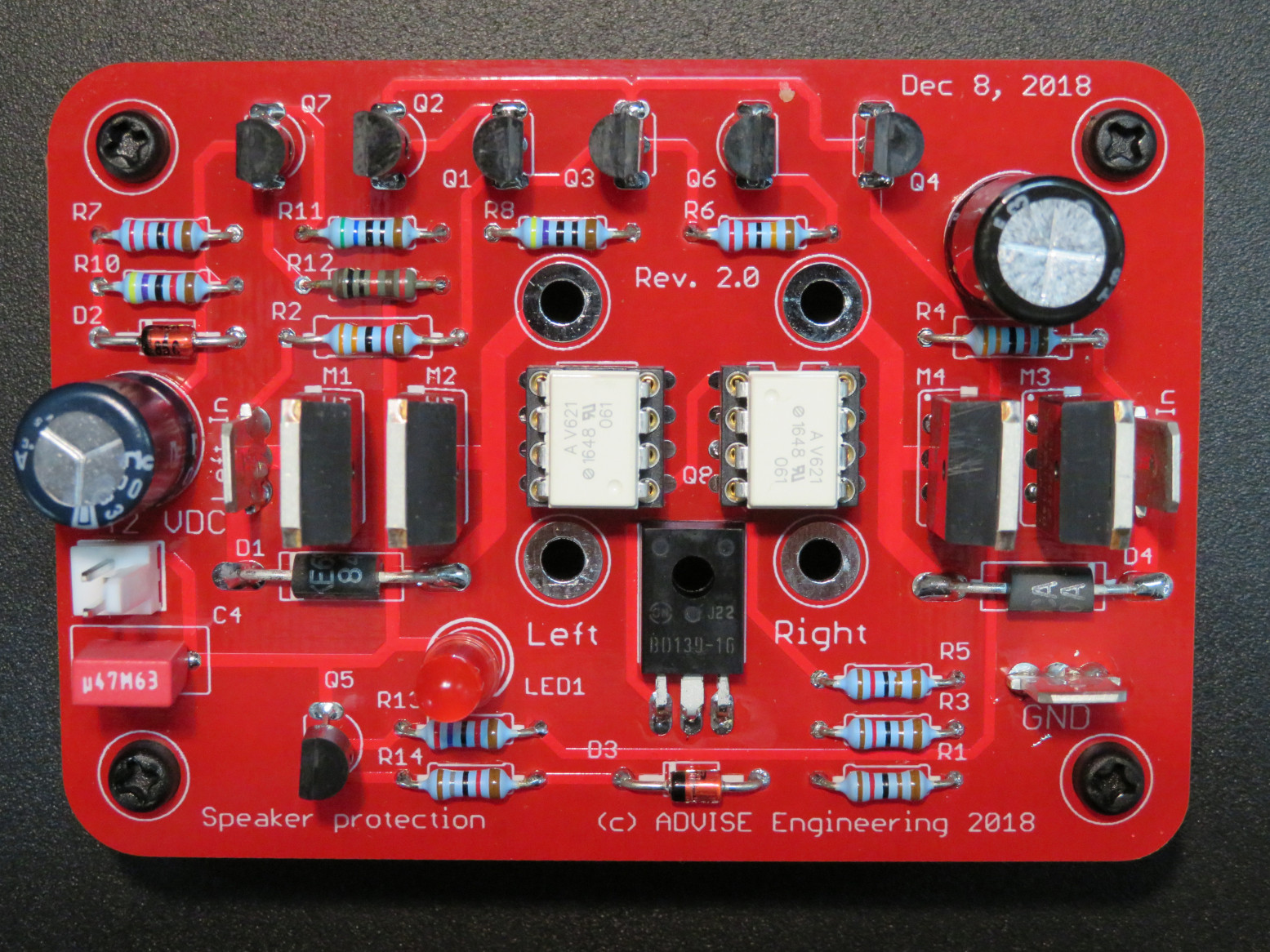

In the meantime I have received the PCB for the DC protection and mounted them, now I must test them and add them to the Quasi to finish it 🙂

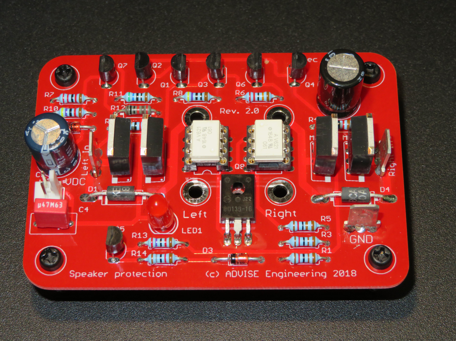

The schema and the BOM 🙂
Be careful some value indicated on the silkscreen aren't the same than those on the schema or the BOM which are the good one (at least for me). Most are not critical however except for the 1N4148 which replace the red LED.
I have also added the PCB with components picture...
I hope I didn't forget anything.
Bon week-end,
Marc

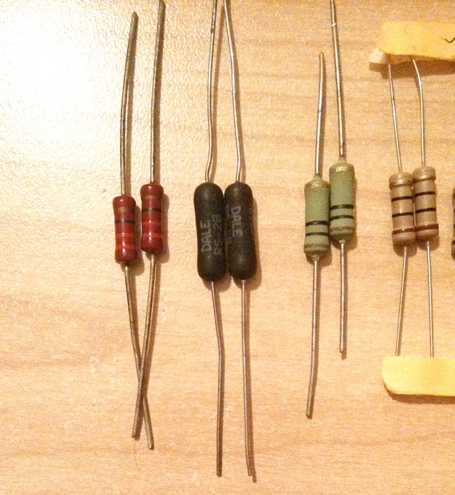

hi,
first of all thanks to Ranchu32, AKSA, bandol83 and all contributors..
reading the thread for a while and want to build this amp but need some guidance..
i too ordered Marc's pcb design and boards came from pcb house,
thanks a lot Marc..

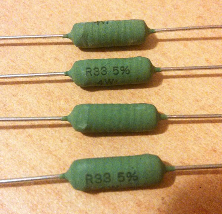

for R20-R21 (0R33) i found vishay AC03 wirewound 4w resistors in my parts bin, may i use it or it's better to order koa non-inductive ceramic resistors.
which one is preferable sonic wise?
for R23 (10R) i have a few choices;
dale rs-2b wirewound, a metal-oxide one and two more but can't identify them (leftmost and rightmost)..
also maybe i can source allen bradley carbon comps from a local store but not sure will it be stable in there?
which one is better choice?
last but most important; i have dx psu pcbs from my symasm attempt a few years ago. may i use for this amp too?
thanks in advance..
