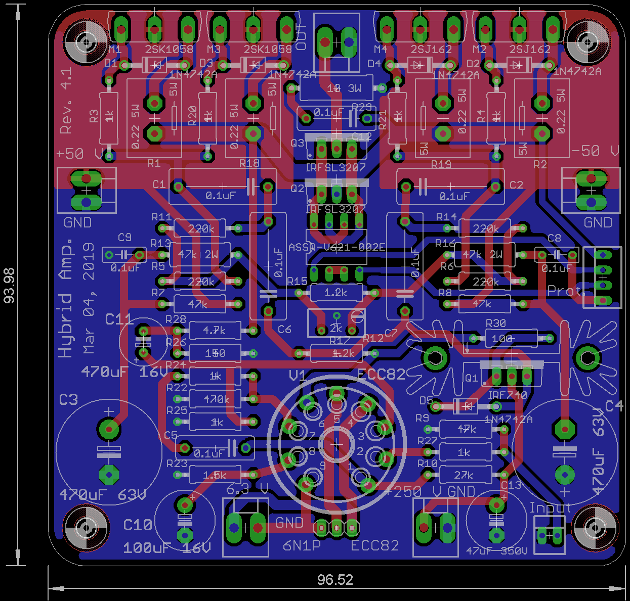

Hi Hugh,
Finally I have found from where I started this project, it was a schema published in 2003... It is no more on the web except as an archive, you can find it here : 6FQ7/6SN7 + MOS. FET Hybrid power amplifier !
As you can see I modified the SRPP with a MOSFET on the top device like I have done in a preamplifier with good result 🙂
Dis you think that it is possible to modify the connexion between the tube stage and the MOSFET output, because I don't like to have two 0.1 uF capacitors in serial ? If I understand this is used to bias the MOSFET ? Could we use a bias circuit with a BD139 by exemple ?

Hi Marc,
I too looked at the interface tube/mosfet and wondered why it was done.
After careful thought, I believe it was done to prevent cross conduction of the output during switch on, where this amp could threaten the output devices and even the speaker.
The two caps are carefully selected and rather low value. However, we are driving lateral fets, which have small gates with low capacitance. While I would tempted to move to 0.47uF rather than 0.1uF I suspect it would be very difficult to control the switch on pulses, and to that end it's a bit of a compromise.
Your heavy drive out of the second triode is commendable, but hugely diminished by the very low caps which lead to the important gates. You do need two caps here in series to prevent big thumps passing to the outputs. If you do increase these caps to 0.47uF each, then the 220k bias resistors will have to be reduced to 47k. This will change the dimensions of the bias string too; halve every value at least.
An option would be to drive not the output gates, but a very small complementary high voltage jfet, or even mosfet such as DN2540. Then the source of this small fet could attach to the gate with powerful drive, whilst maintaining switch on pulses. BUT, that adds complexity and with the very low drive requirement of the laterals I would expect that this would sound very, very good. It is Class A SE tube voltage amplification to a well controlled PP output stage, and it should sound superb.
Another option might be a relay which holds tube output off the mosfet input circuit until three seconds have passed. You would leave the relay OFF at switch on connecting tube output after the first cap to ground, then after three seconds pull the tube output to the output stage.
As it stands, I suspect it would beat many high quality SS amplifiers in the market. However, I suspect it would have somewhat soft bass; musical, but not hard hitting. I would build it exactly as it is, and see how it goes. It might be just perfect as it stands..... and the ear is the final judge!

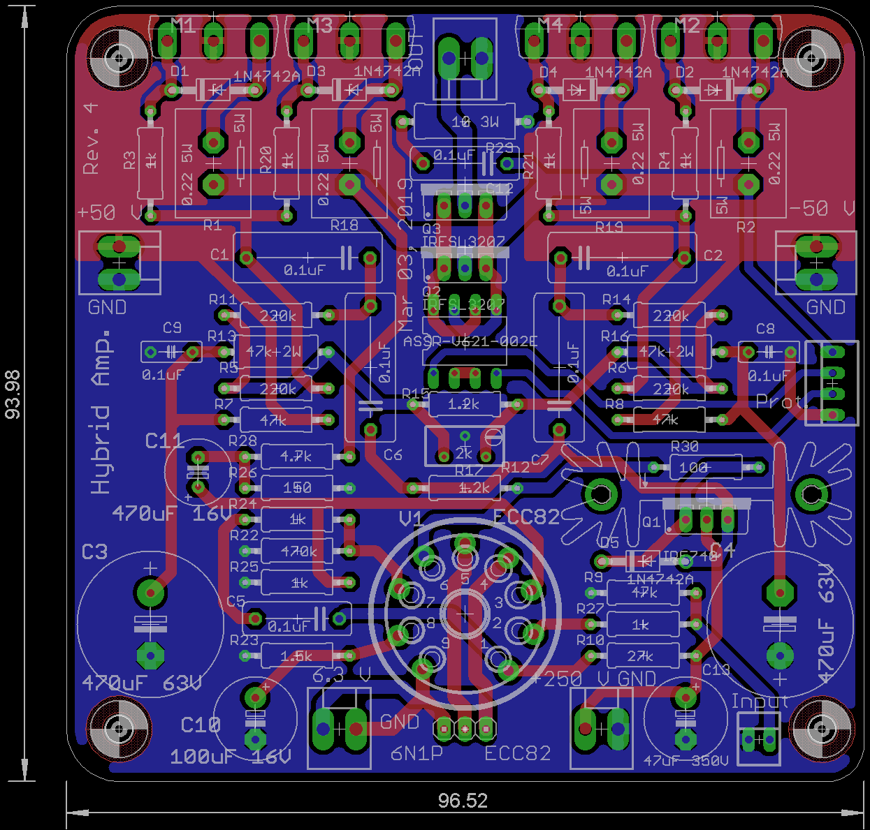

Hi Hugh,
Thanks for your explanations, as you suggest I will keep the schema as it is 🙂 However, I have modified the layout a lot, after a rev. 3 were I modified capacitors pattern to accept bigger size, I finally decided to put the power MOSFET vertically to be able to build the amplifier in a low profile case with the tube mounted vertically, this is the Rev. 4 😀
This give me the opportunity to put larger capacitor and to improve a little bit the layout (don't worry for the PMOS symbol on the schematic)...
In your comment you speak about lateral fets, but I don't think that the IRFP240 & IRFP9240 are lateral MOSFET ?
For the power on thumps, I will use Project16 DC protection logic with power on delay, it will drive the on board solid state relay therefor there should be no problem 🙂
If I don't find any problem during a last check tomorrow morning I will send the files to PCBWay...

You can't replace latheral mosfets with vertical (IRF) in the same circuit. Schematic would need revision, adding Vgs multiplier for thermal compendation etc.
Parasitic gate capacitances of vertical mosfets are also lot larger as their transconductance, so the sound will not be the same.
It's doable but needd revision.

Hi Marc,
Borko is absolutely correct. You can't replace the laterals for hexfets here without considerable revision.
My mistake; I missed that.

Hi Hugh and Borko,
Thanks for the information 🙂
It is my fault, I didn't take care of the fact that the original project used lateral MOSFET
Since the 2SK135 & 2SJ50 are obsolete, I am planning to use 2SK1058 & 2SJ162 which have very close characteristics 😎
I will also use a FQPF2N60C that I have already used in a preamplifier instead of the IRF740, because it has better features, by example a very low Crss of 4.3 pF instead of 120 pF !
I think this will be OK but I will appreciate if you can confirm it before I send the Gerber files to the PCB manufacturer ?

Marc,
Please wait a couple of days while I study your layout. I do this in my morning café but I need a clear head. I have just lost a old, dear friend and I'm very tired at present after a couple of weeks after high temperatures, the weather his year is not good in Oz.

Marc,
I have some information on your circuit. I have discussed it with a good friend as well and we have some agreement on how you should proceed. Don't send off your pcb for manufacture just yet!!
Please email me at aspen01 -at- optusnet.com.au and we will chat on email about your circuit.

Dacz,
After several mails exchange with Hugh, we found that there could be several options depending of the MOSFET used in the driver stage, therefore I have designed two PCB versions to test them...
The rev. 5 is the original version but with a Depletion MOSFET and different possibilities of capacitors / resistors mounting while the Rev. 5HD is Hugh Dean variation with a enhancement MOSFET and a Mu-follower stage.
I am waiting for the PCB to test them 🙂
