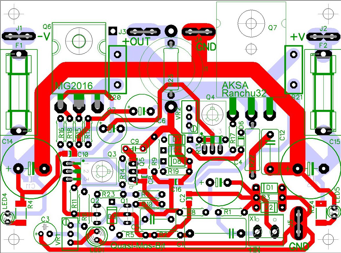

It's far a longue time since i begin to work on this little amp. Recently i take some of my hifi material to my office at work : my Nmos 200 and and my bookshelfs speakers (troels XT25/PL14).

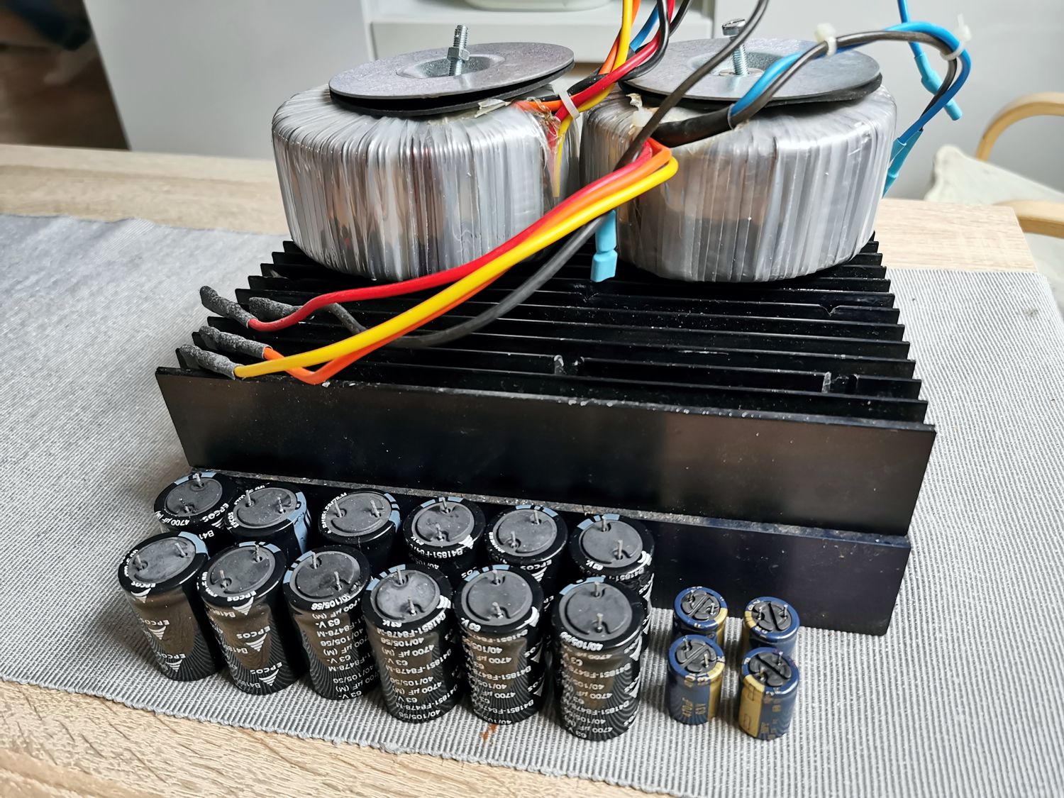

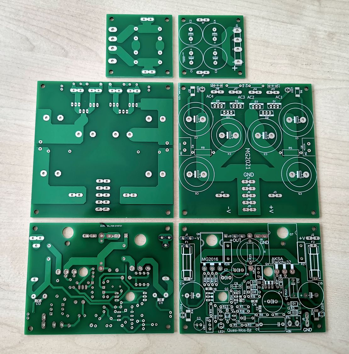

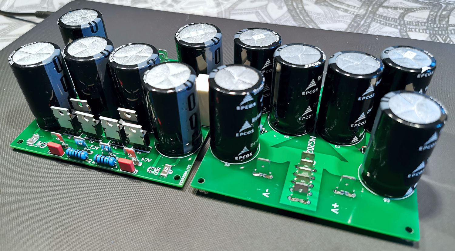

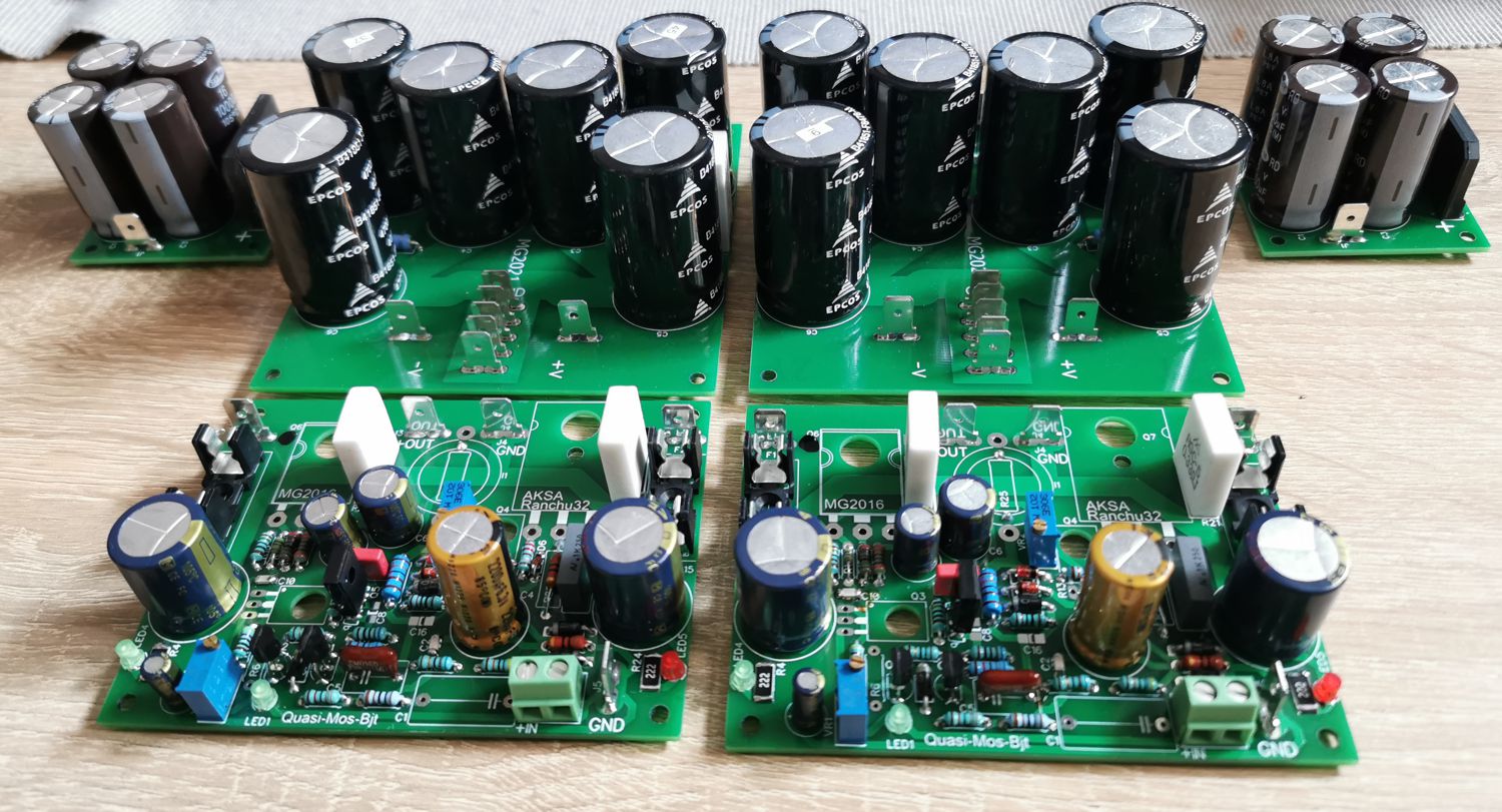

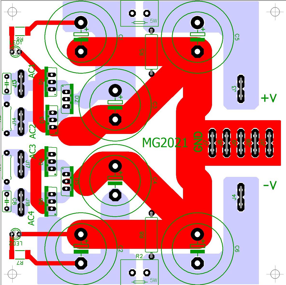

I am building two stands for speakers to have more space bettween them. I have a raspberry music server with a smsl sanskrit 10th dac. Nice sound at all. Quasi Nmos would be a nice amp for my office (20m² room). So i decided to finalize this project. New amp and PSU board are ordered as the lefting electronic parts. For PSu i will use Epcos 4700uf/63V cap (3 per rail in CRC). I have two 300Va 2x25Vac trafo. I will begin with these, may be i will change them later for 250Va 2x30Vac. This amp will be build in smal cubic mono blocs (24x24x24cm). Attach : new amp and PSU board. My quasi will use 2n5401/KSC1845/KSA1381/FQA40nN25/MJL4281

I built this amp with the same transistors. Sound quality and stereo imaging are excellent. I have run it on +-52VDC rail voltage and it runs pretty warm. Also have run it on +-35VDC power supply and it sounds the same but runs much cooler. Either transformer, 2x25VAC or 2x30VAC, should power this amp very well with little to no difference in sound. I hope you already have the MJL4281, they are difficult to find currently.
Nice pcb, Idefix!!

Hello Idefixes
greetings can you please post schematic you are following i would
like to try this amplifier.

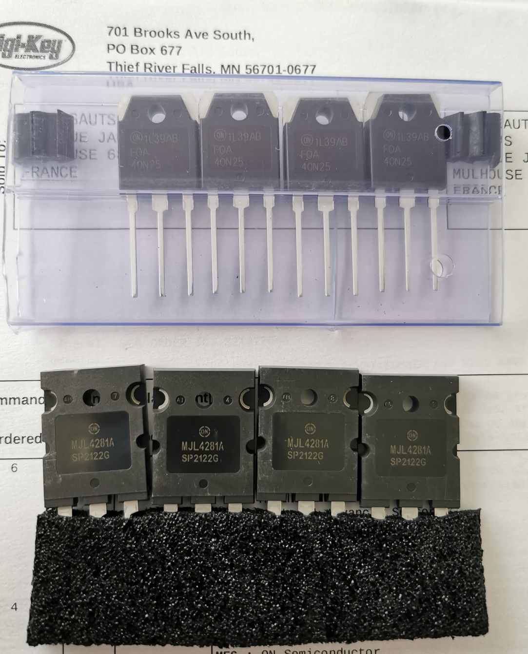

I have some in stock, but i order some more from digikey. They have both FQA40N25 and MJL4281 in stock

Hi Andrew. Schematic is the stock one provided by ranchu in the Rev 2. I will just add as Hugh said inf to 2.2nf between MJL B-C legs.

Some parts taken out from my stock : 2x 300Va 2x25VAc trafo., 2x heatsink (230x195x40mm) that need some cleaning job and spraypainting to be ok for project

Electronic parts from TME and Digikey, and PCB from JLCpcb are on the way. Next week i will cut my wood part for casing. I think i will paint them in glossy white with somme black touch (push button, speakon connector, air grill out take, ...)

When I suggested FQA40N25 and MJL4281A they were relatively inexpensive.
Since Covid however availability AND cost has increased a lot in just about everything from Digikey/Mouser.
