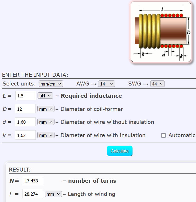

For 1.5uH with 1.2mm wire, you'd need 5mm former and about 25 turns.
But for this amp it's not critical at all, it's very stable.

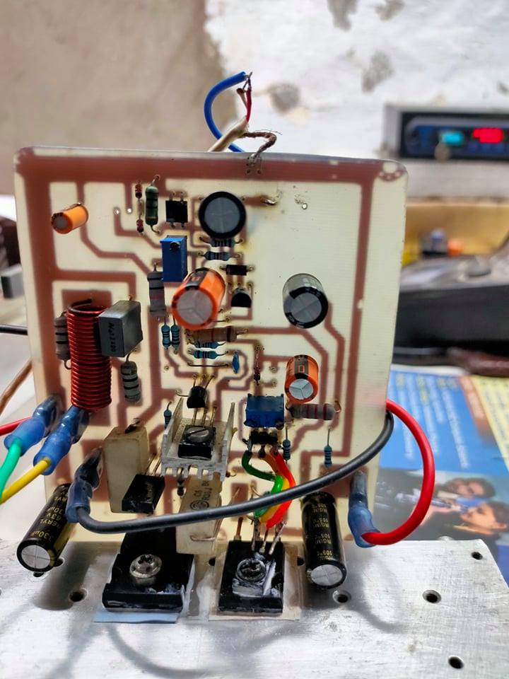

Idefixes,
Your build is coming along nicely!

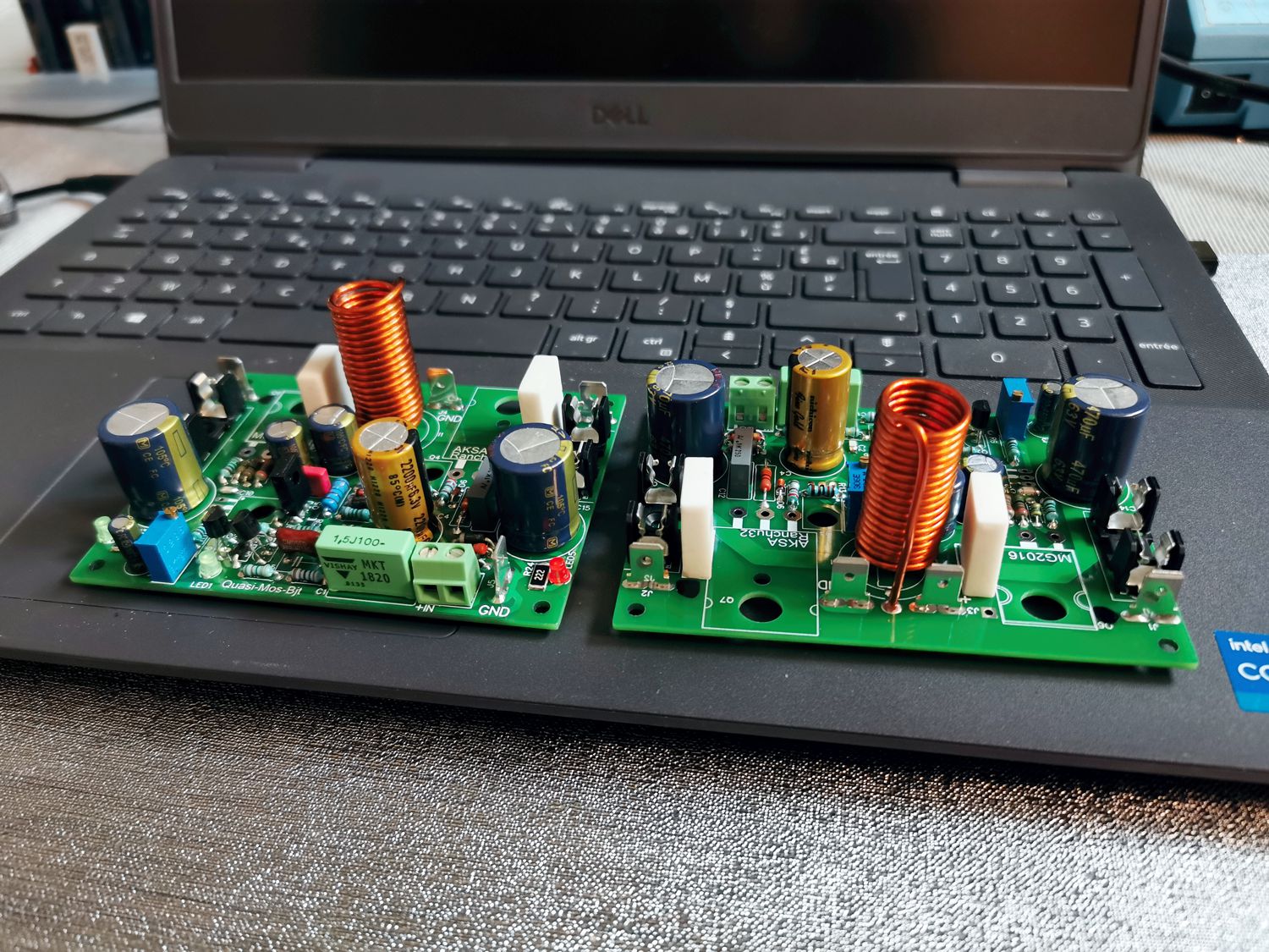

Hello ideafixes
greetings i have been wanting to make this amplifier on your pcb i
see a 2200uf 6.3 volt cap but in the schematic there is no such value cap
please can you help.
warm regard
Andrew
warm regard
Andrew
Hi Andrew,
i have a bunch of these cap in stock from VSSA project. It's C4 in schematic. In the thread you will find value from 100 to 2200uf for these. I have these fine gold in stock so wanted to give them a try.
Marc
