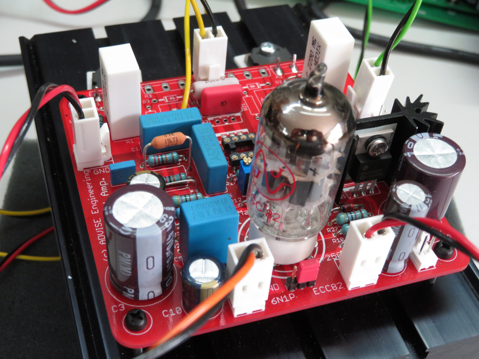

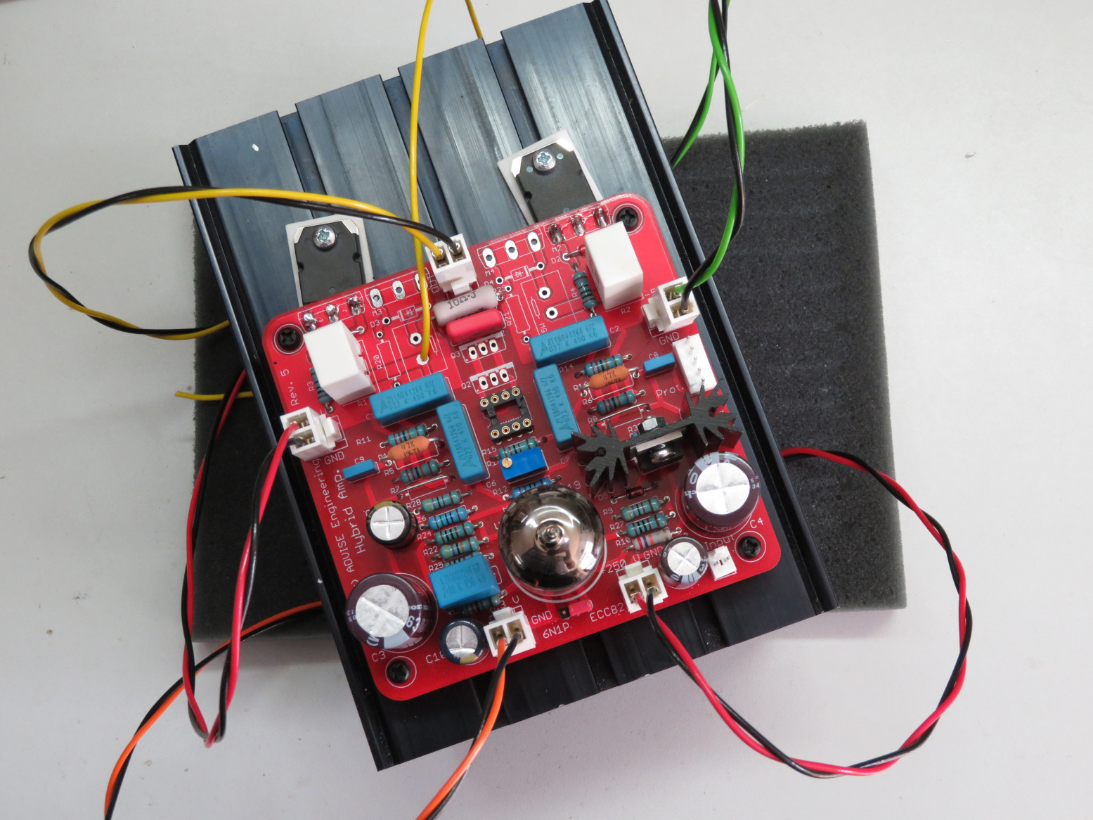

I have been quite busy these weeks and my projects did not go as fast as I would like 🙁
I have finished the assembly of the Hybrid amplifier but not started the test yet, just to keep you updated I have made 3 pictures of the amplifier... As I have already said, I will start a new tread when the test will be done 🙂
Ciao,
Marc

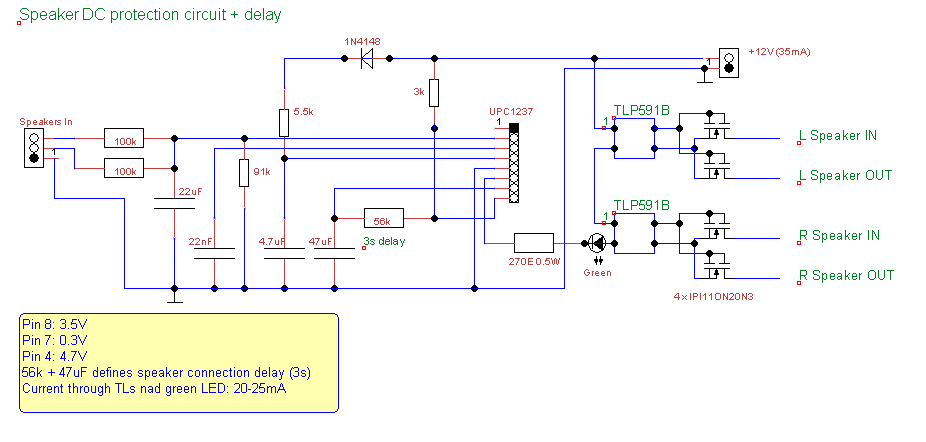

Had a fake output transistor on the amp that I build for my son in law. One channel went BOOM, luckily I had build in DC protection, so no damage to the speaker , but their cat jumped from the second floor of their house ! Luckily it survived with 8 lives left. he is used to NAD stuff but likes the amp a lot !!
What is the protection that save your speakers😱
[ The IPI110N20N3 has a dual-gate MOSFET symbol! ]
I note that circuit combines left and right before detecting, so its vulnerable to a mode where one output goes high when the other goes low (only plausible in a bridged configuration I think, and pretty unlikely anyway).
Yes Mark, highly unlikely, lets hope so ! I have used 2 single fets, the problem I had was with the UPC ic. I bought 5 of them and only 2 are working as they should. The other 3 are too slow to trigger, so they went to the dustbin. It was E-bay IC's , that''s why one has to test them, one can only hope and pray they do the job when it is needed !😱
