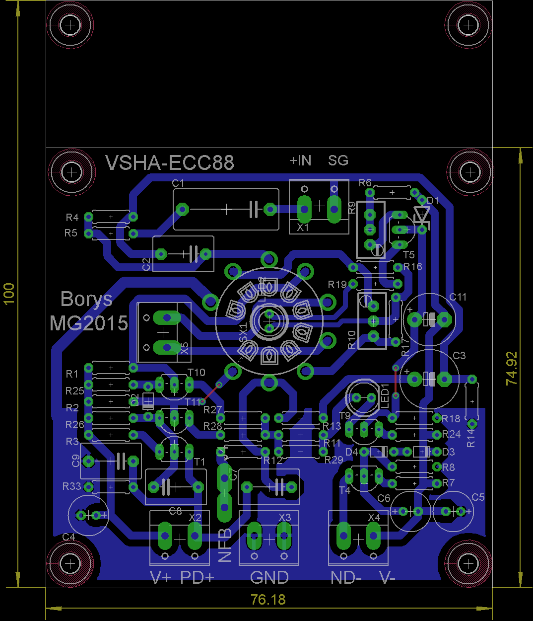

All looks fine but C9=100pF is not required, I left the room for it just in case some tube have too much gain. Bellow is my schematic to compare. R6=470R can stay, it does not matter much. I have added LED under the tube socket as an option, there will be approx 5-6mA flowing threw it so it will nicely light up the tube (like in pic bellow), I am using two SMD LED's there.
I know about C9, i just let it in case of. I will add le led too.
Marc
Here are the layout with led add on

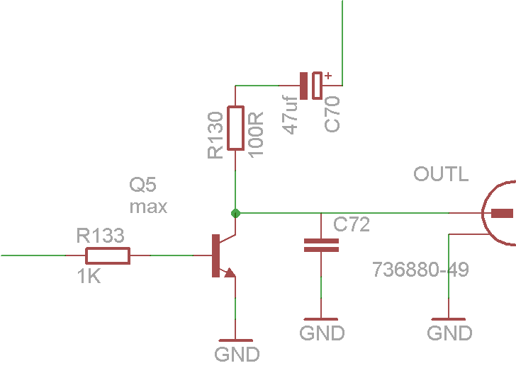

You can putt the diode network to protect the card input - they will clamp the voltage to certain level - like in gates in mosfet amp.
i think you misunderstood this.
The damaged transistor is at LINE OUT not at line in,this is strange

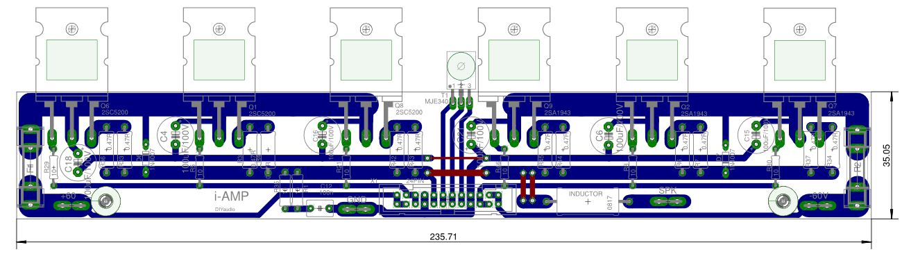

I decided to make a prototype based on picture you posted (some Pass amp I think), hope I will not blow up the lab.
The most fun is to discover new thihgs, learn and in some cases watch the tubes/LEDs gloving 😀
Binely
You can make ''any'' amp with the slewmaster, You can get chassis,PSU and heatsinks ready and than just swap some IPS around, it is really cool idea.
