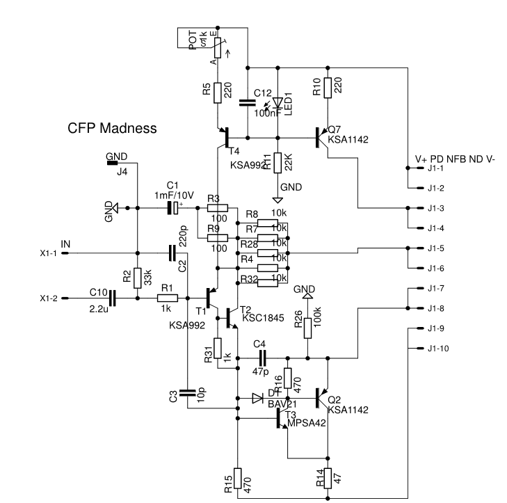

Another good suprise IPS is CFP one, only 6 transistors with singleton input. Plays lovley. I was going to putt the servo into it but Valery came up with some better idea so i have adopted it. Offset is not so bad, sound is really nice. Schematic bellow.
I agree. I built this little postage stamp IPS. Very nice
Where we can find this IPS pcb?Another good suprise IPS is CFP one, only 6 transistors with singleton input. Plays lovley. I was going to putt the servo into it but Valery came up with some better idea so i have adopted it. Offset is not so bad, sound is really nice. Schematic bellow.

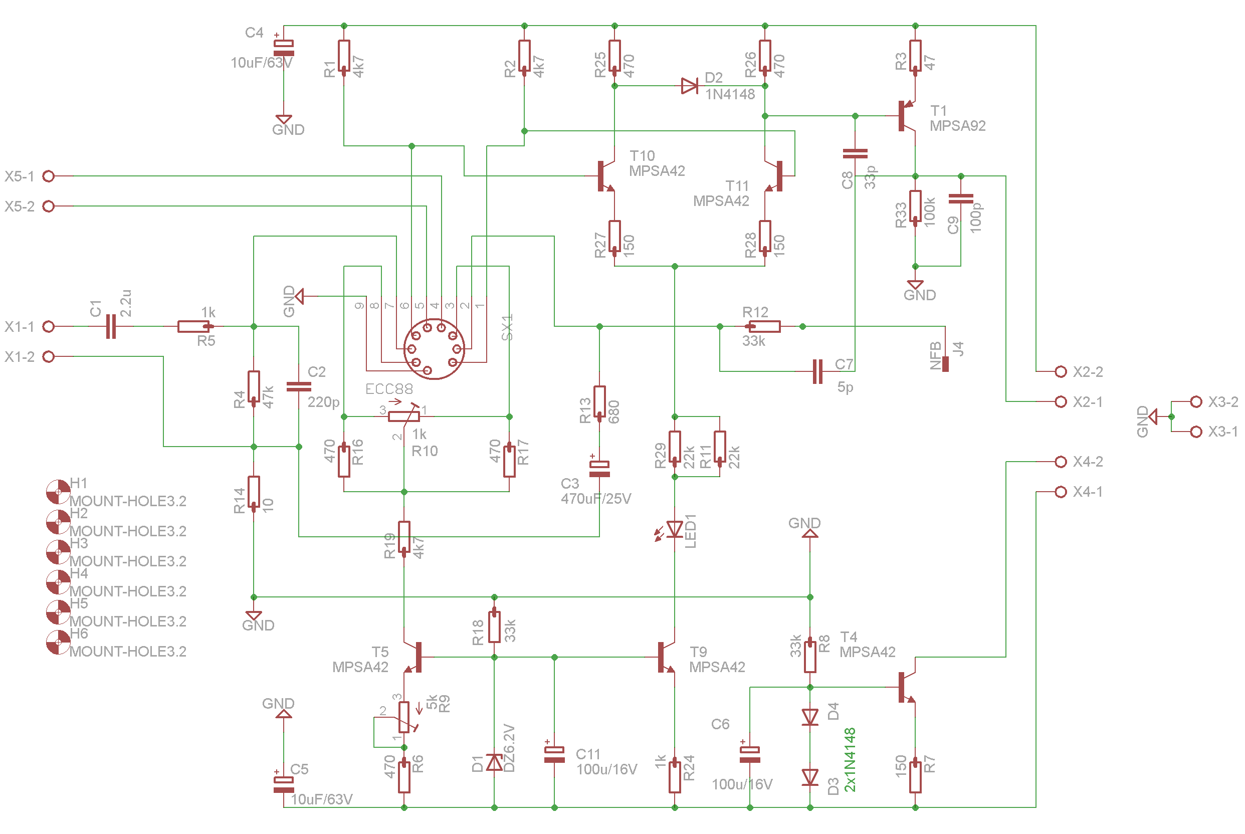

Hi Peter,
My tubes arrived for the ECC88 boards. They are the 6N1P tubes. I'm looking back through the thread and I don't see instructions for setting R9 trimpot. Can you explain that for me please?
Thanks, Terry
Thanks, Terry
Thanks, Terry

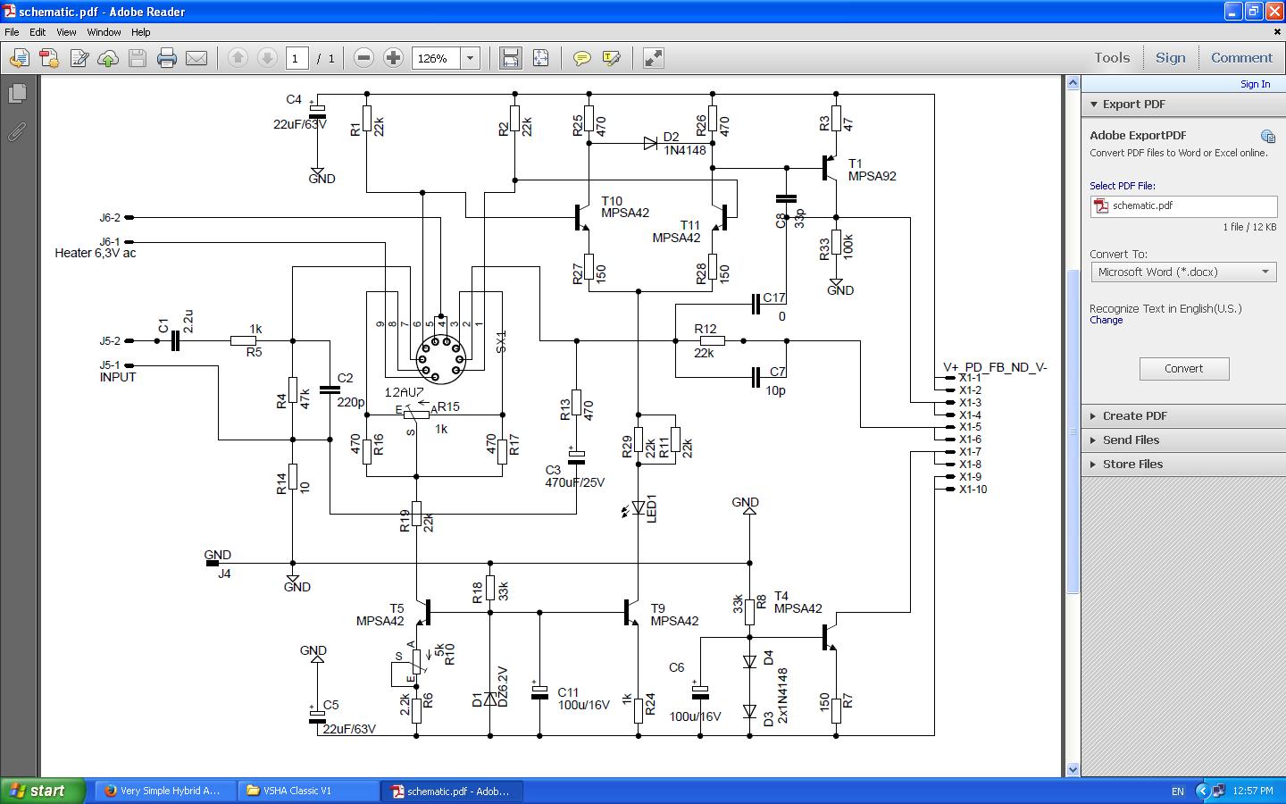

I found it is difficult to set DC Offset in simulation. First, I set R9 to get minimum DC Offset, but some value the DC offset can go as high as PSU voltage.
I'm using this schematic. I think R9 sets the current and R10 sets the offset. One board is working OK but the other is not.
R9 sets the I cathode and R10 the out offset.I'm using this schematic. I think R9 sets the current and R10 sets the offset. One board is working OK but the other is not.
I tried two tubes.One used 12AU7 and one new ECC82.Using the 12AU7 i ended with 33mV offset,Using ECC82 the offset it is possible to trim at 0mV offset.
My board is according to previous version.
Hi Thimios,
I already have the original boards working perfectly. These are the ones designed for the ECC88 tube. What I want to know is how to set R9. I don't know where to measure and what voltage to set it to.
Measure cathode voltage..It the is point connection of R10 R16Hi Thimios,
