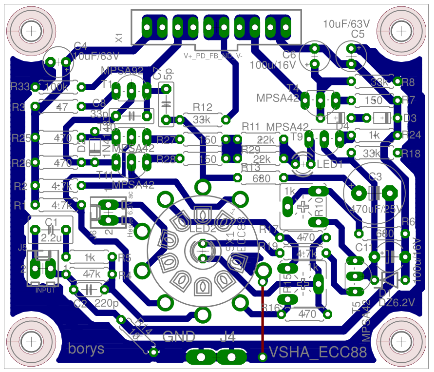

Ready to do some drilling. I don't have any ECC88 tubes yet so it will be a few days before it will be ready to test.

gaborbela
Please use 0,6W metal film resistors, few of them are dissapating around 0,2W. The metal film ones are more realible. I have damadged a very nice speaker after a small carbon resistor failed and full DC went into the speaker. Since I am allways using a speaker protection.
As far I remember you have a good few nice toshiba mosfets, It would be a perfect match to the tube.

Which resistors are dissipating over 1/4w? There is I no room for 1/2w resistors on this layout. On the 12AU7 boards I didn't notice any resistors getting warm.
Marc

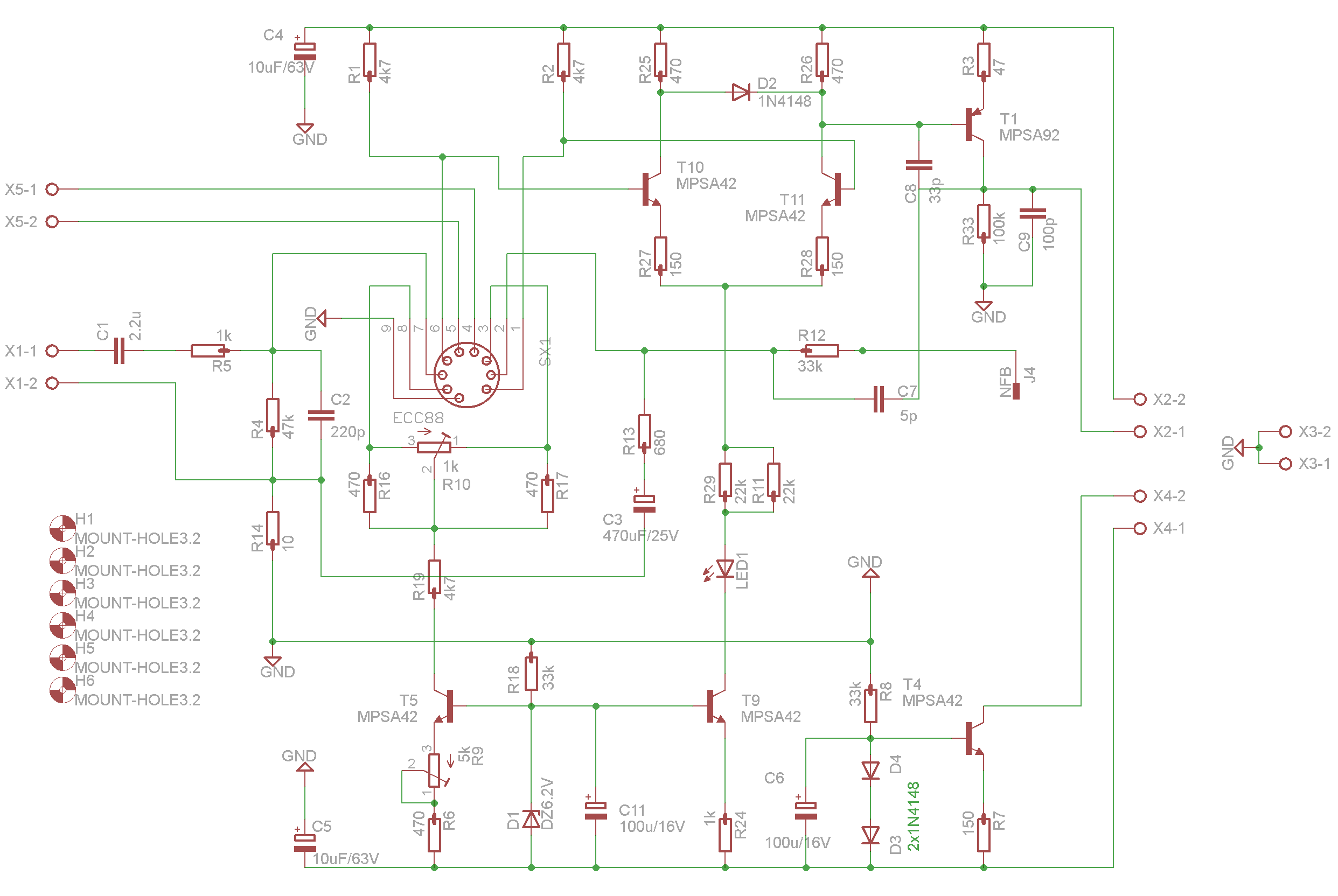

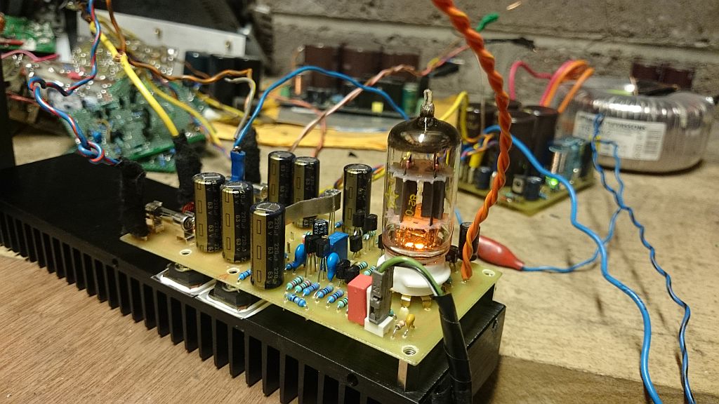

All looks fine but C9=100pF is not required, I left the room for it just in case some tube have too much gain. Bellow is my schematic to compare. R6=470R can stay, it does not matter much. I have added LED under the tube socket as an option, there will be approx 5-6mA flowing threw it so it will nicely light up the tube (like in pic bellow), I am using two SMD LED's there.

There are:
R29,R11 = 22kR --> I putt there two resistors just in case, both of them dissapate around 0,25W alltoghether so it is safe but since I have burned a nice speaker I am not using carbon resistors anymore. 1/2W resistor looks exacly the same as the 1/4W, metal film resistors have higher rating (raster is same 6,3mm or 7mm).

Hi Peter,
So that I'm clear, R29.R11 only see 1/8w each? I only use metal film resistors except for some higher watt values. I now see that some .6w resistors are smaller footprint but I don't keep any of those in stock. I will hook up the VSHA today and measure the dissipation of all the resistors and see if any are too high.
Thanks, Terry
