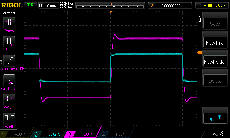

Bass is promissing but trebble is gritty and this is more noticeable at high volumes.
I have distorted squares at 40khz so I believe I have oscilations in the input stage.
Will try a different voltage reference in the ltp cascodes now
I now connected the voltage divider that serves as vref for the ltp cascode to signal gnd instead of the sources of the jfets.
During power on, initial voltage rise at the output is now limited to 1.5V (before I registered power on voltages around 30V).
Offset settles at 2mV after 30 min (it follows temperature)
Now I do not have the serious distortion previously seen at 40khz but there is an initial rise in the square, seen at all frequencies.
What should be the cause of this ?

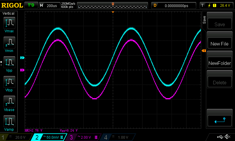

what is the 1khz sine wave look like at 2.6v ac output into 8 ohm loads in your scope?
It looks like a sine without distortion
good, this is one of those things you want to check in a newly powered amp...
check and watch out that no drivers and outputs are overheating.....
what is the sine look like at onset of clipping?
It clips at 37Vrms with 1.5V input at 20khz... seems correct in the bench.
