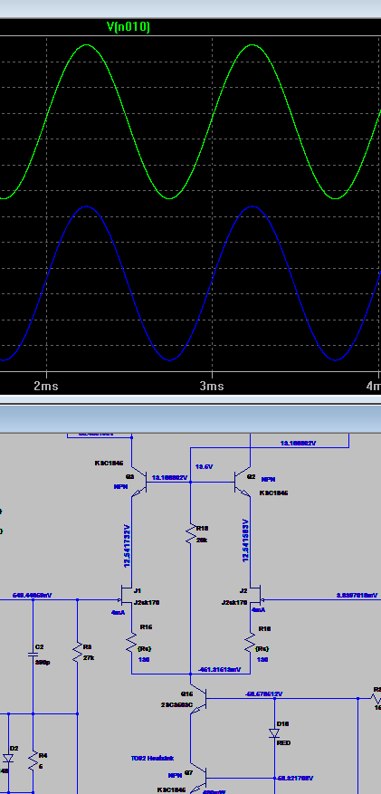

Increased input jfet Rs from 22 to 100ohm and now the amp starts to sound correct.
I will now reduce global feedback because with 22k FB resistor it sounds anemic.
Also will reduce TMC resistor from 2k2 to 1k8 to have better grip in the bass.

reduces the open loop gain and thus reduces the feedback. Makes for slightly increased stability margins.Increased input jfet Rs from 22 to 100ohm and now the amp starts to sound correct.
This could reduce the stability margins. go too far and you could go into full oscillation.I will now reduce global feedback because with 22k FB resistor it sounds anemic.
This sounds like guessing !Also will reduce TMC resistor from 2k2 to 1k8 to have better grip in the bass.
Not really, I already listened to several combinations.
Increasing the TMC resistor makes it less aggressive so sound looses snap.
Reducing the resistor increases snap but can also increase treble edge so 1k8 seems to be the best compromise right now.

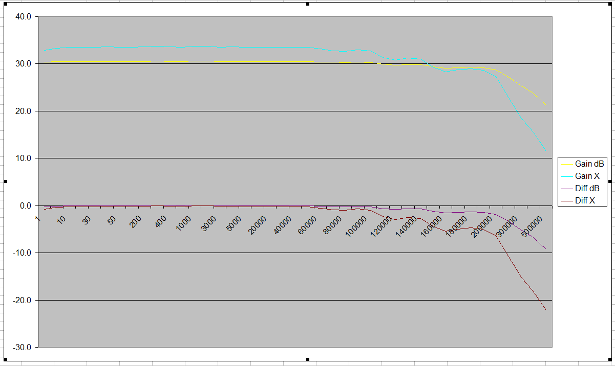

After several experiences I settled for 27kohm feedback resistor, 100ohm source resistors in the LTP jfet, 220ohm resistors as emitter resistors in the LTP mirror, TMC 100, 1k8, 500.
Gain is 30.5dB at 1khz in the Right channel that presents a perfect response curve flat to 100khz.
Sound is detailed and smooth... very good.

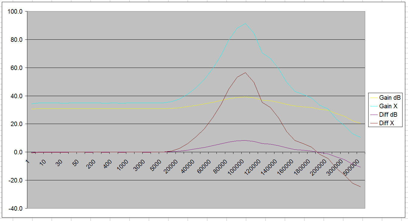

Now the Left channel is built exactly the same way but has a troubling anomaly.... The response is not linear and peaks at 100khz with 39dB.
As gain is controled by the feedback circuit I am wondering what component might be causing this.
Please verify the response curves ... hope someone can help me debug it...

try checking the colours of the resistors for a wrong component.
Then measure each one, but this often gives low reading due to a parallel leakage of test current.
Then try checking all your installed capacitors.
And check the Zobel, for a failed resistor and/or capacitor.
There is a tool to check capacitor in circuit ESR. Useful in case there is a failed capacitor.

During my initial experiments in the "wrong" amp, I experienced oscilations and the zobel resistor heated a lot.... will replace it along with the partnering cap.
I tryed to simulate this behaviour and the better aproximation is putting a large cap (2u) on the output... this produces a rise in gain near 100khz, but I do not have a cap during my bench measurements.
Another way to emulate the issue is using an inductive resistor for the feedback but in this case I need at least 0.1H to have this rise in gain at 100k, so it can not be the 27k resistor I have.
Do you believe a faulty transistor in the VAS or LTP might produce something like this ?

Replaced the zobel and now everything measures normally.
Thank you so much Andrew.
Now these amps sound big, fast detailed and sweet.

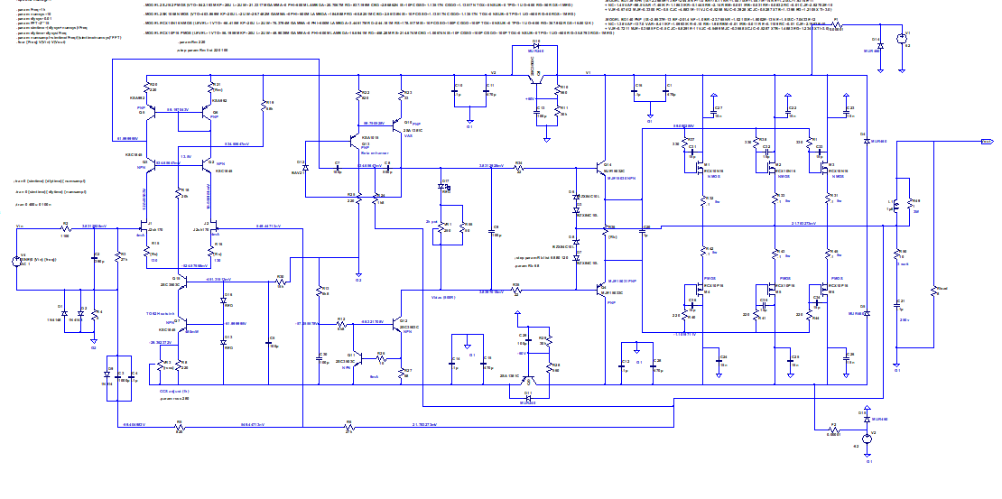

Good job, it sounds like a nice amp. At least we didn't get bogged down discussing the merits of 20 different kinds of cascode...

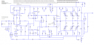

New improvements where done... please look at the new CCS in the IPS.
Droped the VAS active clamp.

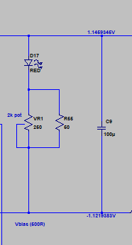

Mosfet Bias now uses a LED for stiffness.
R18 does not have a bypass cap (It was responsible for a large offset)
All lateral mosfets have a Gate to Drain 15p capacitor that prevents oscillations.
Gate resistors have now different values for N and P devices.
IPS degeneration resistor where substantially increased.
Important considerations:
IPS cascode transistors base voltage is obtained by a voltage divider that is referenced to the jfet IPS degeneration resistors so the cascode reference is an in-phase replica of the feedback devices collector signal.
As I am using Lateral Mosfets that have a negative tempco after 150mA bias, thermal stability is assured so I do not need a Vbe multiplier to bias the OPS.
I am now using a resistor + LED arrangement. It is stiff and more linear than the typical bjt Vbe multiplier.
Must study this arrangement because in case of over current the LED will open and the OPS current will go sky high.....
