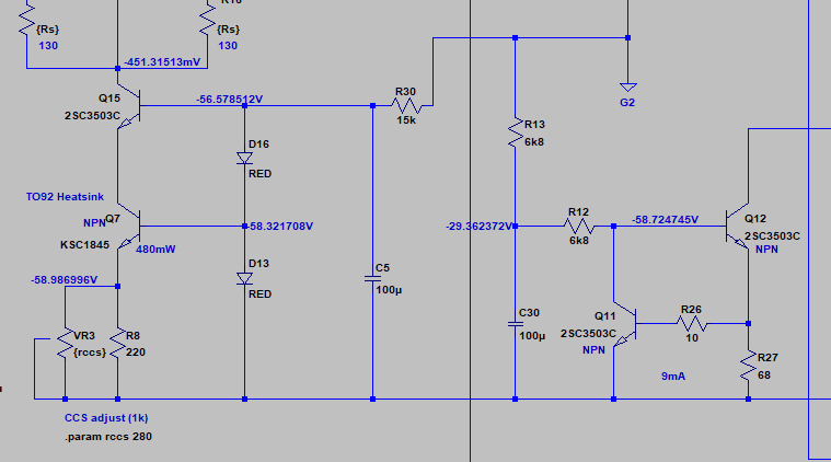

The IPS CCS is now cascoded to ease dissipation on the CCS controlling bjt Q7.

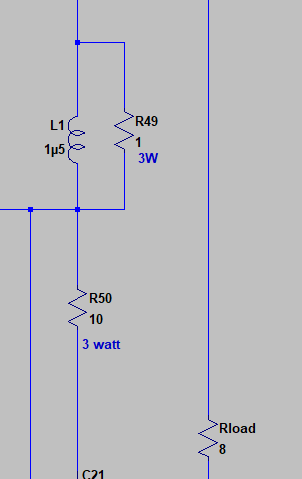

While testing the amp with a 2uF cap over the 8ohm output load I noticed severe ringing with a 20k square wave .... I am now aware it was the cap resonating with the output coil... so I reduced the output coil resistor to 1 ohm.
Maybe I should reduce it to 0.33ohm but I am not sure this is a good move.

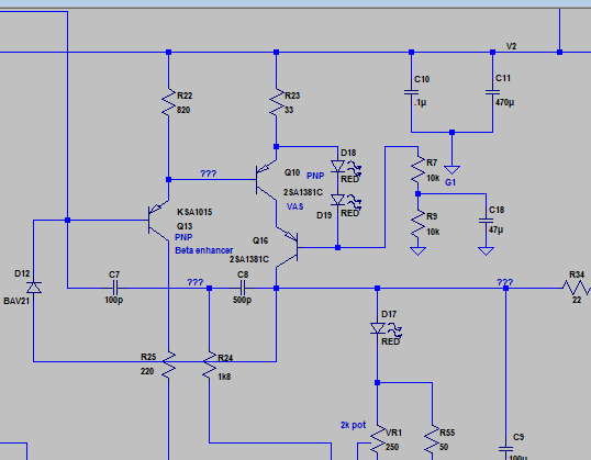

Simulation using a Hawksford cascode VAS does reduce 2nd harmonic considerably but as I am not using higher rails for the VAS, I will not use this method in order to maximise output swing.

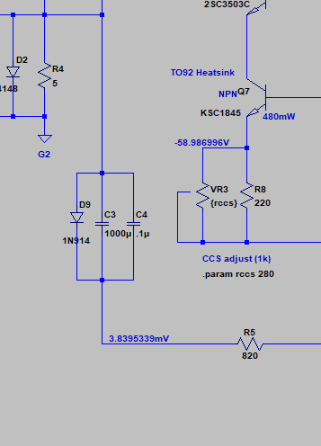

Still have doubts regarding an implementation suggested by Andrew...
According to his info I should place a diode over the feedback capacitor.... I guess that technique is used to limit the voltage seen by this cap so one can use a smaller lower voltage cap there ... but I am using a 1000u 25V bipolar in that placement so maybe there is no need for the diode.....

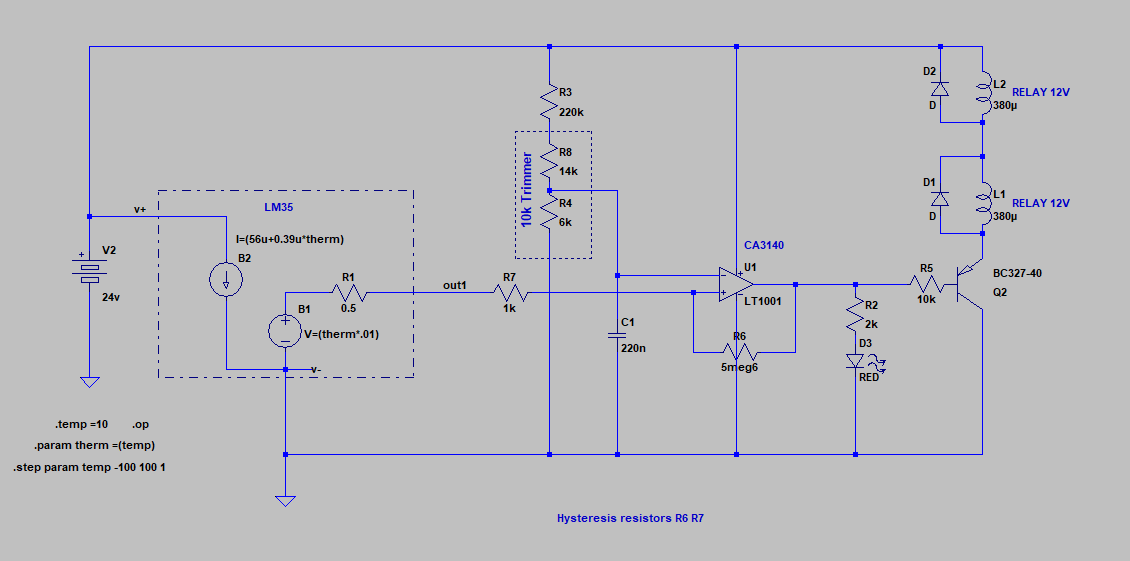

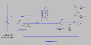

The amp does now have a softstart, a DC detection circuit and a temperature controlled relay that shuts it down if the heatsinks go higher than 70°C.
I also need a short circuit protection but do not like the typical current limiting circuits available so I asked Bonsai and he suggested the circuit present in his ovation e-amp that I am now studying.
The temperature control uses a LM35 and a CA3140 comparator set with slight hyteresis....

if you have 10r in parallel to the output inductor and there is an HF signal passing to the load, then the inductor presents a high impedance and the 10r becomes the load.
That 10r load is in series with any capacitance either in the cables or in the speaker.
The PCB located Zobel (possibly 10r+100nF) and this extra 10r+?nF are effectively in parallel.
Thus the amplifier sees an HF load of 10r||10r, i.e. 5r
If you lower the inductor damping resistor to 5r, the amplifier now sees a 10r||5r = 3r3
Lower it to 1r and the amplifier sees 10r||1r ~ 0r9
Can you output stage drive sufficient current into this lowered load?

thank you Andrew.... now I see the issue
