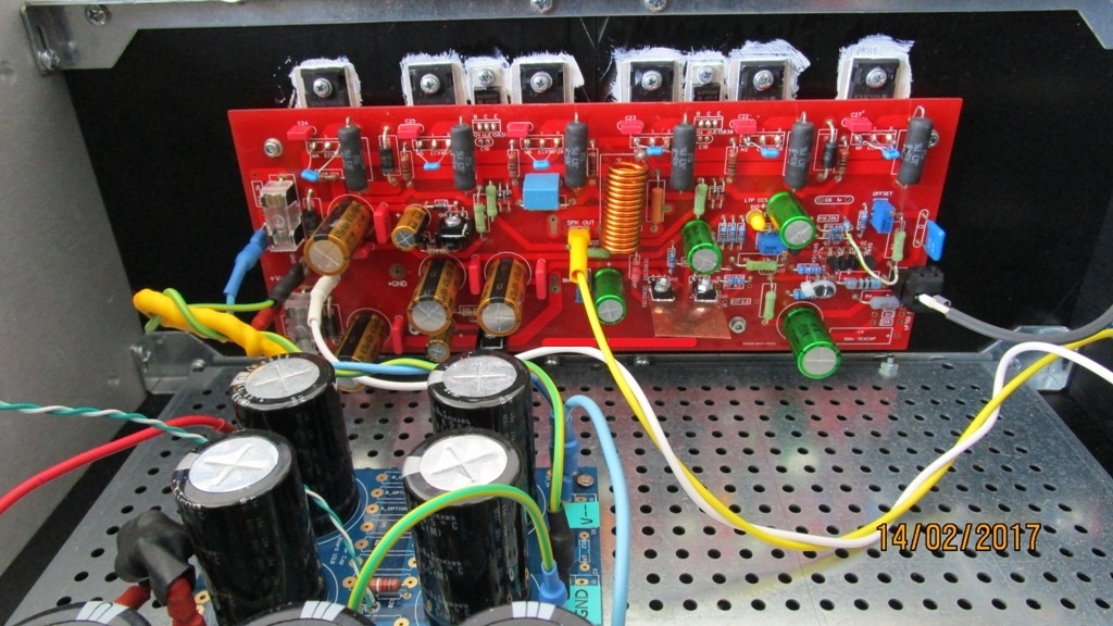

After increasing the gate to drain caps placed in all output mosfets the amp became stable and now I can play it loud (really loud) with all the input preamps I have available.
Sound lost all traces of sybilance and bass remains deep strong and detailed.
I will now build the second amp so I can listen in stereo and will play with compensation until I find voicing suitable to my system.
Off course the new board will have all mods suggested by the group.
Soon will report back with new subjective listening impressions.
Look at the blue bugs on the mosfets

Just finished second board including mods as suggested and it worked right from the start.
Stability is no more an issue here.
Although it sounds fast with really good bass, the highs are slightly forward so I would like to reduce those.

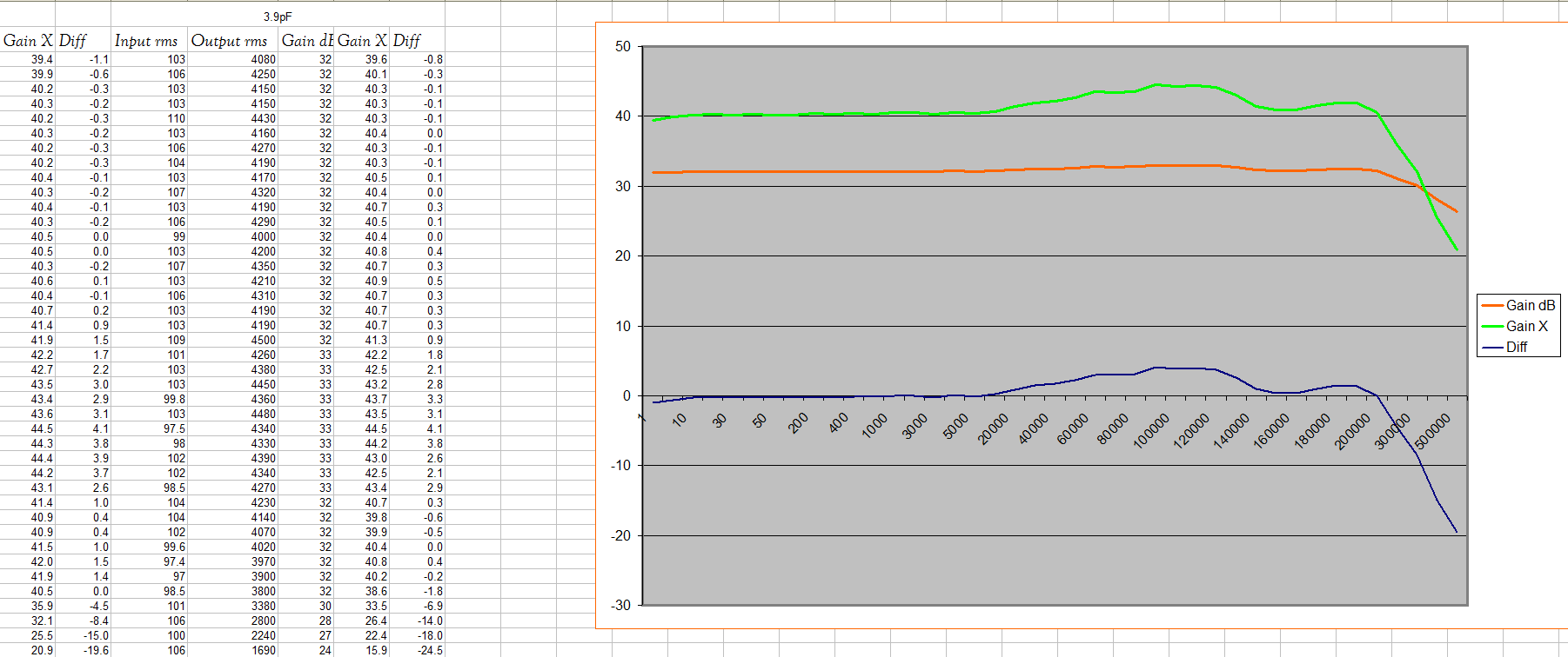

I made some measurements that indicate a rise in gain starting at 10k... not fenomenal but enough to be heard.
Gain is up for 1dB at 20k and 3dB at 60k.
Can I reduce high freq gain by using a cap over the FB resistor ? IMO it can increase FB at high freq so gain will be reduced but will it create instability issues ?
Funny you'd mention that -- I just experimented with this in my Honey Badger today. The gain is flat with my Honey Badgers, but the sound changes quite a bit if the "LC cap" is added across the feedback resistor. Without the cap, the sound is very lively, but also a bit on the "bright" side. If the cap value is too high (5pF or more), the amp sounds boring. For even bigger values, the whole things starts ringing and oscillating, resulting in smoke and blown fuses. Oh, and the square waves didn't look the same in simulation and on the scope (so I just ignored the simulation). Conclusion: just give it a try, start with small cap values, and check the result on a scope.
Yes, you can. It's a very standard stabilisation technique. Small values of capacitance will have a big effect in this spot, as they're effectively multiplied by the gain of the amp.
