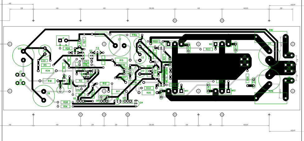

Finally some work done in the layout.... would apreciate your comments.

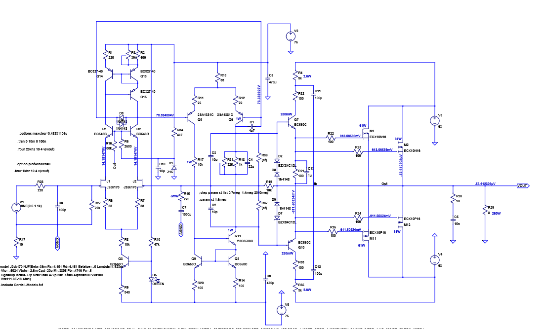

The layout corresponds to the latest sch where I modified the ltp ccs and mirror.
The vas mirror was also modified.
Some caps where added and now the IPS works at 75Vdc while the output at 63Vdc.
  • P300 layout.pdf

  • P300 sch.pdf
    P300 sch.pdf
Well, besides the obvious supply traces, I am not sure the usual custom of doing a ground plane is necessary or even useful.
Larger traces mean less resistance, so after I finish a pcb design I go over the whole design again widening the traces I did, and sometimes filling the empty areas with copper from whatever is closer. So I end up with a large copper surface cut by 1 to 2mm "streets" or "rivers".
That allows different position or size for passive components, or even using SMDs or through-hole if you prefer.
When I started doing this I asked around to professional pcb designers, and there was nothing against that, on the contrary.
But maybe someone here has a different opinion here that I would love to listen to.
