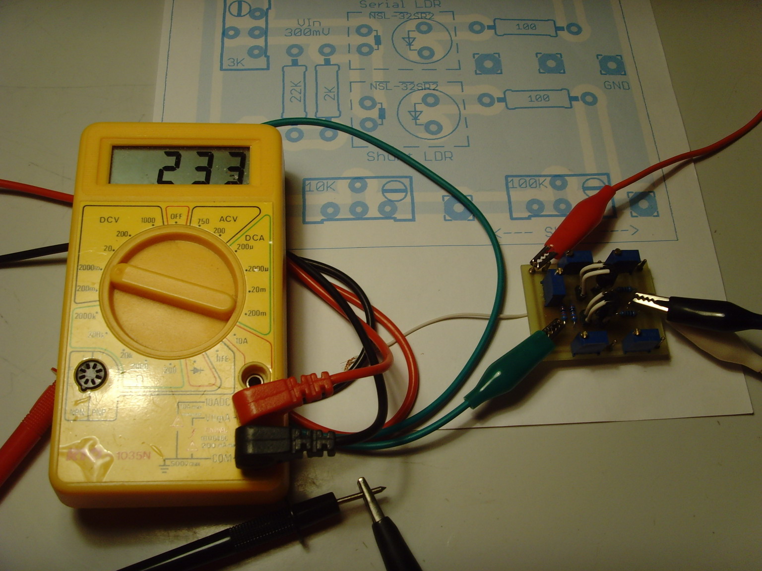

BillyK, I have just calculated the price of Uriah's offer:
35$ for 4 matched LDRs + 10$ shipping to Germany + 19% VAT = 54$ (= 41€)
This is very much!

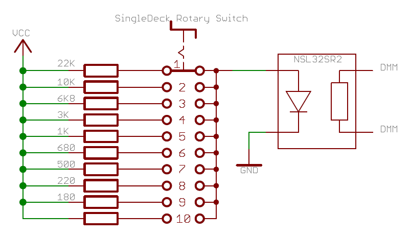

I will therefore offer you to match the LDRs myself.
I will ask 25€ from each of you, who calls for my service, order as many LDRs as possible from FARNELL (an LDR cost 2.09€) and match them
using my test-rig (see attached image).
I will match the LDRs as accurately as I can, but will not sit in a hermitically sealed room, will touch the case of the LDRs with my fingers,
smoke a cigar and drink a whisky.
Tell me, if you like my offer and / or want to improve the test-rig.
Best regards - Rudi_Ratlos
P.S. I will check once more, if the resistor-values - as shown - make sense.

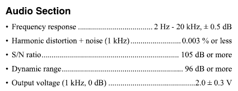

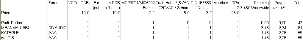

Gentlemen, I have just gone downstairs, listened to a CD and adjusted the volume to a level that was pleasant in my ears.
I then switched the amplifier and VCPre off, removed the motorized potentiometer and measured the value of its 2 sections.
I am using a YAMAHA-S300 CD-player that gives an output-voltage of about 2V.
The measurement of the 100K dual potentiometer shows 81K on the series-LDR-section and 9K on the shunt-LDR-section.
I could not believe and reproduced this situation on another LDR-test-rig, feeding it with a 2VDC signal.
The result: the output of the LDR attenuator shows a value of 230mV.
Multiplied with the total gain of my FC-100 amplifier, this amplitude is big enough for pleasant listening.
The usage of the resistor-values shown in my post above is not appropriate then, and I will change and use much higer values, when I match them.

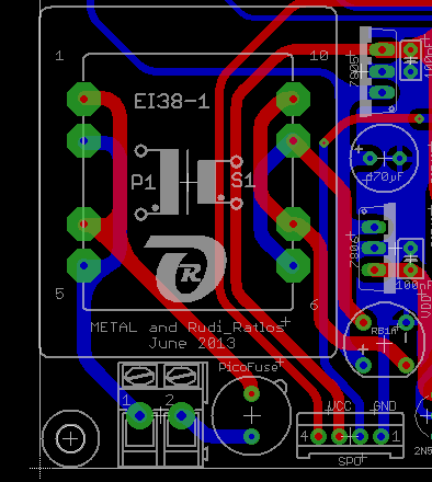

I'm in for one too, all except the transformer (that was the final decision right, 120v people get an off-board transformer?).
No AFAIK the PCB was changed to be able to use 120 V transformers. I think you have to find one in the US with the right pinout. Look for a EI38 (3,2 VA ) type with 7,5 V secondary winding.
this is the pinout:
http://www.jesiva.com/pdf_upload/EI38-14 3_0.pdf

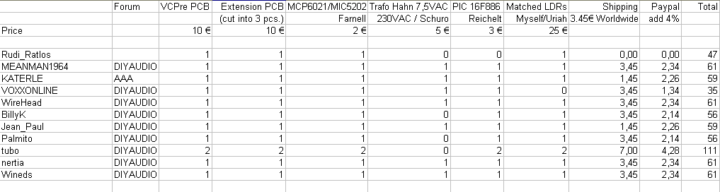

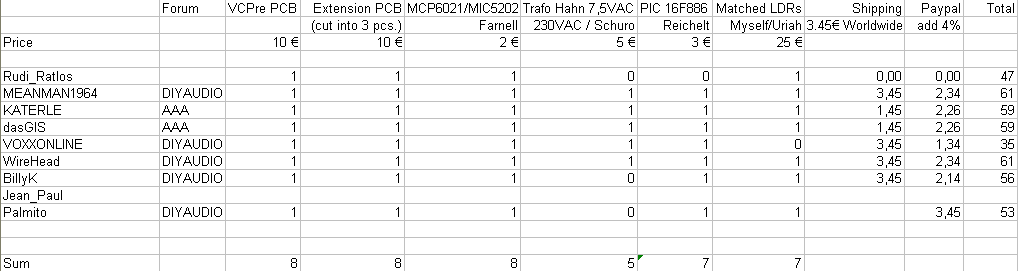

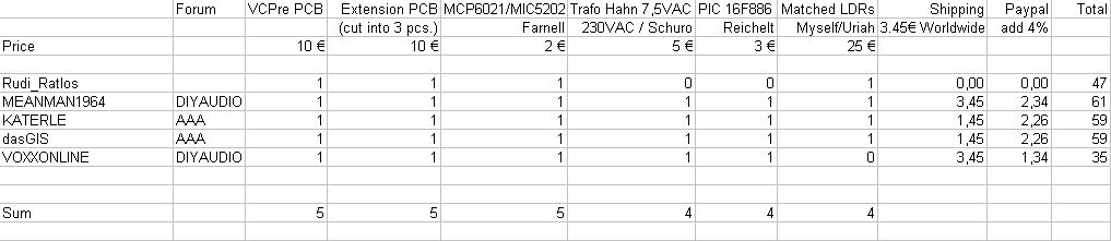

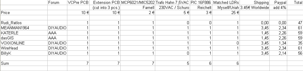

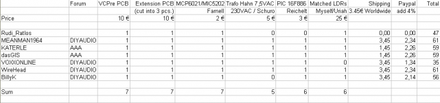

Gentlemen, find attached the current order.
@tobu: maybe your letter weighs more than 500 gr. That is why I have accounted for 7€ shipping in your case.
I will of course refund you the surplus, if not needed.
@palmito: look at how I wired the transformer. I paralleled the input and output to support a transformer like this:
AVB3.2/2/9 - BLOCK - TRAFO, 3.2VA 2X 9V | Farnell Deutschland
having 2 x 115VAC as input and 2 x 9VAC as output. If you know an American transformer brand with EI38 core (have a look at Jean-Paul's PDF)
and 115VAC input and 7-8 VAC output rated at about 400-500 mA, I will remove the dual / paralleled tracks.
