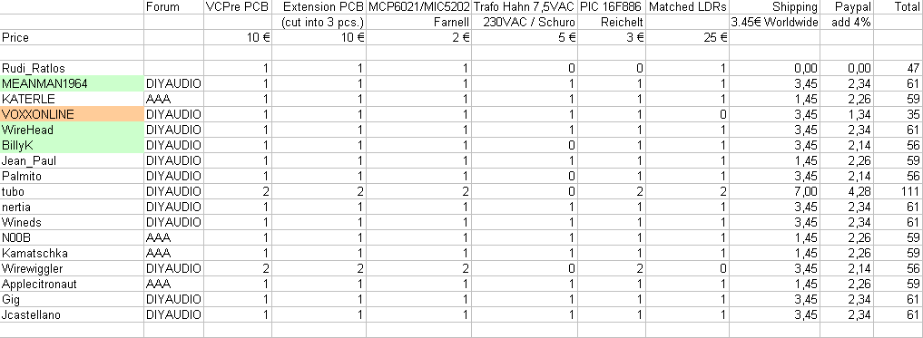

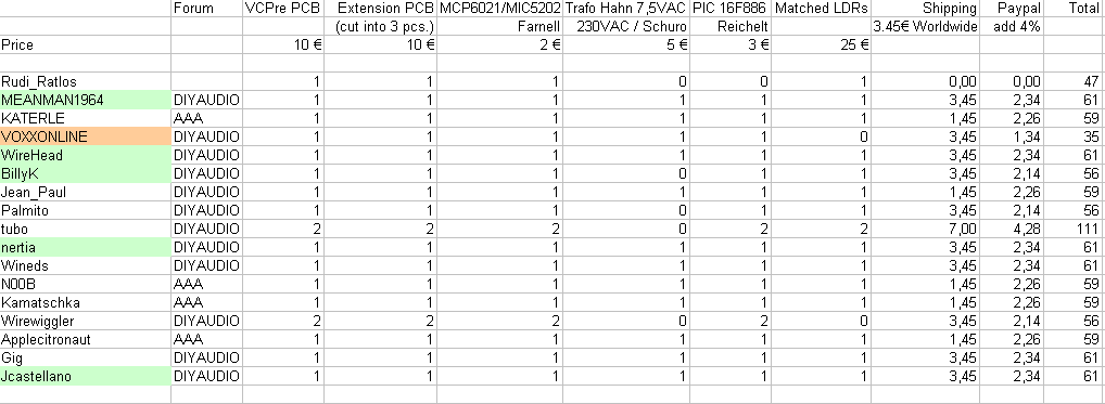

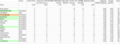

Count me in for a complete package
Billy: you are the 1st one to pay. Thank you very much.
Best regards - Rudi
P.S. You need not be excited! Lean back and watch the stories' growth!
By the way: I have "outsourced" the job of matching the LDRs to "Mr. LDR" himself!
He has of course much more experience with LDRs than I have and will provide you with perfectly matched quads.

@Palmito: Maybe it is best for you to wait for the 2nd round of this group-buy. I will start it when I am back from holidays,
in the 2nd week of August.

Jorge, you are in!
Gentlemen: thank you for your payments.
Best regards - Rudi_Ratlos
