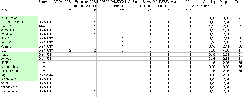

Jean-Paul: I have received your money transfer. Thank you.
The only change that is planned for the 2nd - round PCB is the replacement of the transformer.
I will use the TAMURA 3FD-316 in the 2nd round to support both 115 and 230 VAC primary.
I hope that it does not sound worse than the BLOCK transformer that I am using currently. But since you recommended it ... 🙄
Best regards - Rudi_Ratlos
Bill: I have put your name on the list for the second-round.
I will ask michielbeijer to join the 1st round.
Best regards - Rudi

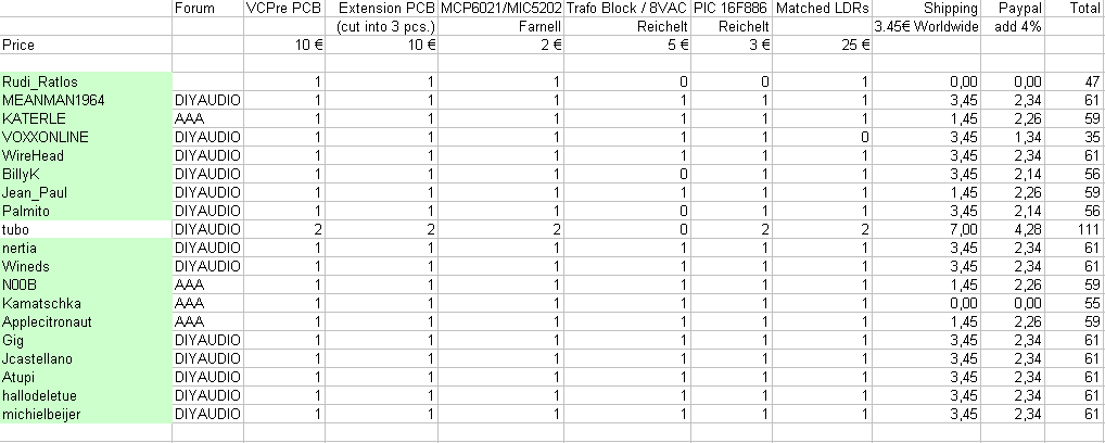

I received your payment, Adrian. Thank you!
I have already begun and am collecting the ordered components for you!

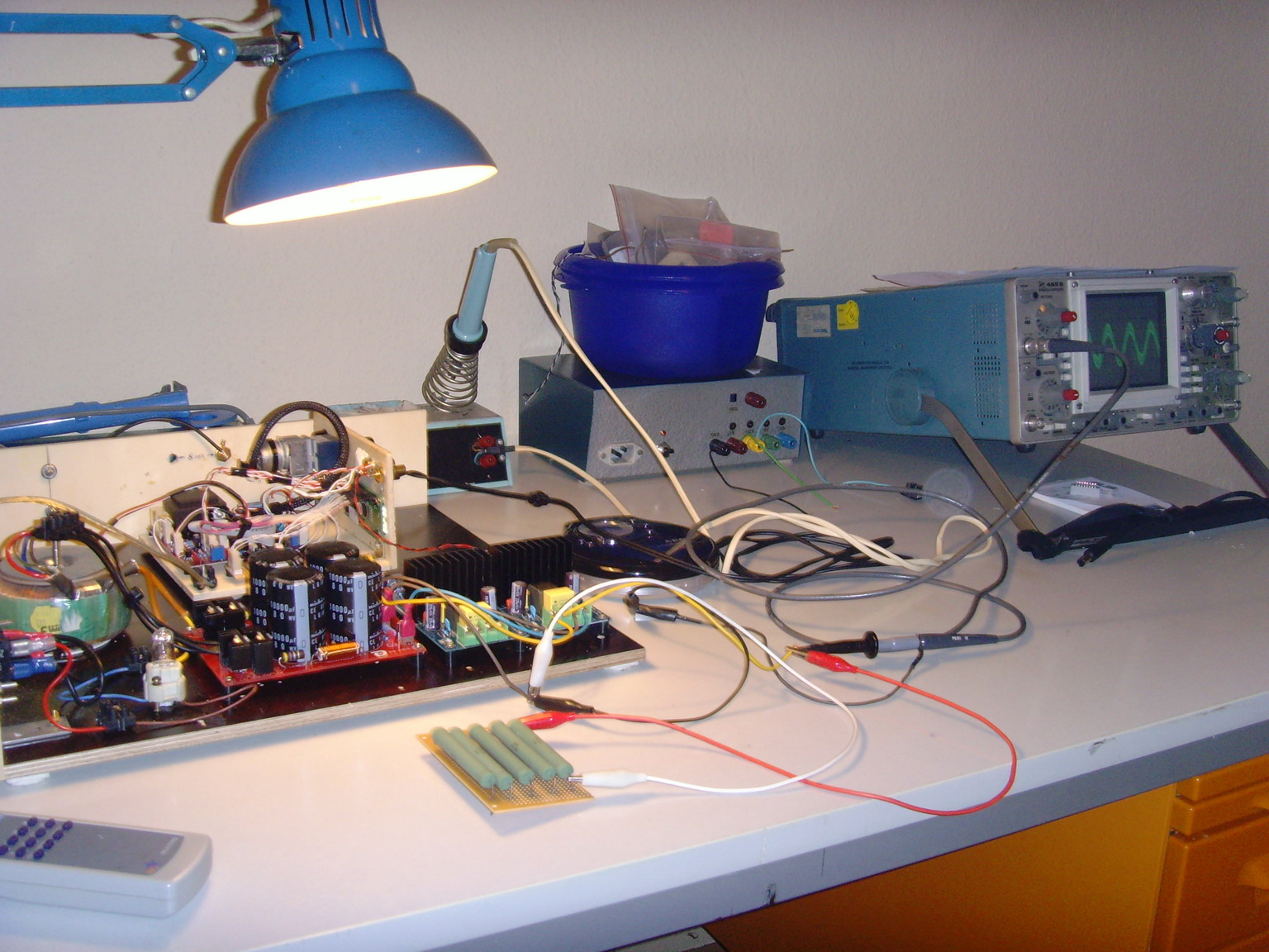

I am currently trying to "marry" the VCPre with my favourite ClassD-amplifier 😕 .
But the marriage does not look good, does it?
I remember that the input impedance of the connected amplifier should be at least (+/-) 24KOhm.
I will ask JLMAUDIO about the impedance of his L15D.
Looks and sounds great!!
