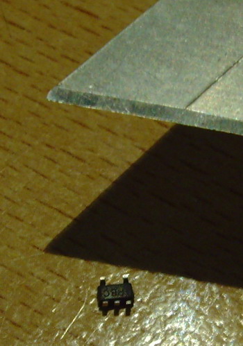

So: you all know, what you are talking about 😕 ?
The MIC5202 is smaller than an ant. The distance between 2 legs is 1mm 😱!
My old eyes start at 2.54mm.
I won't do this myself, but will politely ask somebody to solder the 5 SMD parts of the VCPre-PCB for me.
Best regards - Rudi_Ratlos
Rudi, if you are not using some magnifing lens and a good light is understandable. My eyes are also not so sharp but using this lens smd soldering is fun: http://www.4medshop.ro/files/produse/im_113_0.jpeg
It's pretty straight forward, magnification, lighting and flux is the key.

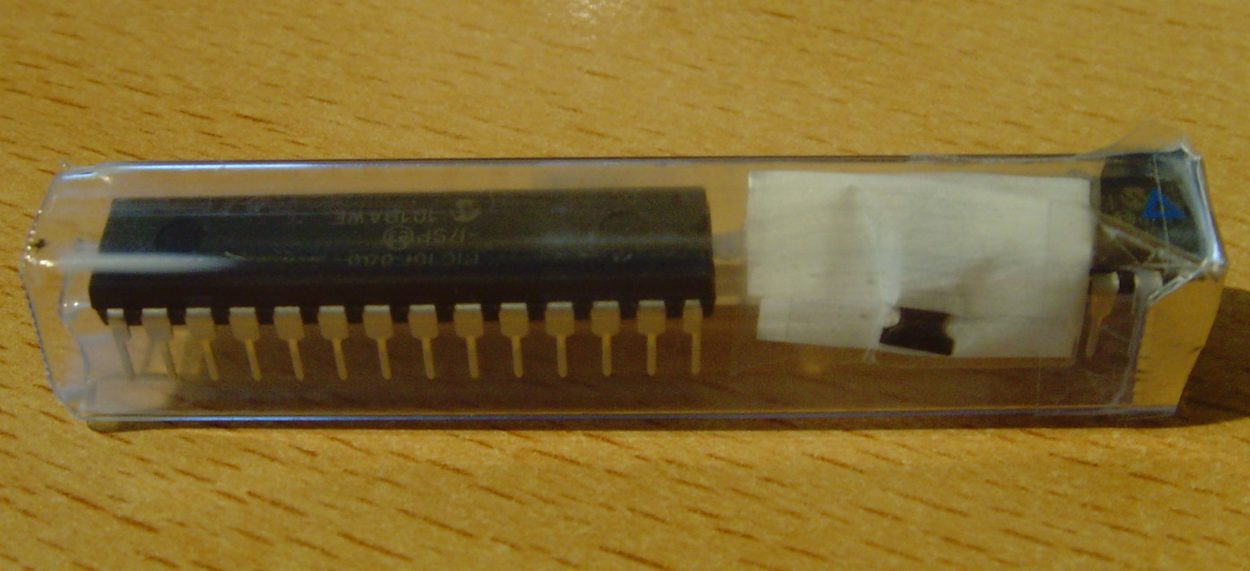

Gentlemen, I have already begun with the packet assembling of your letters.
Be careful, when you unwrap the item wrapped in white RYO-cigarette-paper!
This is the "ANT-size-Voltage-Regulator MIC5205".
I do of course have to wait for the PCBs (they are on their way to me, somewhere between Hongkong and Frankfurt), METAL is working
on the software, "Mr. LDR (Uriah)" has ordered LDRs and will match them, and I myself am currently busy writing the building guideline.
Please wait with ordering the BoM, until you have received and read the builder's guide.

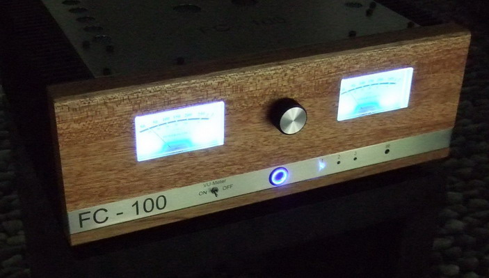

But let me tell you some very slight differences though: if you do not plan to use the "front-panel LCD" but like to do it as my German DIY-friend
ANDREAS did it (see image attached): you need "brighter shining relay-LEDs" and reduce the 3K3 relay-resistors to 1K, even to 680 Ohm.
And: you may find it useful to use a socket for the VCPre's fuse?!
Find attached an image of the front-panel of Andreas_FC-100 using the VCPre (but you will need an additional PCB to use
a McIntosh-like VU-meter and look at the LEDs labelled "1,2 and 3" ! The rightmost-hole in his front is used for the infrared-receiver).
Best regards - Rudi-Ratlos

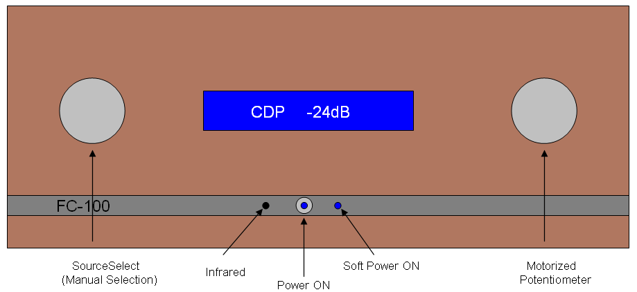

As I have already told you some time before:
My front-panel, using the VCPre, shall eventually look like this.
P.S.: Do you notice the difference between "PowerOn" and "Soft-Power-On (Standby) - using the SPO- auxiliary PCB"?

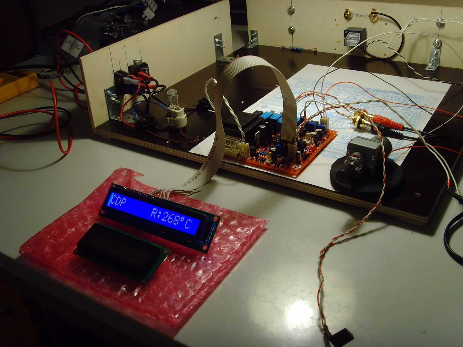

I have started working on the firmware. There is something that I need to say here:
The LCD that I and Rudi are using is 1x16 LCD, the addressing scheme of this LCD is different from normal 1x16 LCDs. So, people who decide to use 1x16 LCD should pay attention to the difference among 1x16 LCDs because not all of them use the same addressing scheme. This will cause incompatibility problems later on.
2X16 LCDs are also supported, and will display the temperature and update it continuously every 60 seconds minimum.
Hence, I am writing two firmware versions, one for 1x16 LCD that I and Rudi are using. This will use a remote button to display the temperature. The other version supports 2x26 LCDs, and will have space to display temperature on the 2nd line.
You must tell Rudi which version you intend to have and ask him what the model of this LCD is, or at least contact me by PM and let me know what model for 1x16 LCD you are going to use, I can tell from its datasheet whether it will work or not. This is for your convenience.

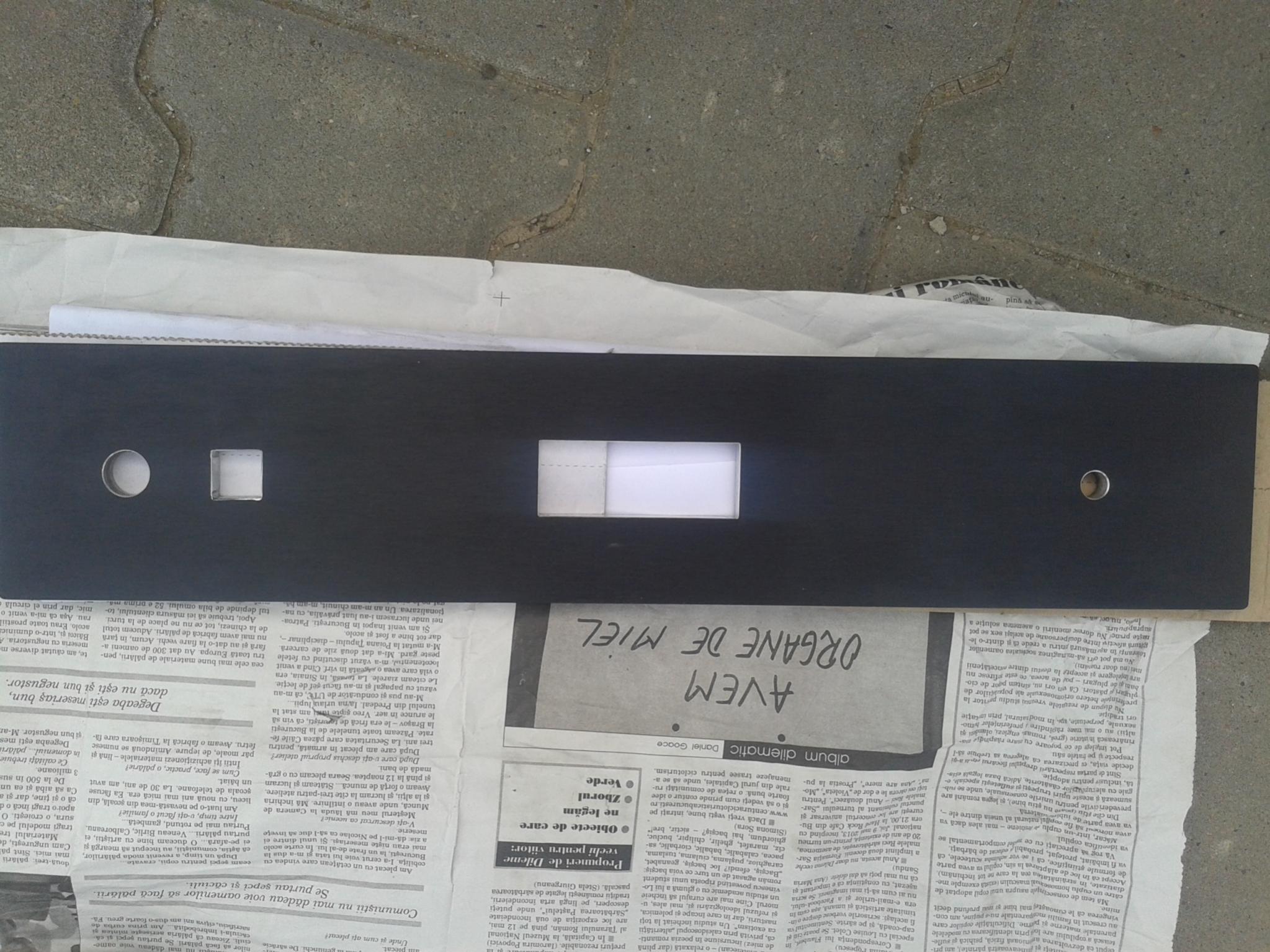

I like this 1x16 display but i already cut my preamp front panel for 2x16 display (HD44870).
I will ask Billyk, if he likes and puts this LCD:
NHD-0116DZ-NSW-BBW Newhaven Display | Mouser
into his MOUSER BoM.
