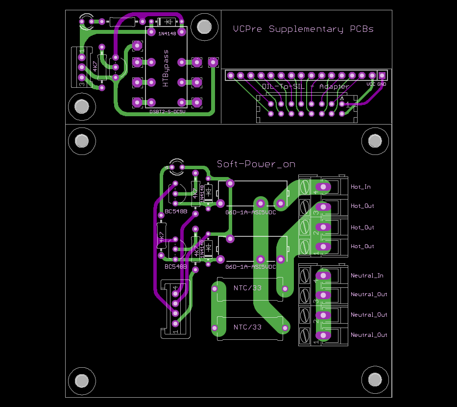

Gentlemen, I have had a nice idea this morning.
In case I put all supplementary PCBs (Home-Theatre-Bypass, Soft-Power-On, DIL-to-SIL LCD Adapter) on one PCB,
this PCB will cost 5€ as well and will save you 10€ (instead of 3 x 5€ per PCB).
But: Will you be able and cut a PCB (1.6mm FR4, 70µM copper)?

Good idea, you will need "scored" PCB's. Then you can easily break off the necessary PCB. "Scored" means the PCB is slightly perforated or there is a cut at both sides so the PCB is a bit thinner there. Not enough to break too easily. After breaking it you need to use a file to remove excessive fiber material.

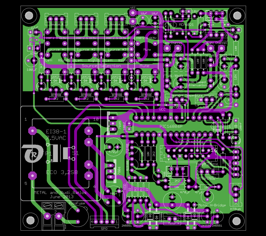

Gentlemen, find attached the final layout of the VCPre - PCB.
I won't do any changes on the layout anymore; the changes are getting too hard to implement.
Before I will open the group-buy, let me tell you another 2 things:
1. The µProcessor communicates with the IR-detector using the RC5 protocol (developed by Philips end of the 1980th.)
It does not understand RC5+, nor does it understand RC6 or any proprietary protocol.
So do not expect the VCpre to understand the protocol that your brand-new Panasonic (or any other brand) handheld transmits to it.
I use an old Philips television handheld (RC437HQN) and it works beautifully.

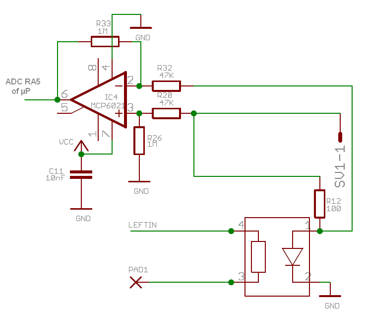

2) I worked very hard on the implementation of the display of the dB-attenuation. I measured the voltage drop across the safety 100 Ohm
resistor on top of the LDR's LED (this resistor prevents you from burning the LED) and built a lookup-table to correlate the attenuation
to the measured voltage drop. I used the input-resistor network of my FC-100 as a load for the serial LDR.
I should have used an instrumentation amplifier (like INA111), but since this type of amplifier is quite expensive and since I am only having
1 power supply voltage (5VDC), I decided to use the MCP6021.
The lookup-table may be rough in your eyes and may not reflect your own setup, but it will give you a "good impression" of the current attenuation.

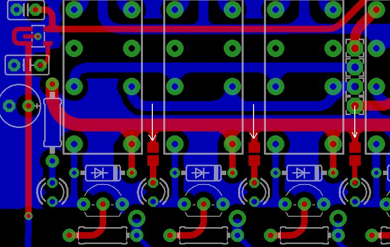

Since I myself have no practice soldering SMD components, but need now, since the VCPre uses the MIC5205 voltage regulator,
I have changed the package of the resistors in front of the relay-status LEDs to "easy to solder "SMD R0805.
These will be the first parts that I will try and solder on the PCB.
Best regards - Rudi_Ratlos
P.S. Sorry: I forgot the leftmost one; of course I will change it as well.

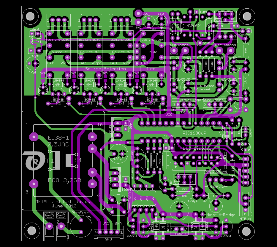

Rudi if still possible I would add 100nF caps as close as physically possible to output terminal of regulators 7805/06. Always good practice for stability and transient response of regulator to do this. I can see you have one on the 5V rail adjacent to and dedicated to the PIC but another closer to the regulator terminal would be prudent I think.
Gentlemen, I feel happy and respect your requests (see attached image).
But: is there anyone (Wineds?) and complies to my requests as well: "double-check" the BoM, cut the extension PCB and match the SILONEX LDRs?

Ok Rudi you want me to match the ldrs? I have done it before when I built a lightspeed. I think I bought about twenty and only got a few good matched sets. I am on the other side of the world to you in case that matters?
Thanks for adding the 100nF caps on the vregs
