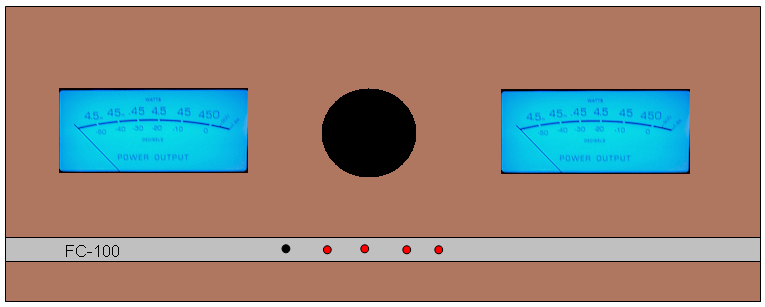

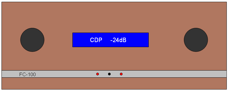

Find attached 2 pictures.
The left one shows how my front panel will look like, while the right one shows the front panel of a German DIY-friend of mine.
He is using McIntosh-like panel meters that are driven from a small DIY-PCB.

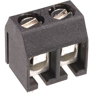

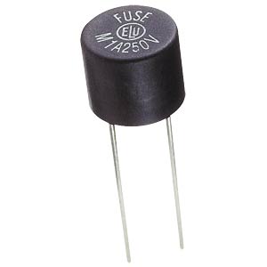

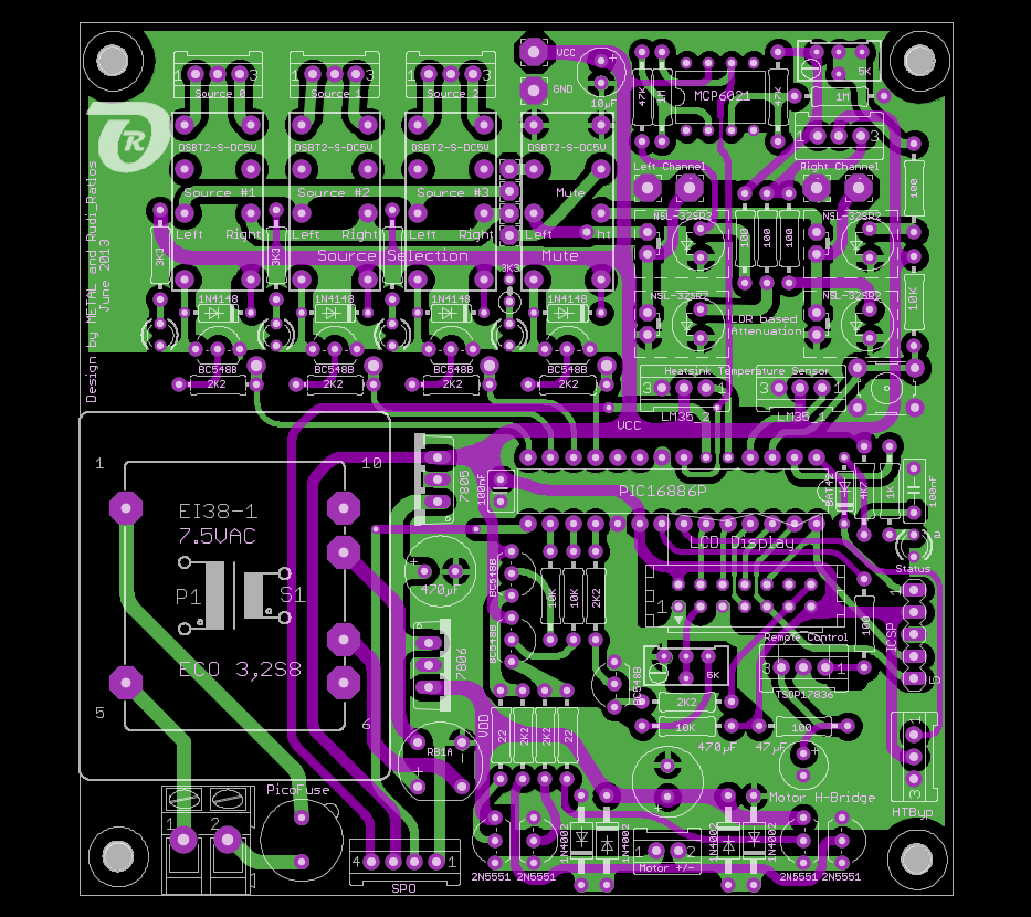

Hi Rudi, nice project. I would not use Molex KK for 230 V though. Better use a Phoenix MKDS for that. If you use a FR5 fuse it will fit.
Did you measure the device ? The transformer is pretty close to the audio circuitry. I think your GB will be a successful one as it is a complete versatile device. A buffer would have made it suitable for preamp use with separate power amps.

P.S. Jean-Paul: I will look for PHOENIX MKDS in my EAGLE-library.

That is better Rudi. Don't you think the SPO tracks run too close to AC pins of the transformer ? Also upper 230 V AC track from the fuse to the primary pin can be adjusted so that it stays further away.
* the whole input section can be moved somewhat closer to the upper side of the PCB. The further away from the transformer the better it is.

Jean-Paul: here we are.

Concerning the layout: the SPO- and upper 230VAC-track issues are cleared.
To move the input section closer to the upper side of the PCB will take some time. But I will do.

Now would be the moment to think about the size of the board. Make it slightly larger and you can add JFET buffers and have a larger distance between the transformer and the input/output circuitry. Fourth input would be possible too. Drawback: you will need symmetrical supplies when using buffers or use buffers with asymmetrical supplies coupled with those dreaded parts called capacitors... It would be a device that is even more versatile and suitable for standalone use as a separate preamp too.

Jean-Paul, thank you very much for your advices and remarks.
Regarding the position of the input-section in regard to the transformer's position: shifting the input-section as high as possible to the upper
PCB-border would result in a 3mm bigger distance from the transformer (but costs a very lot of work).
Nobody is bound to solder the transformer on the PCB.
You can put the transformer elsewhere in your case and run 2 wires to the rectifier.
But as I told you before: neither I nor the German DIY'ers, who have already build the VCPre (the previous PCB-version),
are aware of any noise that the transformer generates.

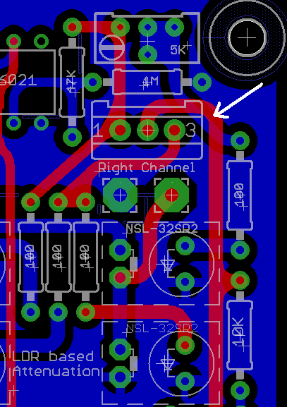

Billyk: the red track on the PCB's component-side, indicated by the white arrow, is the track that supplies 5VDC to the
LDR Attenuation Section (to the potentiometer that controls the current that is flowing through the LEDs of the LDRs).
I can of course put a jumper there, to make it possible to supply the needed 5VDC from another PSU.
