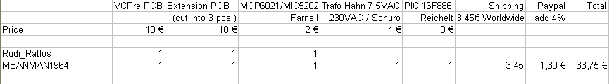

Gentlemen, I feel happy and respect your requests (see attached image).
But: is there anyone (Wineds?) and complies to my requests as well: "double-check" the BoM, cut the extension PCB and match the SILONEX LDRs?
Best regards - Rudi_Ratlos

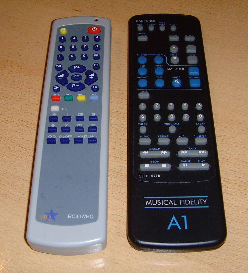

1. The µProcessor communicates with the IR-detector using the RC5 protocol (developed by Philips end of the 1980th.)
It does not understand RC5+, nor does it understand RC6 or any proprietary protocol.
So do not expect the VCpre to understand the protocol that your brand-new Panasonic (or any other brand) handheld transmits to it.
I use an old Philips television handheld (RC437HQN) and it works beautifully.
An Apple remote is one of the best and a good candidate for a nice preamp....it is also quite "preiswert".

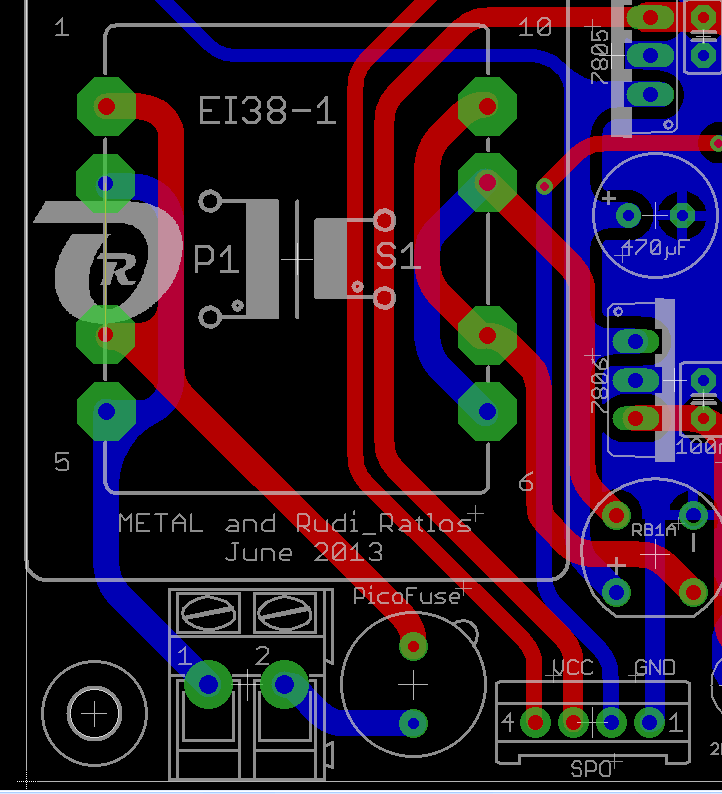

Regarding the transformer: we used a small and silent Tamura type that has 2 x 8 V secondaries and 2 x 115 V primaries which makes it easy for US guys. The outer pins are 115 V on the US version and the EU people can use a small bridge wire and use the 2 x 115 V version. Please see this impression of the PSU PCB:
http://www.diyaudio.com/forums/grou...-wm8804-spdif-power-supply-pcb-group-buy.html
You probably get an idea why designing my PCBs takes months.....Well it is a virtue to know your own shortcomings 😉

Jean-Paul, feel free and position the small transformer anywhere in your case.
You will have to run 2 wires to the rectifier then.

Rudi, do you really think I will be using an external transformer ? I just love the VCPre's one board approach. I happen to have sheets of mumetal that will solve any "not yet existing" problem with 50 Hz hum. And I can use a small toroid transformer and drill a hole just right of the 230 V tracks with an insulation washer in it for M4 screws:
http://nl.farnell.com/multicomp/mcfm32-07/transformer-mini-3-2va-2-x-7v/dp/9531386
Please move the track to pin1 of the EI38 transformer just a millimeter to the left 😉 You see for 10 Euro you can not go wrong with these small toroids. I use them a lot and they're silent and have a virtually non existent stray field compared to EI transformers. In fact it is a worthwhile upgrade and solves the 115 V /230 V dilemma.
Did you also get my point of the 115 V versus 230 V transformer ? That is if you want to make the PCB available for US citizens. They don't deserve it for PRISM but hey let's be flexible 😀 The NSA already know of this project anyway and they're decrypting the BOM and schematics right now...
What remote did you have in mind then ? The Apple Remote is only 20 Euro when ordered straight from Apple.
I prefer Sony RM-X151 because I have been planning to use it in other projects, I have already ordered two of them and I am writing code for SIRC, I am not much into Apple products and not willing to order this remote in the near future, sorry Jean.
I myself am using the ones shown on the image attached. Both of them "talk RC5".

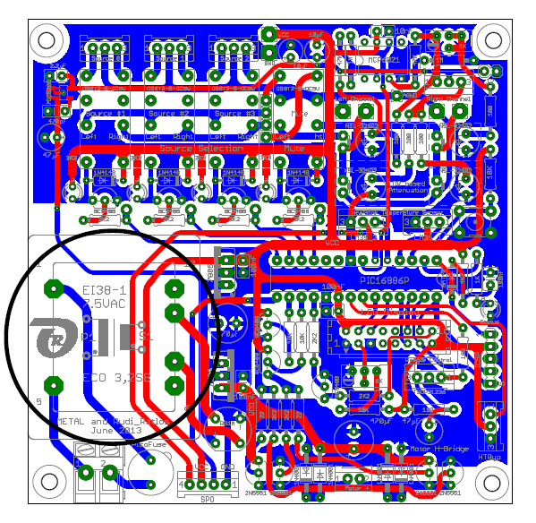

Jean-Paul, I assume that your torroid will hardly fit! Shown is a circle with a diameter of 42 mm.
I have done a more flexible layout for the transformer, in case somebody uses a 2x115 VAC primary and/or 2 x ? VAC secondary transformer.
Voxxonline: the transformer is the highest part; its height is 41 mm.

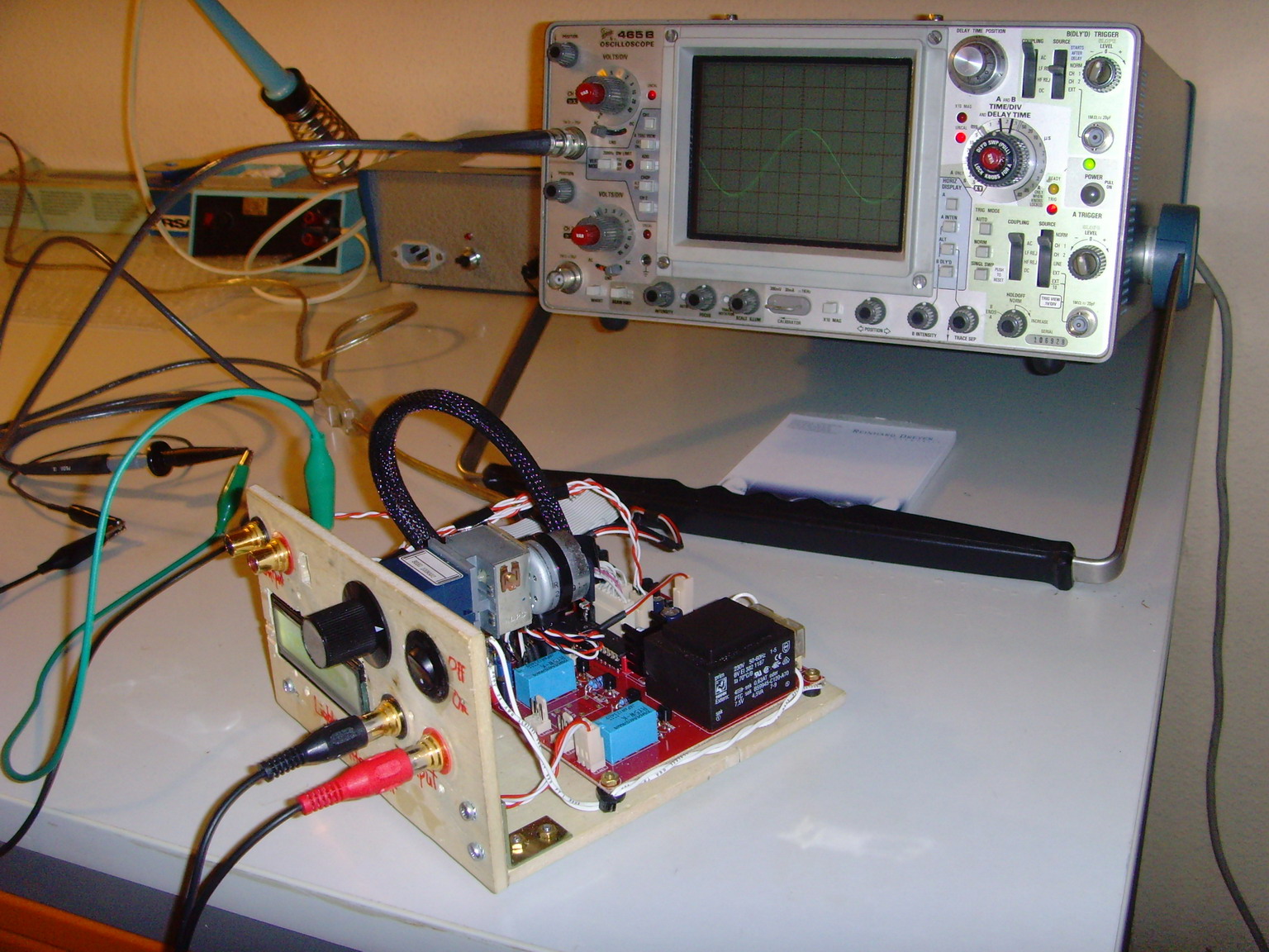

Gentlemen: find attached an image of my VCPre - prototype, playing / attenuating a CDP's track with a 1KHz sine wave on it.
The attenuated sine wave looks perfectly on the oscilloscope! Despite the vicinity of the RCA-connectors, relay, ... to the transformer.
So please don't argue anymore.
