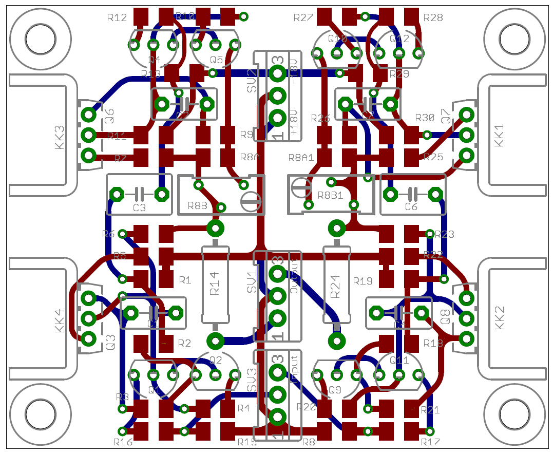

Gentlemen, I have connected a Version -1 VCPre to the Calvin-Buffer prototype and measured and listened to it!
http://abload.de/img/ldr005k6qri.jpg
It worked as designed and sounded delicious (even using a 7818 / 7918 PSU)!
Then I ordered one piece of the "All-in-One" (VCPre and Buffer on the same PCB as shown in post #637)) prototype PCB.
I soldered the PCB, it did not work, I managed to find the error (in the interface between VCPre and buffer - I have mixed input and output tracks), but was unable to fix the issue.
I will therefore not offer the "All-in-One" PCB.
On the one hand: it is very (too) complex to troubleshoot, in case you made an error, on the other hand: if you are going to build an integrated amplifier that has a suffienctly high input impedance (>20K, f.e. the SYMASYM),
you do not need a buffer at all.
I will instead offer two distinct PCBs (see the attached images):
- Buffer (the PCB-size is 50x60mm)
This is a Stereo-Buffer based on Calvin's buffer and has a 3 - connector - interface: Power, 2-channel Input and 2-channel Output
- Passive Pre-Amplifier (the PCB size is 100 x 80mm)
It is equipped with LDR-attenuation, LCD-interface, 5 source input selection, mute, SoftPowerOn interface, ..., everything can be remotely controlled
I will order 10 pcs of each of the PCBs this weekend - and restart again.
I am quite sure that everything will work this time.
As PowerSupply I will use LM317 / LM337 circuits (already ordered), but I do have an eye on building a PowerSupply based on TI's TPS7A - regulators as well (even on WINEDS's recommendation).
I will keep you informed.
This is DIY.
Best regards - Rudi_Ratlos

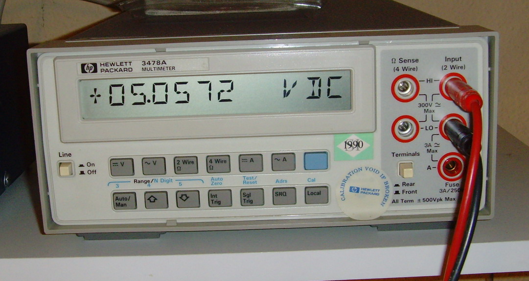

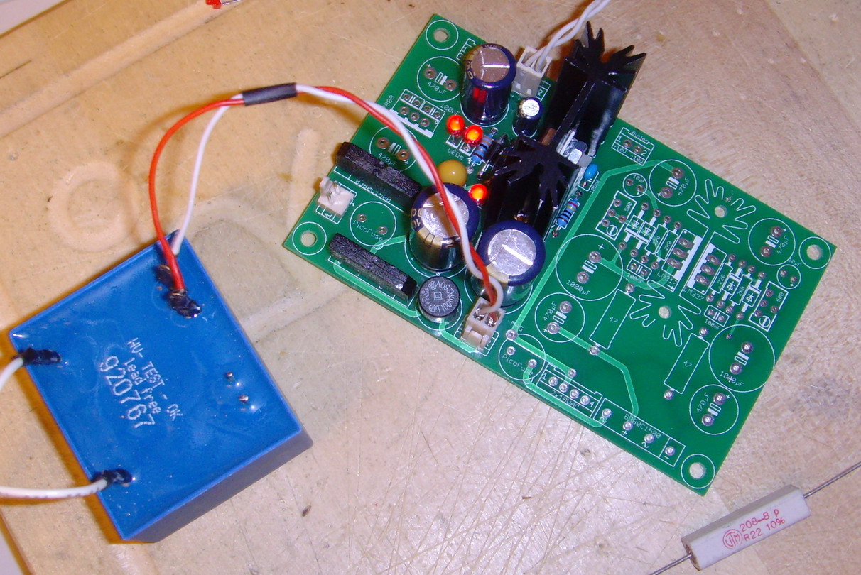

Paul, I built a 5VDC PSU based on the LM317 tracking pre-regulator design yesterday, put a 80 Ohm resistor on its output and measured.
I adjusted the output voltage by means of two red 3mm LEDs, giving a voltage drop of 3.8V; add the LM317 internal voltage drop of 1.25V to it.
The result looks quite promising.
The last digit of the DMM is not changing any more, so the ripple on the output must be smaller than 10µV.
On the right side of the PCB I will build a +/- 18 VDC power-supply (based on LM317/LM337), on the left side I will do a very quick and dirty 8VDC.

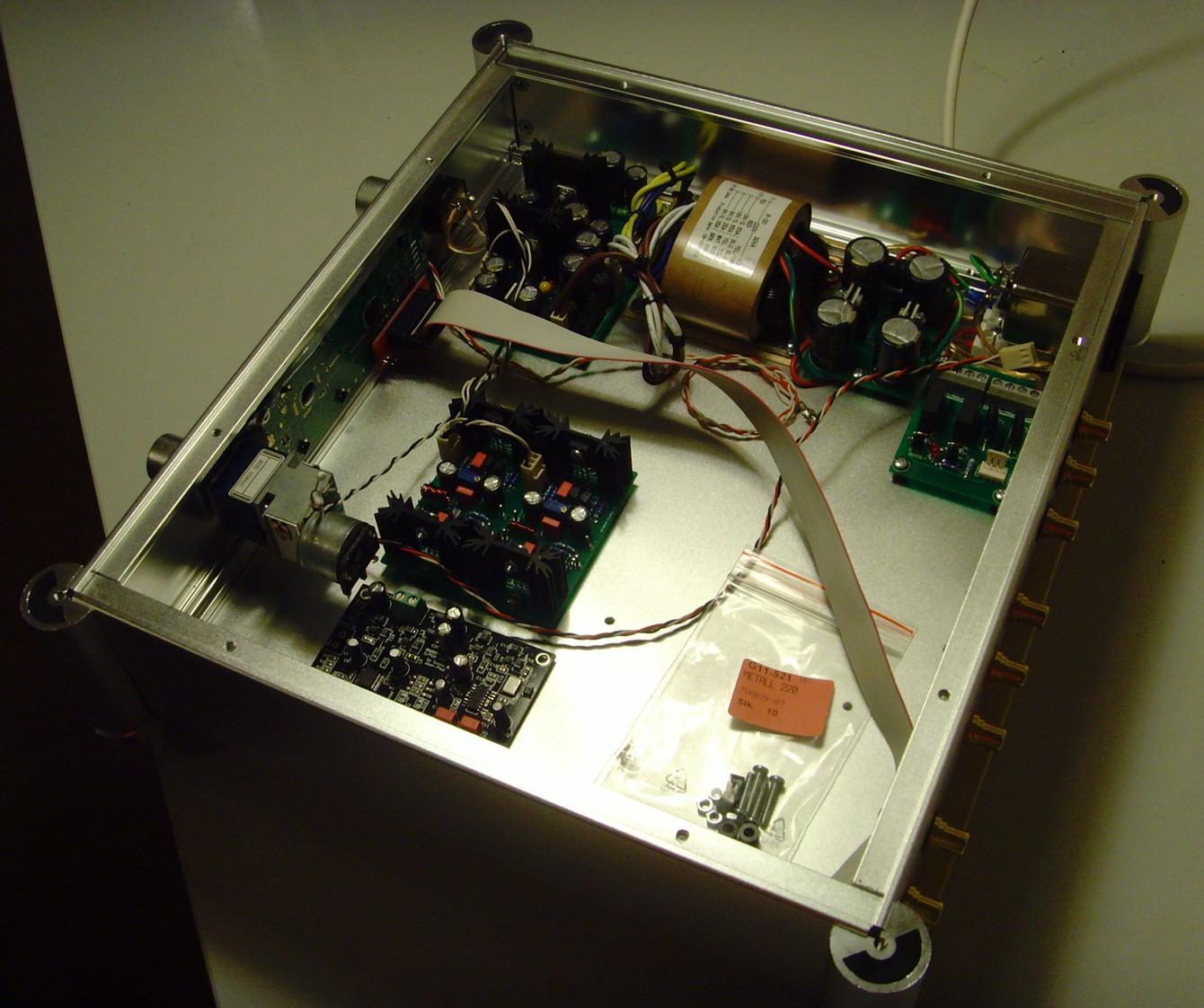

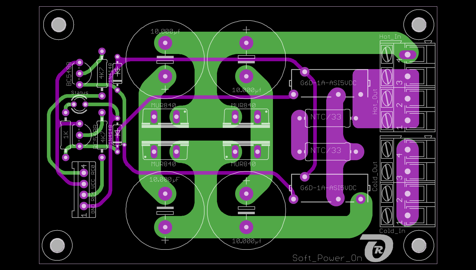

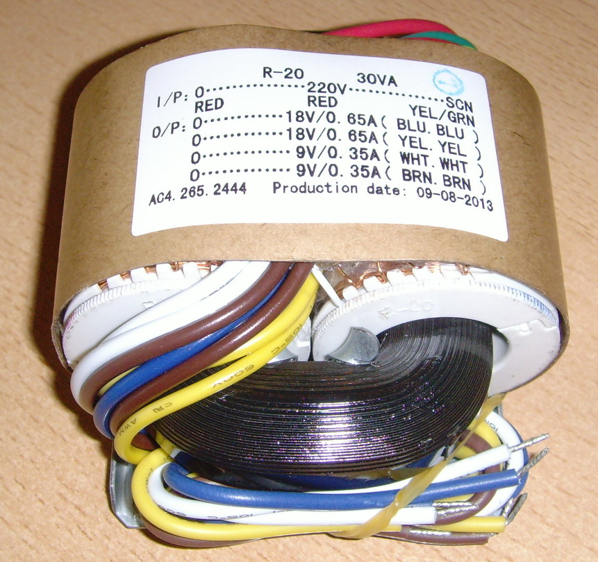

While I am still waiting (since more than 3 weeks) on the current version of my passive pre-amplifier - PCBs to arrive, I have prepared everything to take place into my prototype case (see image below).
From right top to left top you see: the SCHAFFNER - mains - input-filter, the "Soft-Power-On" - PCB (on its right side - it is used to power the connected amplifier; I still need to drill a hole for the used
NEUTRIK Power-connector), the mains-DC-filter, a R-Core-transformer (supplying 2x18VAC and 2x9VAC), the PSU (which I feel and measure to do a very, very good job, allthough being based
on the "poor (?)" LM3x7 regulators. You have to consider the layout as well; I have even distinguished between input- and output - GND), the buffer and Jean-Paul's DAC.
I will cover the PSU-components on the top of the case by some kind of ALU-L - profile, covered with µMetall.
Everything is prepared for the R-PRE - PCBs to arrive.

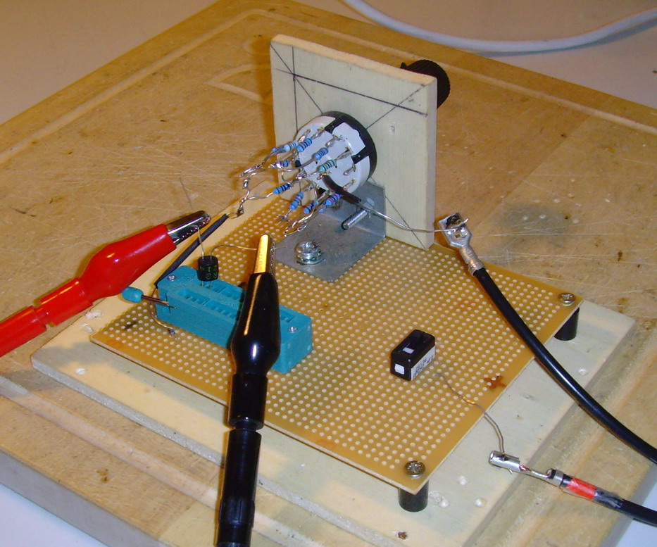

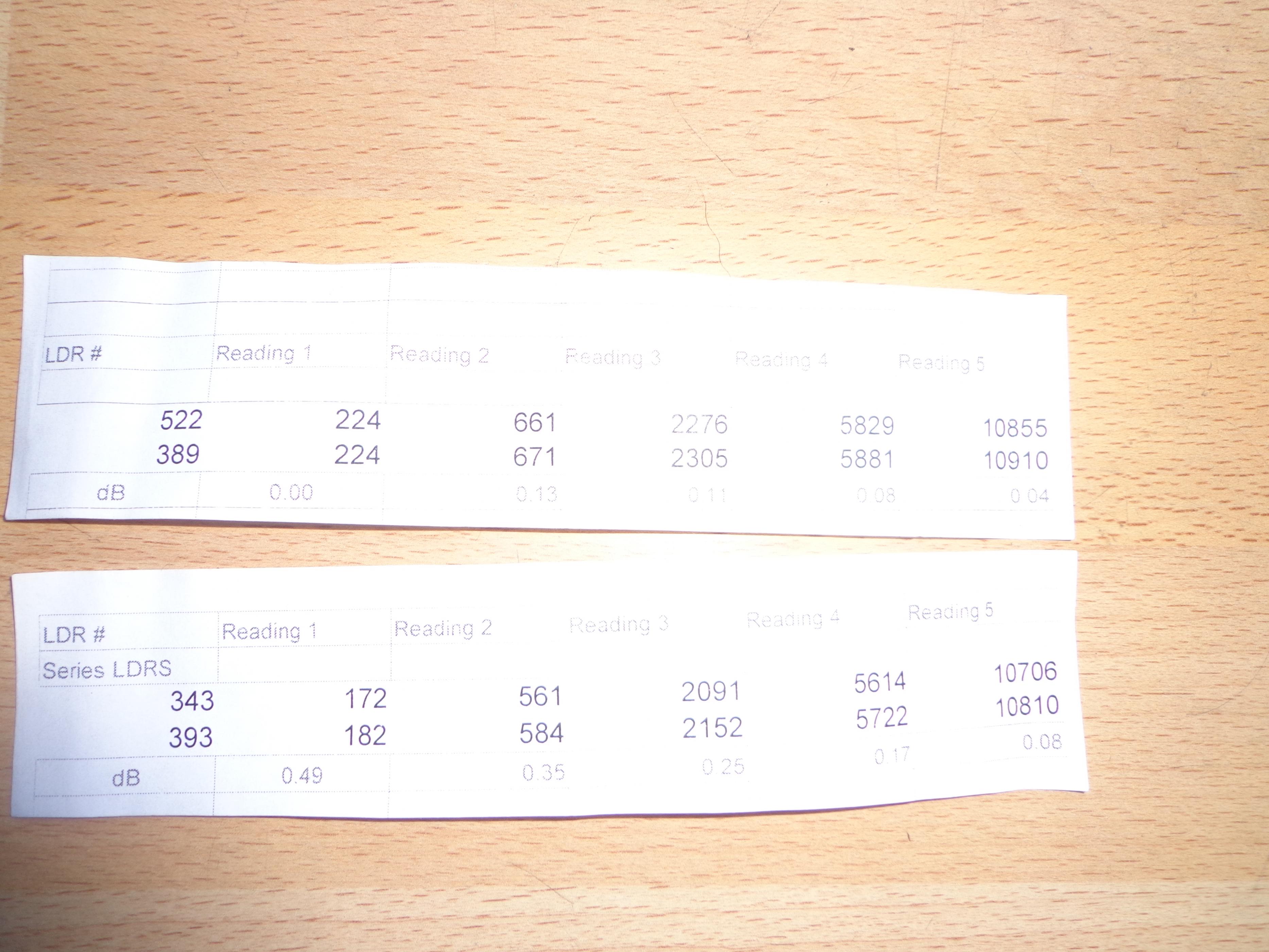

I have received a couple (75) of LDRs and have already measured them!
Well: there are 3-4 quads (6-8 pairs) that match perfectly!
But I need EXCEL to find other pairs (quads) of LDRs that match easily as well; maybe some of them need some kind of fine adjustment by means of the 2 on-board potentiometers! No problem!
I did the measurements of the LDRs by using a LORLIN - rotary switch with 12 resistors (values: from 86KOhm - 680 Ohm), connected to a 5VDC PSU (the 2nd image).
I do not advise you to buy "matched LDR quads" (I am happy to see that he has withdrawn his offer); you will be disappointed by the results (allthough the measurement-protocoll will highly praise it).
Go and buy 10-15 LDRs yourself and measure / match them - or believe in my recommandation / offer.
Best regards - waiting - Rudi_Ratlos

Patrick, it looks like the upper LDRs are a little bit better matched.
So take these as the shunt LDRs (the lower 2 LDRS on the PCB), use the 2nd pair as serial LDRs (the upper 2 LDRs on the PCB) and "match" the serial PCBs by means of the small potentiometer on top of the PCB.
