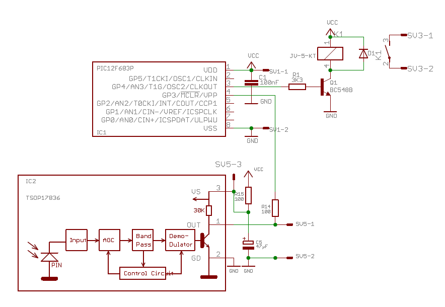

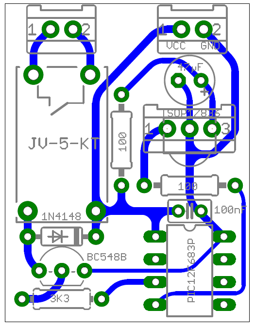

Master Rudi , would. It be possible to ask for your help creating remote controlled on off switch using small footprint ? I need it for my amp which would ideally be triggered by same protocol on off as foir vcpre. ? I d use same remote as with pre.
Thx
Ivan
Ivan, this would of course be possible.
All you need is a small PIC-processor, an infrared-sensor, a relay and a piece of software.
But I am very busy currently and do not have the time to do it.
Moreover: who will etch the PCB for you?
Best regards - Rudi_Ratlos

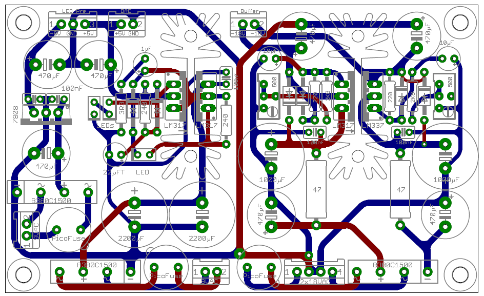

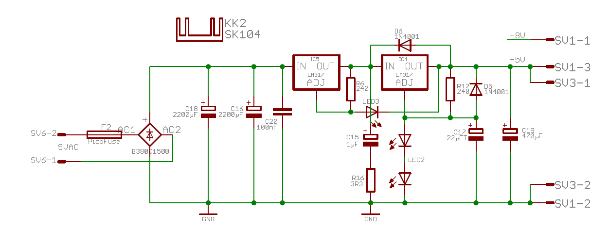

In the meanwhile I have layouted the needed PSU - PCB (Image1).
The requirements are: 8VDC (to provide currents to the MICREL5205 and the motorized potentiometer), +5VDC for the digital part of the Pre-Amplifier and the DAC) and +/-18VDC for the line-buffer.
I am very happy to have found a transformer (even an R-Core!) that will provide the needed secondaries: 2 x 9VAC and 2 x 18VAC.
Find attached (on the second image), how I will implement a very smooth, "ripple-free (?)" 5VDC - voltage / current regulator, using the LM317 as "tracking-pre-regulator".
This one will provide a very stable 5VDC to the DAC and the digital part of the pre-AMP.
I have come across this circuit while reading about the LM317.
In case you do not find a severe error in my design: I will order a couple of prototype PSU-PCBs on the day after tomorrow.
P.S. The 5VDC - output voltage is determined by 1.25V (adjustment of LM317) plus 2 x LED - voltage - drop (3.84V).
P.P.S.: this is the article that I am referring to: http://www.acoustica.org.uk/t/3pin_reg_notes4.html
