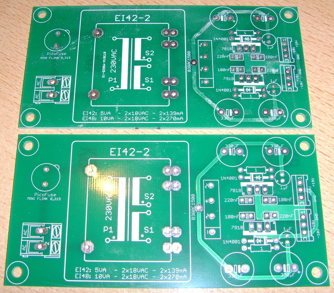

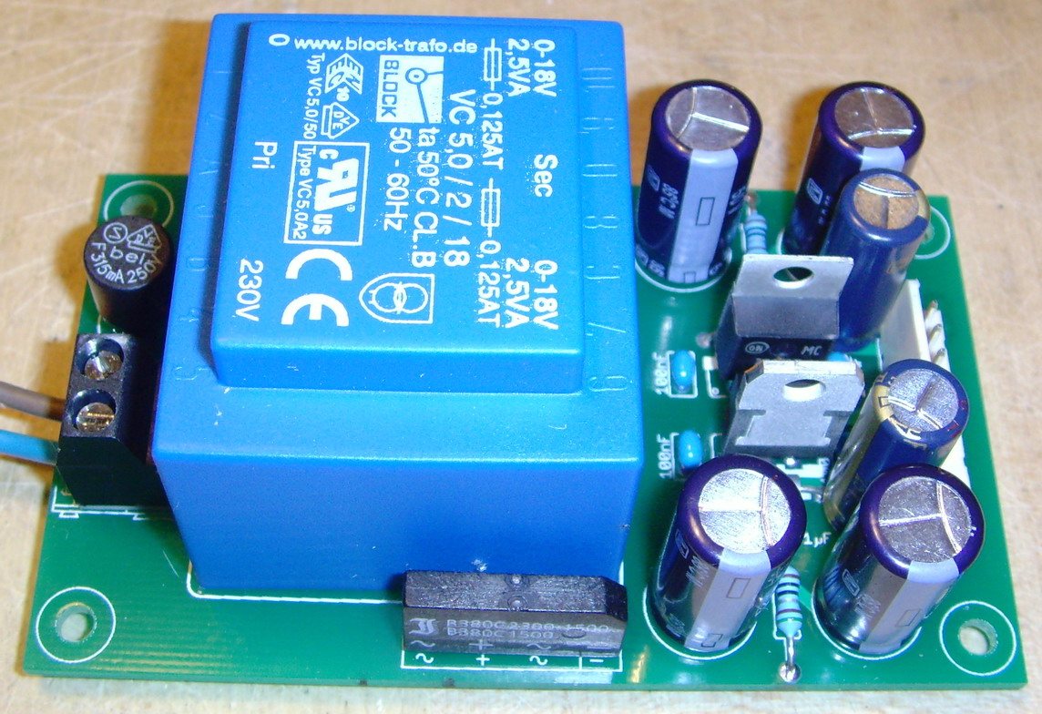

Ivan, I received the Dual-PSU PCBs today.
I have already built a PSU myself and do not see any ripple on the outputs.
In my opinion the 78xx/79xx regulators are much better than their reputation.
But maybe that my old Tektronix oscilloscope is no more sensitive 😀.
If you want to have a pair of PCBs: a pair incl. shipping cost 8€.
Best regards - Rudi

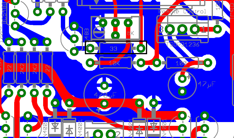

Hi Rudi.
You wrote in an email to use 33 Ohm for R24 istead of the printed Value of 2k2. But I cannot find any Picture of the Schematics with the parts enumerated! Could you give me a Picture of the PCB with all parts enumerated so I can locate R24?
Btw: Soldered the SMD Parts without problems. 🙂
Thank you in advance!
Greetings from around the corner! 😀
Ron

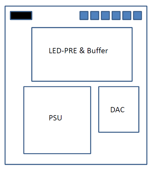

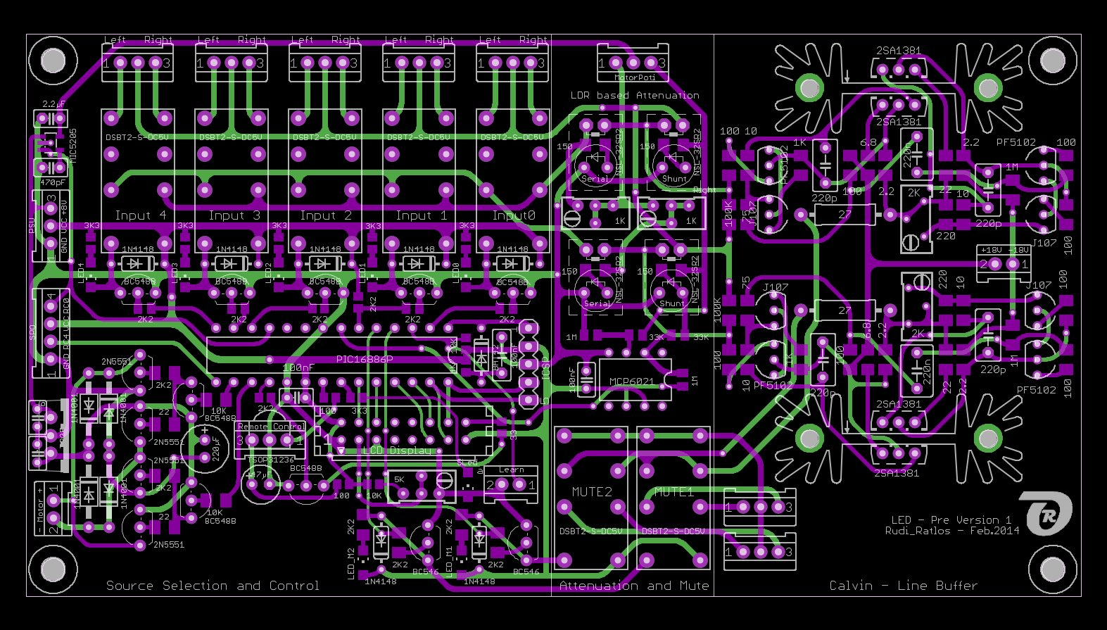

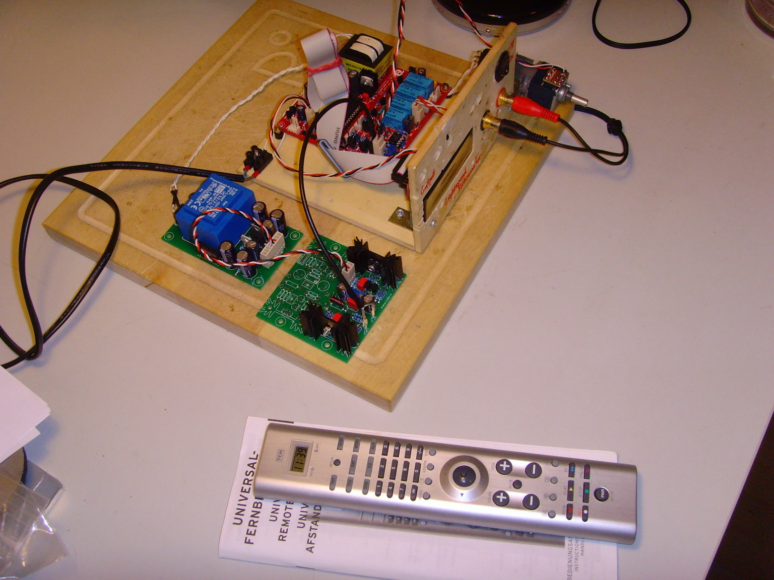

Gentlemen: as I told you in my post #608, I am currently working on an "integrated pre-amplifier, called LED-PRE", including an improved version of my VCPre, a line-buffer and a DAC
(well: I still need the permission of Jean-Paul and SUBBU to include it).
Find attached the current layout.
I have already built a prototype (2nd image), and the LED-Pre sounds very well, but I need to confirm my first impression.
I will keep you informed about this project.
Best regards - Rudi_Ratlos
