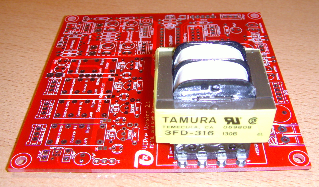

The VCPre V2.1 PCBs as well as my MOUSER order have arrived.
The TAMURA transformers seem to fit perfectly on the PCB! This has been a slight challenge to me, since the EAGLE software
does not provide a "package" for the TAMURAs, and I had to draw one by my own!
The TAMURA transformer supports both 115VAC and 230VAC mains.

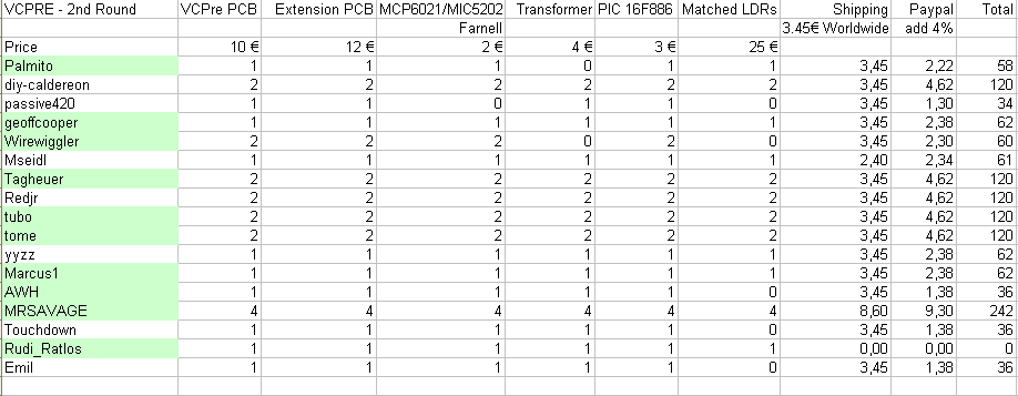

Find attached the current order status.
I will write a PM to those, who did not pay yet.
