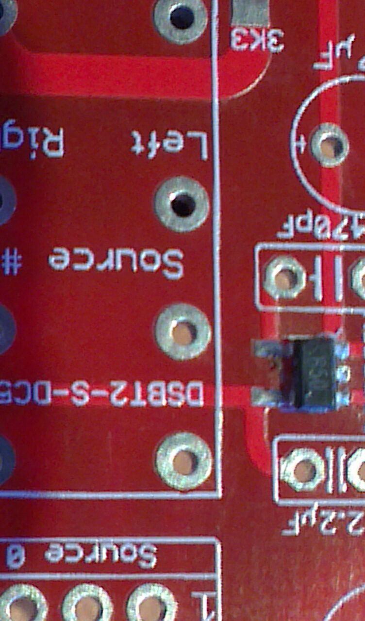

Ordered parts on Element14 today. Might take a few weeks for the parts to arrive though. Bit the bullet and soldered the SMD MIC5205 on the PCB. Glued it in place with a small dab on Selleys Shoe Glue first. This is a type of contact adhesive. Worked quite well and held it in place while soldering. Wicked off excess solder with solder wick and then gave area a light scrub with a toothbrush and mentholated spirits.
