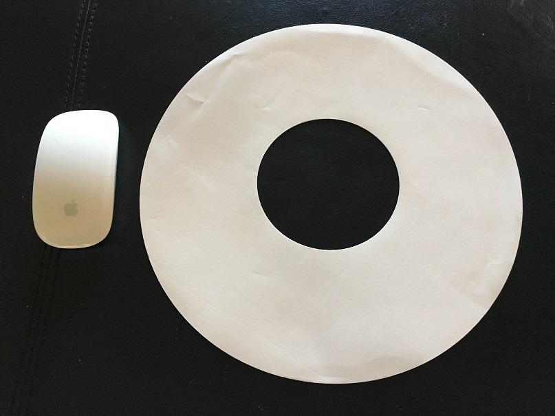

I looked up an eBay listing and it made reference to a substitute platter "mat".
DANGER! NOT RECOMMENDED!
Here is the story on vacuum platters. They use air pressure to hold the entire record surface against the platter. The first turntable in the US with this feature was the SOTA and it had an acrylic top layer on the platter to provide "mechanical impedance" matching. The problem was that records are (in general) not flat.
A vacuum platter will flatten out most (mildly) warped records, but all LPs (except some of the Classic with a special flat profile) have a thick "lip" at the outer perimeter. This lip was designed so that on an automatic record changer the LPs could drop onto a spinning one and not scratch each other. (45 singles did not have this lip, but also were used on automatic record changers - odd.)
The SOTA platter had a slight bevel at the out centimeter or so to accommodate the lip. When the vacuum was applied, the record would bend at the inflection in the platter, and any dust or dirt on the platter would be pressed into the LP and damage it irreversibly. I ruined several hundred LPs before I figured this out.
When Bicht was developing the Versa record player, he absolutely had to have the vacuum to force the LP to be perfectly flat. The radically short "tonearm" would create massive "warp-wow" if the LP were not perfectly flat. But any soft platter mat would ruin the sound because the LP needs a firm mechanical support.
This conflict nearly killed the Versa before it was even born. Fortunately Bicht was able to find exactly the right material. It was soft enough to absorb any dust or dirt, yet thin enough not to damage the sound quality. This special platter "mat" is only about 0.006" thick and is extremely important!
Without the special mat, the records can be damaged. Yet any conventional mat will ruin the sound, as the record will not properly couple to the constrained-layer platter. Only the original mat will do, and anything else will spoil the sound quality. Yet the original mat is fragile and can shrink over time.
There is no substitute for this mat. If you have a Versa turntable, plan on buying at least two or three mats from Bicht while he is still alive so that you will have spares. Even if each mat lasts 10 years, the record player will last many, many decades. Buy them while you can. I know of no substitute for this mat, nor any economical way to make your own.
You may want to also purchase a spare "lip" that holds the vacuum at the edge of the LP. Those are the two main items that can wear out and are literally irreplaceable. I consider them mandatory for any Versa owner. Please check his website for other spare parts, but those two are imperative.

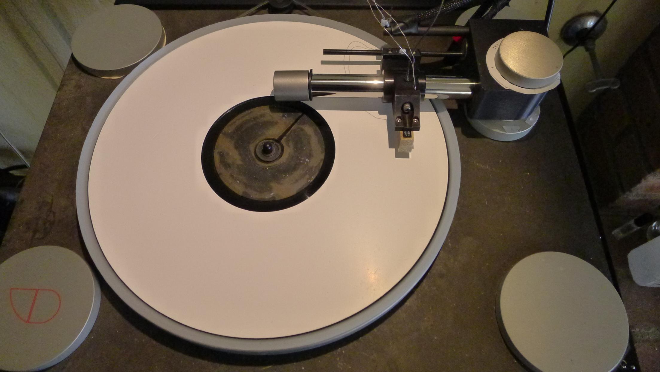

All,
I'm delighted to tell you that I am waiting for a restored Model One (including the original spec tall table) to land here in the UK, having finally found one to buy at a sensible price in California 😀. (Here in Europe, I have seen them go recently for Bergmann Magne prices second hand.)
I will then have the slightly less delightful task of paying the eye-popping customs duty and sales tax levied on both purchase price and shipping charges by our voracious government to spring it. But it should be with me within ten days.
I shall keep you updated and would be grateful if I can tap into your pool of knowledge and experience as I bring it into commission.
My experience of air bearings has so far been limited to a (British) Terminator Pro and the American MG-1 Linear Tracker, both of which rely on aquarium pumps to provide the pressurised air, so am used to running air pipes and using clutch cleaner to keep key surfaces clean. And I have yet to wreck a cartridge on one of these arms...
Photos will follow in due course.

I am very, very sorry to hear that the platter mats are no longer available. This is likely why the Versa is available at a bargain price. With a conversion to an all-analog 3-phase motor and higher vacuum and air pressures, it would likely destroy any of the $200,000 turntables.
Excellent advice on the other parts, although I don't know what good it will do without a usable platter mat.

Do you know of what material the mat is made of?
If anyone wants to send me a sliver of it (a couple mm), I can tell you what the material is so that you can get more.

I'm not sure how readily available it is. For decades it was the paint of choice for custom bicycle frames. Last year I visited my framebuilder friend and he said that he had to jump through a bunch of hoops and pay a lot of money to get what was for him a lifetime supply. If it were readily available, I don't think it would have been a big deal for him, but I know that it was a huge problem. Sorry I can't remember the details. My memory is not as good as when I was young.
Hi SY, purely out of curiosity, are you saying you can determine what the material is through observation or testing?
Thanks, sp
I should know next week if I will be able to put these back in production and what sort of price I can offer. In the meantime here are pictures of the prototypes. If possible I will get the final product dyed light grey like the originals.
Right, the Model 1 turntable has arrived and I'm recovering from the hernia-inducing lifting of the boxes...I've had to attend to business during the week but the big unpack starts tomorrow.
Before I plug anything in, may I seek some advice, please?
I'm assuming in the short term that a simple step down transformer from 220/240v to 110/120v volts, but with a 50Hz frequency, should cause no speed problems with the turntable as it is a DC motor?
However, what about the same for the air pump motor? I do have a power conditioner which can reshape the frequency to 60Hz but it seems a bit of a waste to be running a motor off it.
