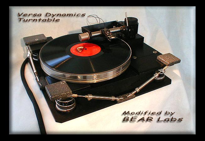

Charles,
Thanks for throwing in those details... I don't think anyone had the differences confused or that the 2.0 came first... or the difference in the bearings.
If you can say something more about how the bearing on the 1.x is set up, I'd appreciate it... it is new to me, and looking at it I am somewhat scratching my head about how this is supposed to work and be set up, and what the purpose of the pin in the center is, and the "rings" (for lack of a better term) that mate with the aluminum (not terribly well finished) ring on the bottom of the platter.
I don't think that putting an outboard motor and/or controller to run the platter is a major issue (assuming you have the machining capabilities)... so that's for me speaking for myself only! 😀
Attached is a shot of a 2.0 that I modified for a client many years back now, and you can see what I did for the "springs". Those are hydraulic dampers, the worked perfectly - at rest they do next to nothing, but they keep the TT chassis from swinging about and bouncing all over creation!
Short of adding in an air isolation system (not a bad idea) in place of the springs, this works great.
Again, if you have the machining capability on hand. I do, so it was practical for me.
