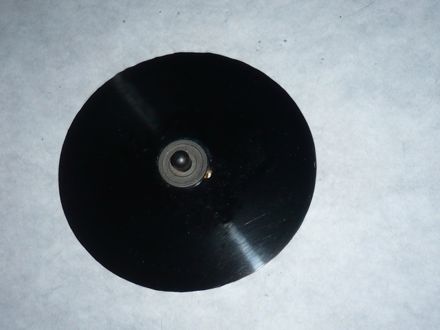

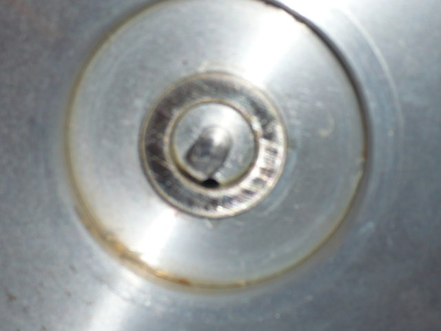

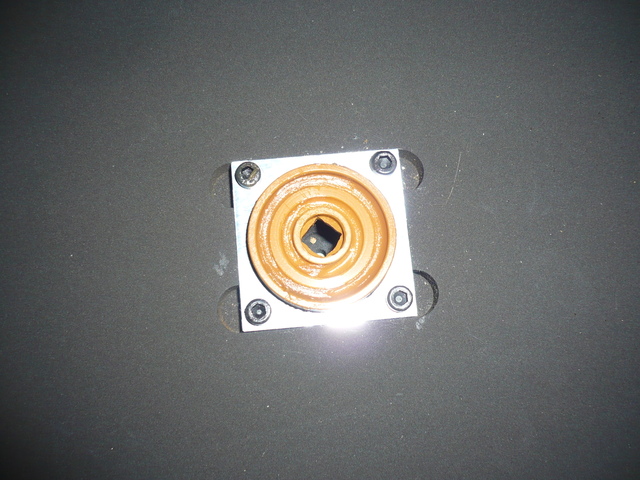

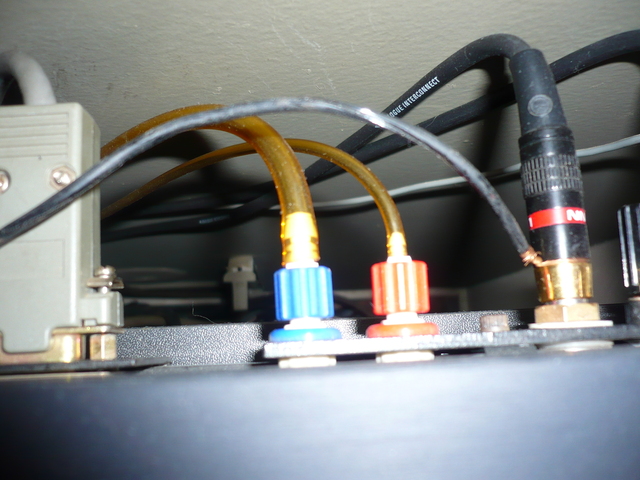

Photos:
The shaft bearing, the arrival of the air tonearm (small pipe), vaccum hold down (large pipe), the axis of the platter and the top of the platter and we see the hole next to the spindle for the vacuum down disc.... 😀

Yes, but this is not an airbearing on the platter.
The 2.0 is a full airbearing on the platter.
What I was commenting on is that in order to have a vacuum hold down on the platter of a full airbearing assembly one would need a hole through the center of the rotating part (spindle) of the unit... and a way to seal it while it rotates... the reference was to the units that 1Audio suggested
I have a 1.2 right now, so I can see exactly the same thing you too pix of... 😀
