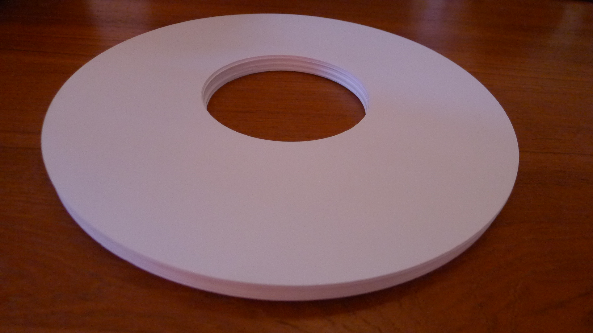

A little bit of background on the Versa Mats. John has told me that the various iterations of his mats ranged from 0.010" to 0.020" Some had a light adhesive on the back, some didn't. His current mat on his personal record player is 0.020". I have had early thin versions and am now running one of the new batch which is nominally 0.5mm but measures 0.0238" thick with my calipers.
I have made a a couple of digital recordings to make it easier to compare the "sound" of my original prototype mat which was 0.0123" thick to this new batch which are 0.0238" thick. I would someone to take a listen and give me their opinion as maybe I'm biased but I don't hear any obvious differences.
https://drive.google.com/folderview?id=0B2ceYgRGBXdba1h6aHdaS2lWNHc&usp=sharing
The files are simply named "A" and "B" please post any comments you have on the differences you hear. I adjusted VTA to account for the difference in thickness. The recording is the 2nd side of Sibelius Symphony NO. 2 RCA Living Stereo (Re-issue) LSC-2342. Thanks!

My order has just arrived. They are very well finished and will not put your equipment to shame at all. I shall report on sound when I have the opportunity (there is an internecine Rugby international going on the moment with Welsh and Scots intent on annihilating each other, which is more urgent if not important than fitting a new mat) The higher the body count, the better for England when they meet both later in the campaign...
