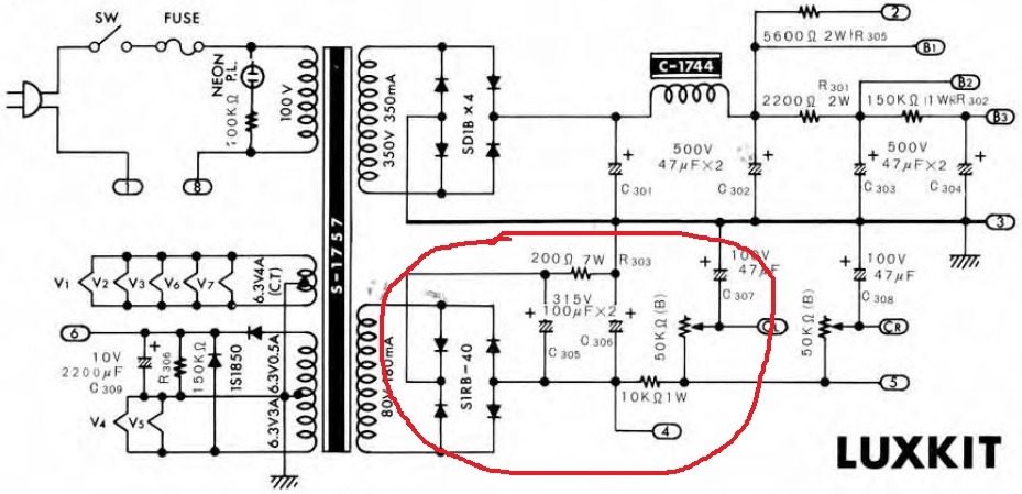

Wire a 120V:12V transformer backward across a 6V winding to make 59VAC and >80V of DC to divide-down in your bias adjusting network.
This added transformer can be very small, <5VA.
The transformer running at half voltage will run cool, quiet, and unstressed.

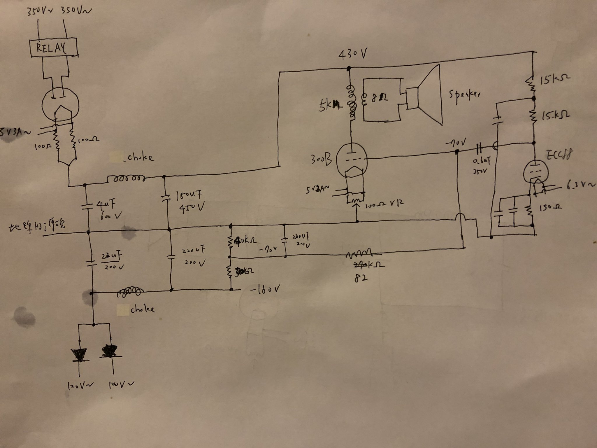

Maybe you can reference my schematic.
My negative bias is expensive but it is very robust.
In the most recent round of bias attempts, I went with individual 470 Ohm Cathy resistors, 200uF cap bypassed but through a common 50 Ohm to ground. Idle bias sets up ~14-15V. Distortion doesnt measure particularly well, compared to each channel running through a common bypassed 200 Ohm. It took a lot of work to get those in place, including my absolute favorite; detaching without breaking anything the OEM wrapped as foo wires off the flimsy tube socket pins.

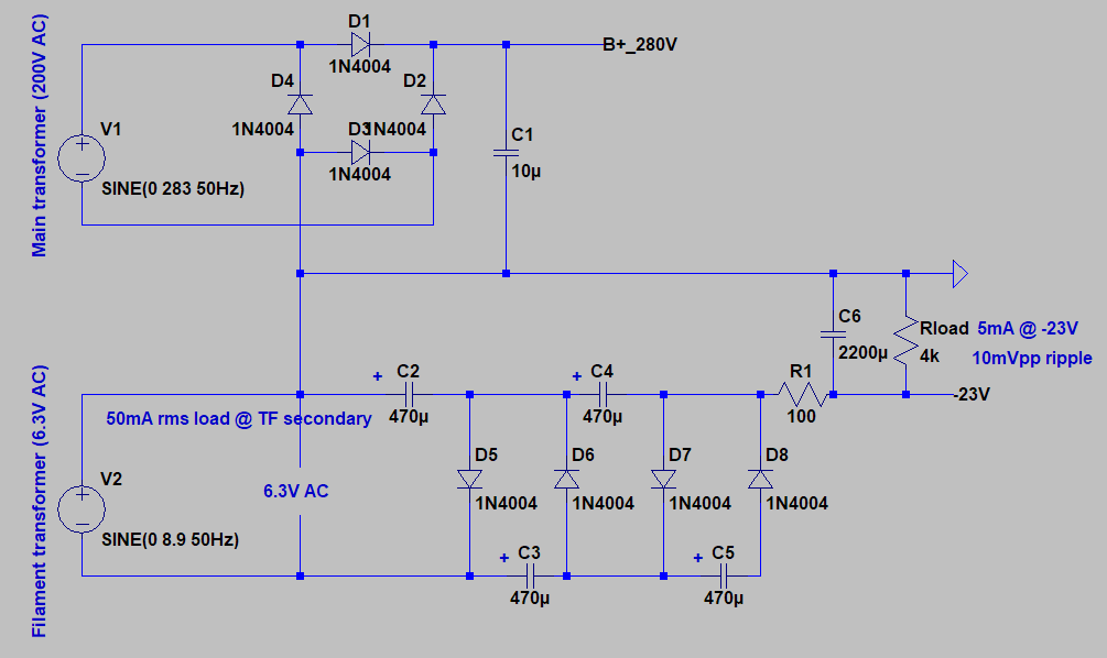

Cockroft-Walton multiplier off the AC filament transformer https://en.wikipedia.org/wiki/Cockcroft–Walton_generator
Just keep adding stages to the C-W for more negative voltages. You can also tap off mid way through the C-W if you need a range of negative voltages. Be aware that the load on the filament trafo will be much higher than the output negative supply load.
Sizing of caps in the multiplier depends on how much ripple and sag under load you can tolerate. Might be more cost effective to accept some ripple on the output of the C-W multiplier and then follow it up with an R-C with a bigger cap as pictured.
Also adding any sort of basic rectifier circuit to your filament transformer is going to add a load which produces short current pulses on the secondary winding on every half cycle. That pulsing may cause you noise issues if it injects into the circuit via the heaters which are running directly from the secondary winding. You could try adding a dropper resistor or choke on the input to the C-W multiplier to alleviate it if it's a problem. Both are going to make the C-W output a lot weaker / lower voltage however and honestly I'd just add another mains transformer instead in that case.
The main power transformer winding has an issue; designed to run the amp hot to begin with, even hotter due to the 110 VAC input design, now getting 120. The amp uses two-stage C-W for a voltage doubling B+ design, I was getting 450V initially, to 420 when the tubes start conducting.
I tried shot-gunning some inductors at the input (as you suggest) I picked up at the local ham radio flea, but they all dropped the voltage too far when the OPTs started pulling current. I then tried a small power transformer with a 12V output to buck the B+ winding. This ended up with 380V B+ and 365V plate to cathode after warmup. Hopefully the 6BQ5s like their new B+ a little bit better.

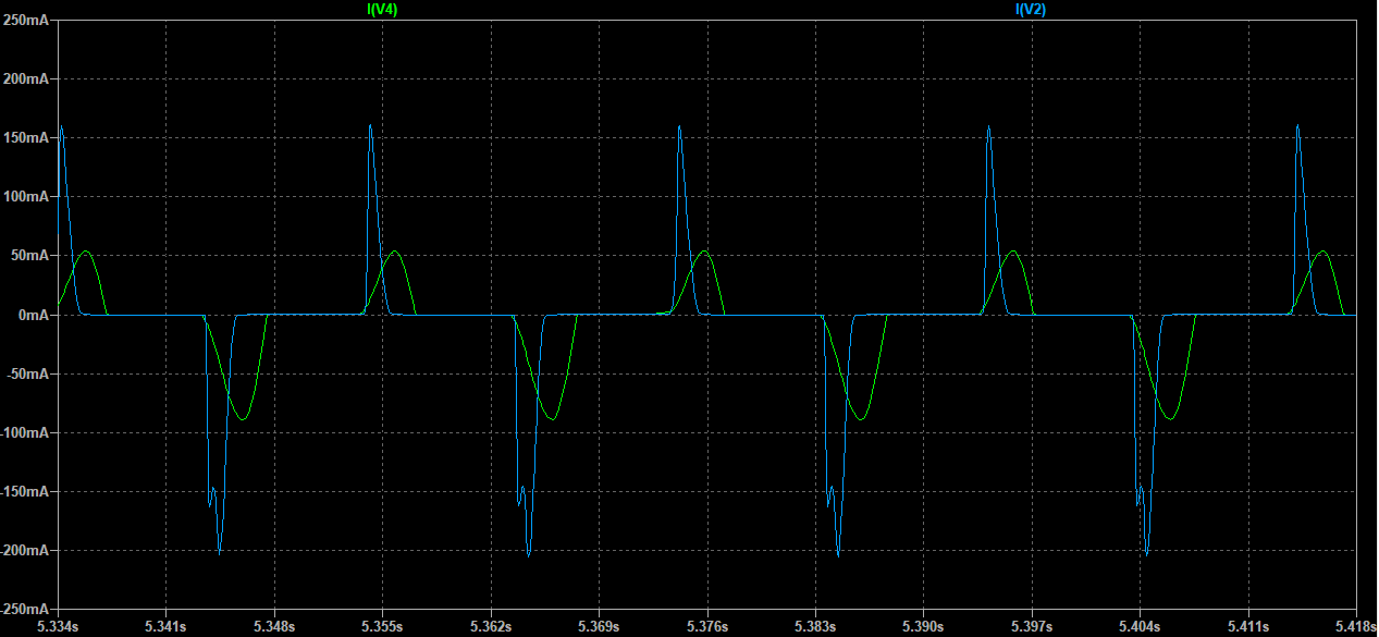

Likely they had way too much inductance or too much resistance if they were multiple-Henry inductors intended for tubes. In a tube rectifier circuit the inductance is by design so high that the current through the rectifier barely even changes over the half-cycle. This is done as it maximises the power output that can be achieved from a tube rectifier, at the expense that you now need a transformer with about 50% higher secondary voltage and the powersupply rail will fly up +50% under no load. The current waveform through the transformer secondary almost looks like a square wave.

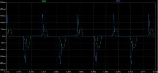

To alleviate mains buzz from solid state rectifiers switching you usually don't need to turn the sharp pulsing current waveform into a square wave. Just adding a little inductance to take the edge off the pulses can be enough. Here's what adding 20mH in series with C8 does to the current drawn from the transformer secondary. The negative output voltage only fell from -23V to -22V.
One time in my career I was the power supply guy for a small FF PC. The waveforms you show remind me of the AC line current of the switching PSU in a PC. For export to some countries, we added a PFC (Power Factor Corrector) which was basically an inductor, which did exactly what you show, but for the AC line current. I remember being responsible for company's the internal spec for that part.
Yep that's exactly what it is - passive power factor correction. It also has the advantage of reducing the harmonic content of the rectification pulses by stretching them out, such that whatever DC power supply filtering and amplifier power supply rejection you have is able to reduce it down to an inaudible level.
The disadvantage is that your DC output voltage goes down as you increase the inductance, as the voltage across the choke/inductor is non-zero when the transformer secondary peaks in voltage - the current lags the voltage more and more as a larger inductance is used.
