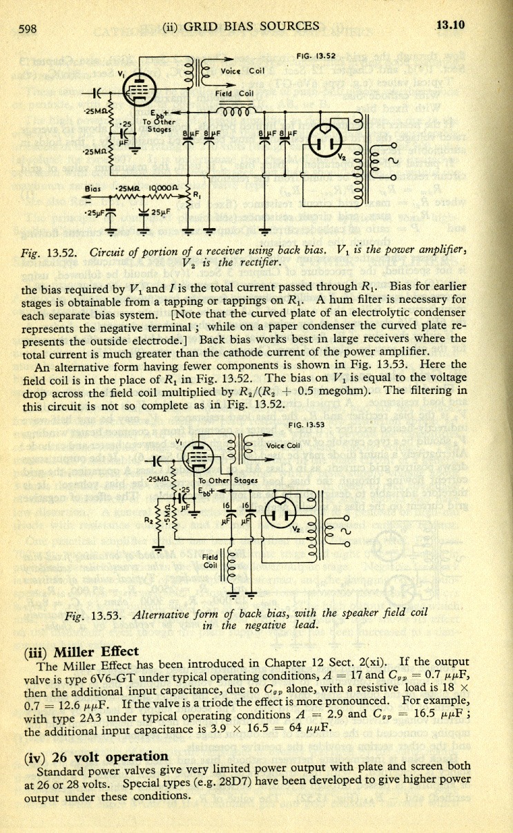

Simply rectifying the existing CT HV winding for negative gets us all the way.That was a very common solution used in 30s & early 40s domestic receivers. It was called back bias
since the negative volts were most often used to bias the output tube, by then usually a pentode.

Is it back bias? The key of the approach I showed was to put the smoothing components on the negative rail, and ground the supply after the second choke. 90V is dropped over the last choke (field coil), and a resistance divider delivers -45V to grid of the 2A3.That was a very common solution used in 30s & early 40s domestic receivers. It was called back bias

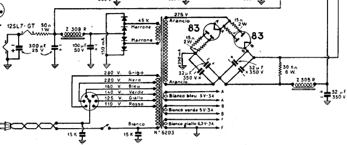

Here is a similar example from a Geloso where the negative bias is extracted from the smoothing for the DC filament supply.

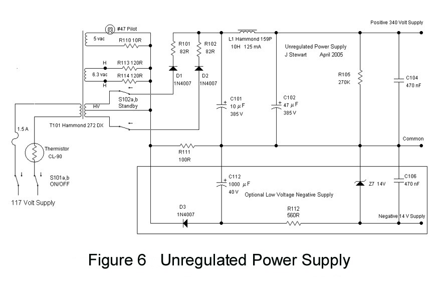

This one uses the negative pulses developed across a 100R resister in the negative return lead of a common CT HV supply.
The resulting pulses are stored in a 1000 microF cap. Then smoothed by 560R & a Zener paralleled with 470 nF.

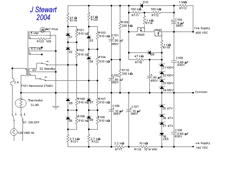

I see now there are different variants of 'back bias'. Some use an AC supply, or one with significant ripple, and a diode to derive a negative supply. The link from JStewart show two variants, using a field coil on the positive or ground, deriving the supply from being elevated from chassis ground.

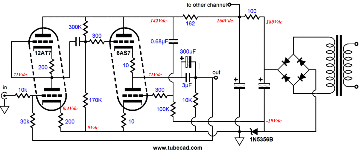

I cant see where -20V comes from in the schematic. I can see where it goes...The bias network is R10, R11, R12 & C3.
That's interesting; 5W would limit the current to 250 mA, pushing the zener to the edge...You can also use a zener go get a negative rail like Broskie shows here.
