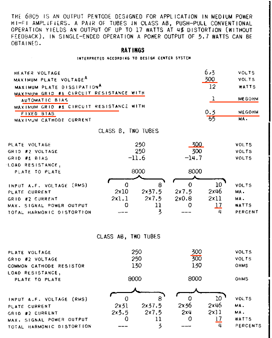

Thanks, uh, if ~350 is too high for the screens, what's a better value that's "way" lower?It’s still past rating to run at 400 volts - but nothing new under the sun there. You would need to drop the screen voltage down - way down - to run safely. That might also fix the run away problems you’ve been experiencing with 6BQ5’s.
The tubes seem to be "content" with their individual 470 Ohm cathode resistors. I wanted to run fixed with the cathodes essentially grounded, which led to the red plate run away on the one tube. Unsure if I dare go back (I could) even after replacing the two grid resistors in that socket.
Cathode bias takes some of the heat off the tube, so generally it’s safer. And any increase in current causes the bias to automatically back off. Maybe some combination bias, where it’s adjustable to balance out unmatched tubes but still drops voltage on a cathode resistor?
IMO 350 is too high a vg2 for any EL84 type. G2 ratings need to be respected, even if you‘re running everything else down a bit. Most tubes will take higher plate than you’re supposed to use if you bring g2 down below its maximum. If you brought it down under 300 they probably wouldn’t red plate at 400V with fixed bias. But it does lower the current capability. Those *86’s I bought to play with will in no way take 350V on G2. But they show a decent amount of plate current at 170 on G2. I was thinking 170/340 volt supply, which is easy to make on a budget, rather than having to dial G2 into something more difficult to make and control. With tubes that are only going to be rising in price.

You don't get any more power within ratings. It's 17 Watts at 4% THD either way. It is 18W at guitar-amp rating, and the major EL84 "18Watt" g-amps run cathode resistors. If they got "louder" in fix-bias, they would... but it doesn't so they don't.
If you treat/beat them like 7189 you get a 24W claim at 400V fix-bias. Leaving aside the question of which new EL84/6BQ5 tubes will survive 7189 abuse (it can happen), the difference 17 vs 22 is not amazing. And the over-bias to make 7189 live a whole day at 400V ensures crossover distortion.

It turns out I had 30 - 40 24V zeners, 0.5 W. I calculated the power dissipation at 25mA; close enough; figuring if I drop the voltage by 50, the current will drop some too. A string of 4 didnt make it past initial turn-on; 3 shorted. Ended up with a 5K resistor, to take the screens to 300V. Now, to fix the voltage level on the input and driver 12AX7s, as they dropped 50 with the screens, being downstream in the power supply B+ scheme.
