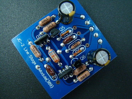

25ma is safe in this case but according to the information I got the original design of the bias current @ the output stage of JC-2 was set at 50ma with 2N4401/4403 transistors for 15v power voltage. Let's wait to see what Mr. John Curl will say about this.

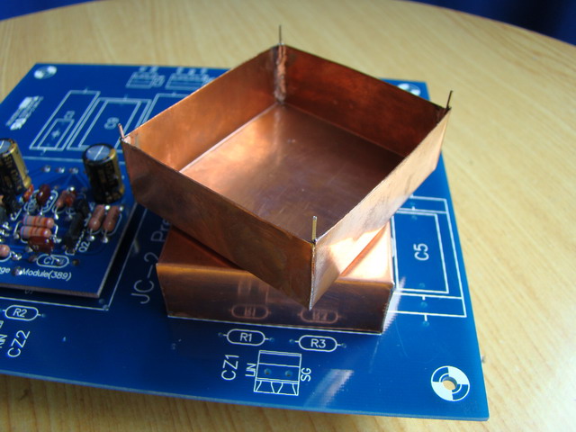

Yes I like this pcb layout very much. It is the board of the amplifier section which I am going to put it onto a small bronze box in size 2" x 1 1/2" x 1. I will post photo once the box is available.

If you return to the beginning of this thread, I recommended a lower operating current for the output devices and made the component changes necessary to accomplish that. I explained my rationale (including the device performance at the lower current) and gave some measurements. Mr. Curl disagreed quite strongly.
If you plan to drive long cables, you may wish to consider alternate output devices and arrange suitable heatsinking. Otherwise, I think reducing the operating current is the way to go.

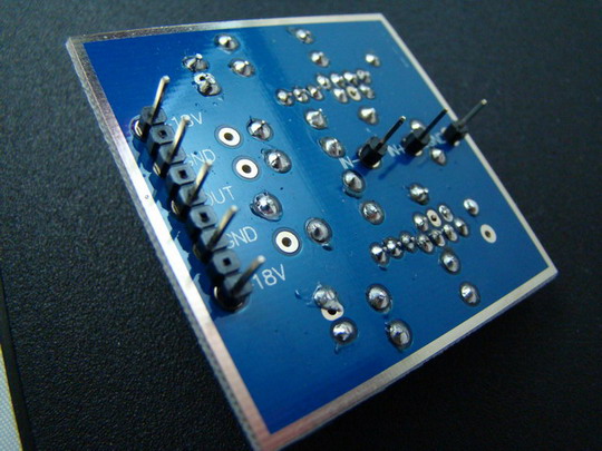

Very nice looking boards!!!

I'm still convinced that the ultimate slew rate will be determined by the load capacitance. If you aren't planning to drive long cables, I don't see what the higher device current provides other than a shorter life for the part. The data sheet also indicates performance advantages at the lower current.
If you plan to drive long cables, then the higher current makes more sense, but with a different or a heatsinked device.

I will do some experiments shortly to change the Emitter resistors at the output stage to 30 & 40 Ohm respectively to reduce the bias current to see if there is any sonic changes. It is hard to found heat sink suitable for TO-92 packaging nowadays. I had seen heat sink for TO-92 before but not any more.

The original line amp for the JC-2 was made for 600 ohm loads and used T0-5 transistors running at 50 ma. The later JC-2 circuits were made for 5K loads and used the 2N4401-3 devices, for example, but others can be used as well. These were enclosed in a thermal epoxy which was a pretty good heat sink. You MUST heat sink the output devices to get best performance. You could run at a somewhat lower current, perhaps 25ma on the outputs.
The parts that I found best were made by RCA and Kertron, both difficult parts to get today. I would recommend a plastic equivalent part pair, today, 40V min breakdown, good Ft, linear beta between 5 and 50ma, power diss. 0.5W min, 2W if you can get it. As I don't use bipolar transistors very often, anymore, I don't have a good recommendation at the moment
I changed the emitter resistors at the output stage from 20 Ohm to 40 Ohm. It seems the low frequency has better control and the sound stage is more stable when the bias current of the amp is set @ 50ma.
I like the sonic quality that the amp reproduces with 50ma bias. I am waiting for Ken to send me some heat sinks.
