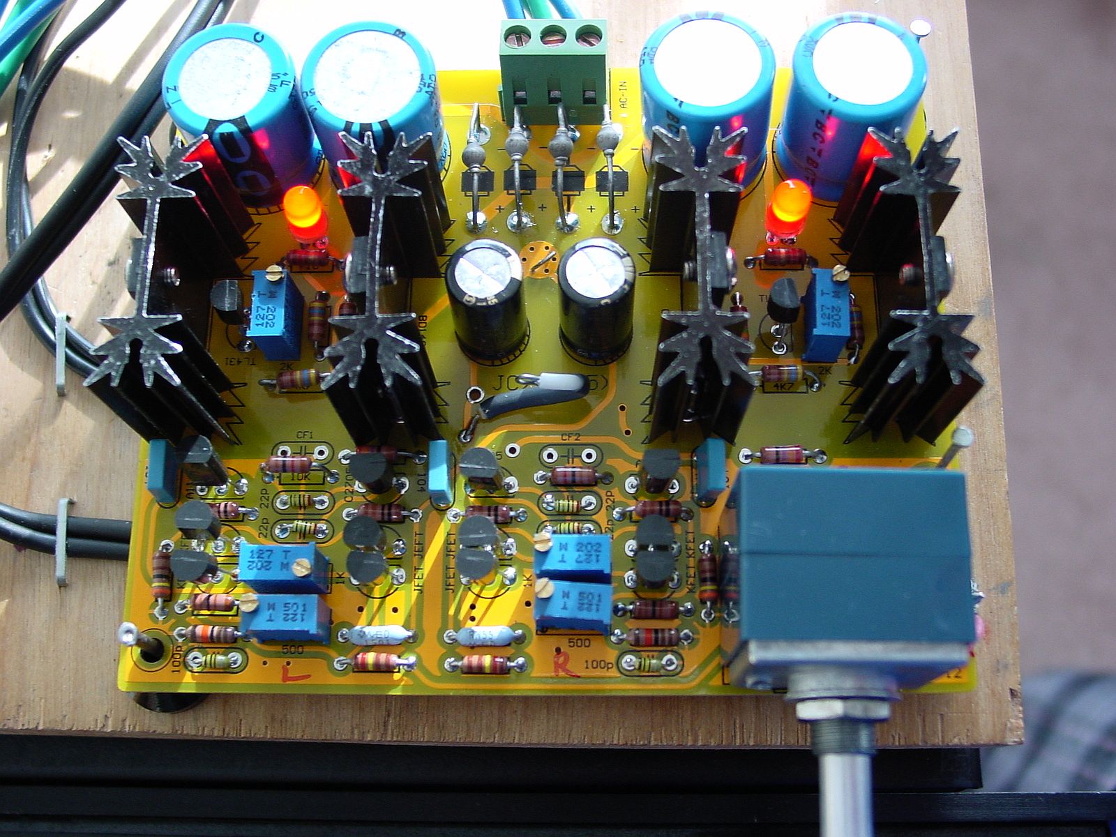

Finished the pre over the weekend. It is great! Started out a tab bright and then settled into a very nice laid back disposition.
Actually loved all those pots and being able to fine tune things. The seller (Jim'saudio) uses other transistors other the KFET/JFET and bias is run higher at 2.5 - 3 volts.
Here is a breadboard pic. Case and other parts are being readied.

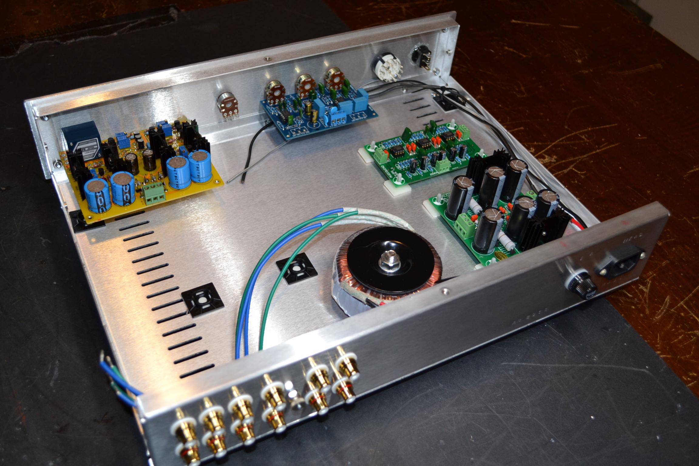

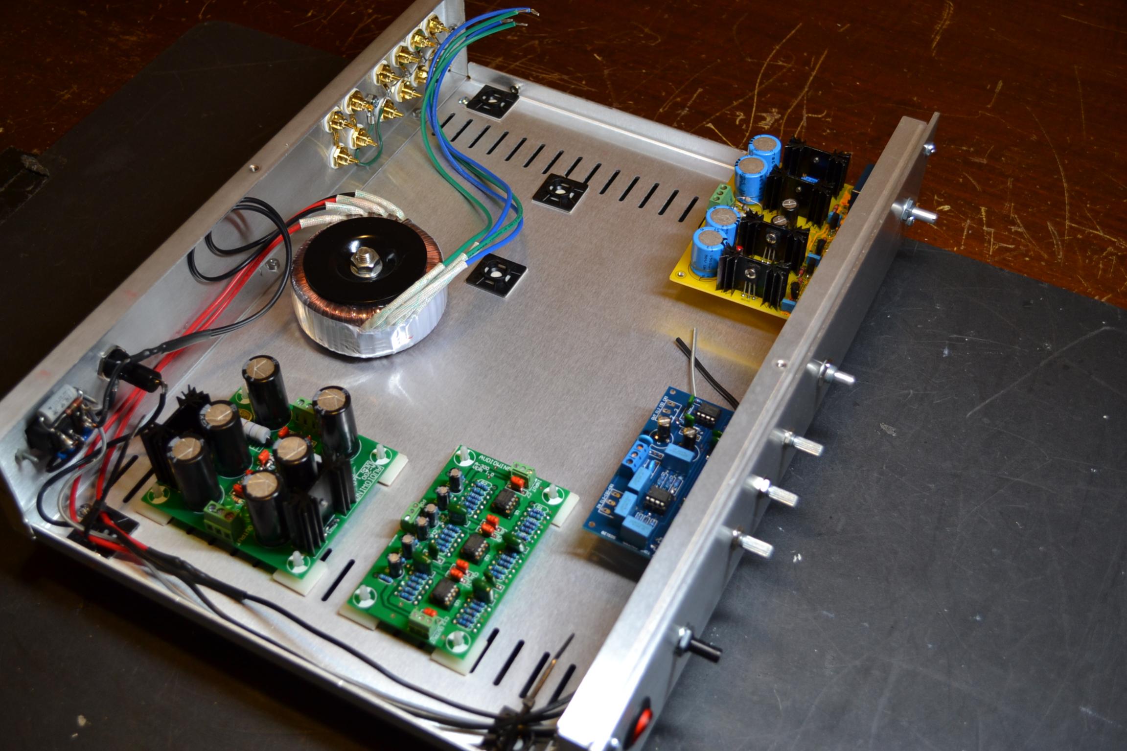

This is the home I am building the JC-2. May need you all's help coupling those stages properly.
That is an Audio Sector three tone board, Audiowind OPA2134 based phono pre and Rubycon cap loaded power conditioning board.

The project is done for all practical purpose. The JC-2 preamp has met and surpassed all expectation. This is the first preamp that I turned on and after a couple of hours burn-in, I really had to tell myself that I was not listening to a several thousand dollar preamp. It lacks nothing!
The tone board is totally unnecessary and adds nothing for line level use--and I got the wrong pots with it, so in the middle of already drilling holes for it, I had to scrap its use. It may be useful for the phono amp.
I highly recommend the JC-2 kit from eBay seller jims_audio. He is very helpful with questions and seems on top of his audio knowledge and aim.
I will post the part numbers for those interested.
