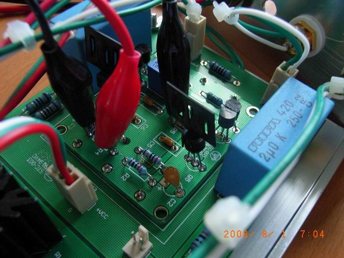

I am building the kit from tubeshunter.
As in the first post is remarked to be carefully about the output transistors orientation, I cared about all FETs and transistors orientation.
Now, I am quit confused, as the output transistors seems to be correct.
But not the FETs in the right channels input.
I am right?
The black lines in the second picture are showing the direct connections between the FETs.
Thanks for support.

2N4401/4403 with heat sinks installed. Thanks Ken for sending me the heat sinks.
Temperature of the transistors 50*C, heat sink temperature 40*C, measured under room temperature 27*C
Bias current at output stage 50ma.
